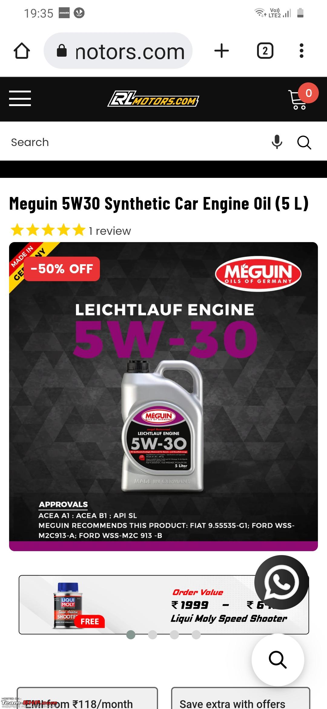

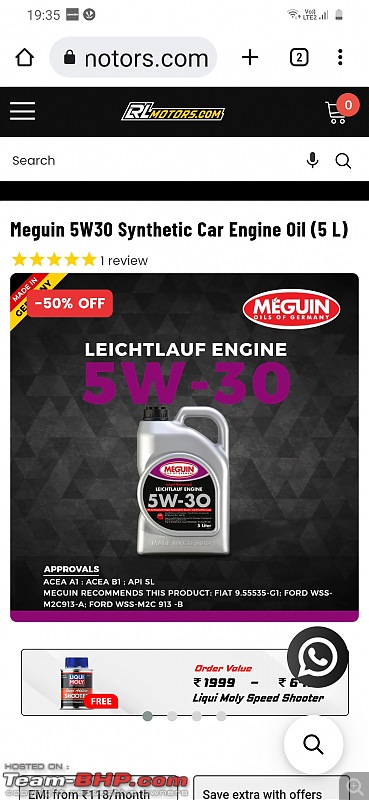

Re: All about diesel engine oils
My Ford Figo 1.4 tdci is due to service. Have run 12k kms with castrol magnatec synthetic oil.
For upcoming oil change have ordered - Meguin 5W30 Synthetic Car Engine Oil (5 L) [https://lrlmotors.com/products/meguin-5w30-5l].
Website says its compatible with figo diesels recommended oil. Hope I have taken the right decision. Any comments on this oil?
Beyond that it is a somewhat old formulation? It complies with the ford spec so it won’t hurt your car. What good it does beyond ford oem oil you will have to try over 10k km and decide for yourself.
