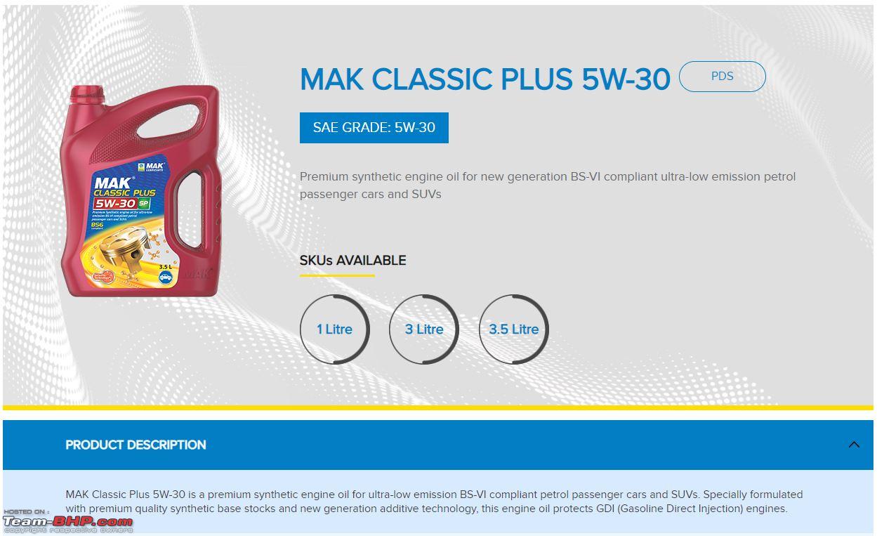

Originally Posted by Cinquecento500 View Post
Update : Ditched toyota oil used at ASC. Wanted to go for fully synthetic from Shell / Castrol, but on a trusted auto parts dealer's insistence, went for Bharat Petroleum MAK CLASSIC PLUS 5W-30 (was a bit hesitant as its from a PSU).
But the product description says it's suitable for petrol cars. Could you clarify if you used the same engine oil for your diesel Innova?
It is an excellent oil and value for money. Servo Futura G+ is also excellent in this range.

Hm. API SP ILSAC GF-6A, my mistake this is petrol only. They had a similarly named oil I confused this with.
As for the fiesta once a year or 10000 km whichever comes first with a good 5w30 a5b5 or a3b4 such as shell hx8 will be fine
