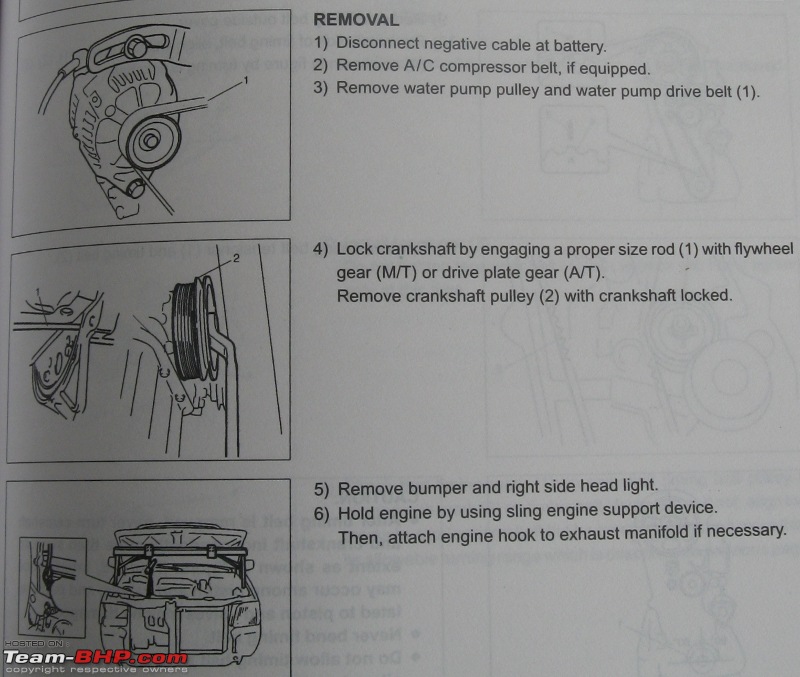

Old 18th November 2011, 19:46   #177
im_srini's Avatar
Location: Portland
Posts: 1,010
Thanked: 491 Times
re: Maruti Alto - Issues
Originally Posted by DeOetelaar View Post
Yes the parts from the service manual would be very helpful. Would be great if you could upload a scan.
Hi DeOetelaar, here's the timing belt change procedure from the service manual...
im_srini is offline   (3) Thanks

Guys,
My parent's Alto makes a screeching sound every time I start the engine. This sound lasts for 3-4 seconds if I start the car after a sufficient amount of time (e.g. first time in the morning), but if I re-start the car while driving, it is much shorter, yet the sound is present.
Planning to take it to a garage tomorrow, but anyone have any idea on this?
ninjatalli is offline
Old 24th November 2011, 20:28   #179
anky's Avatar
Join Date: Apr 2006
Posts: 402
Thanked: 115 Times
Mostly fan belt making the noise cheap fix .
anky is offline
Old 24th November 2011, 20:47   #180
im_srini's Avatar
Location: Portland
Posts: 1,010
Thanked: 491 Times
Hi Ninjatalli, yes, Anky is right. In the case of the Alto the screech is the water-pump & alternator belt (the belt labelled 2 in the last image above). Ensure proper tension of the belt, tightening it is a 2-minute job, any garage should be able to do it.
im_srini is offline
