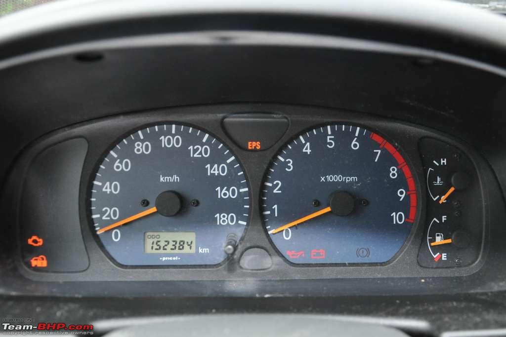

Here is a picture from the speedometer area of my european Alto which I have attached. I guess it looks similar to the indian. But if you need something else let me know.

Hi thank for ur pic .My speedo is much the same but no engine immobiliser and eps light as my car had no immobiliser as std . (Alto lxi 2004). Also the new altos have the eps light coming on now not in mine.In any case i have fitted the wagon R speedo with tacho to my car instead of the altos original (for lxi) only speedo design .Only the kms do not get carried over with the new speedo being fitted with 0kms).
Hi anky,
Sorry I forgot to admit that mine is also a early 2004. Does my Alto really have a immobiliser? I canīt believe that anybody would be interested to steal this car here in Germany.... What do you mean with "speedo with tacho" and "only speedo design"?Do you mean that you installed a speedo with rev counter as mine Alto has? Mine is a "Club" edition. The "Classic" does only have a speedo I remember.

There are two instrumentation panel designs, at least in the Indian Alto
- One with Speedometer and Tachometer (revolution counter)
- One with Speedometer without Tachometer
Even the Alto K10 has these variations, Vxi with Tachometer and Lxi without.

This is the same unit fitted on the Indian Alto Vx 1.1 and Vxi. This was also OE in certain models of Wagon R Vx. No wonder that this looks similar to European Alto because it is made by an Indian company, Pricol, short for Premier Instruments and Control based in Coimbatore.
