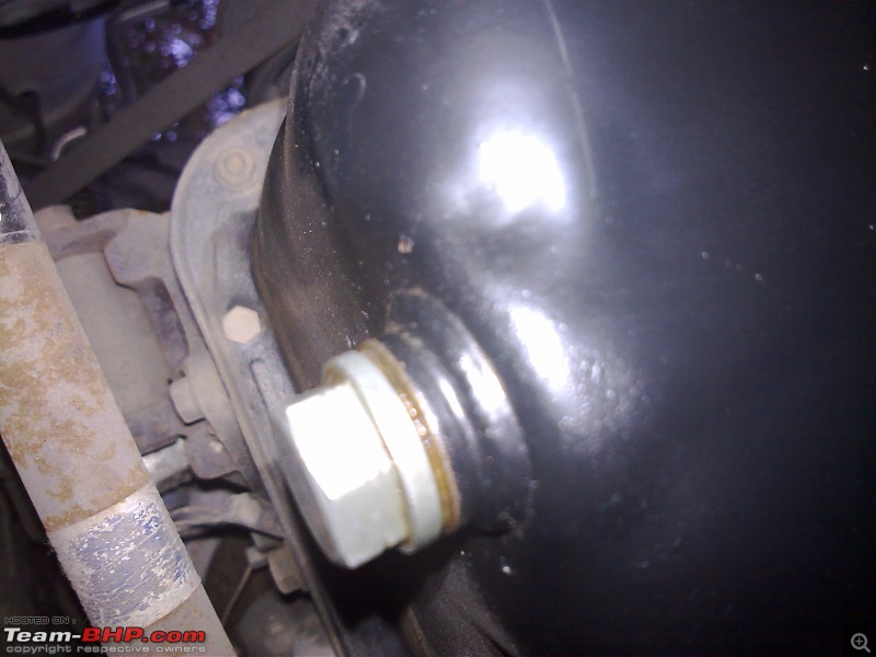

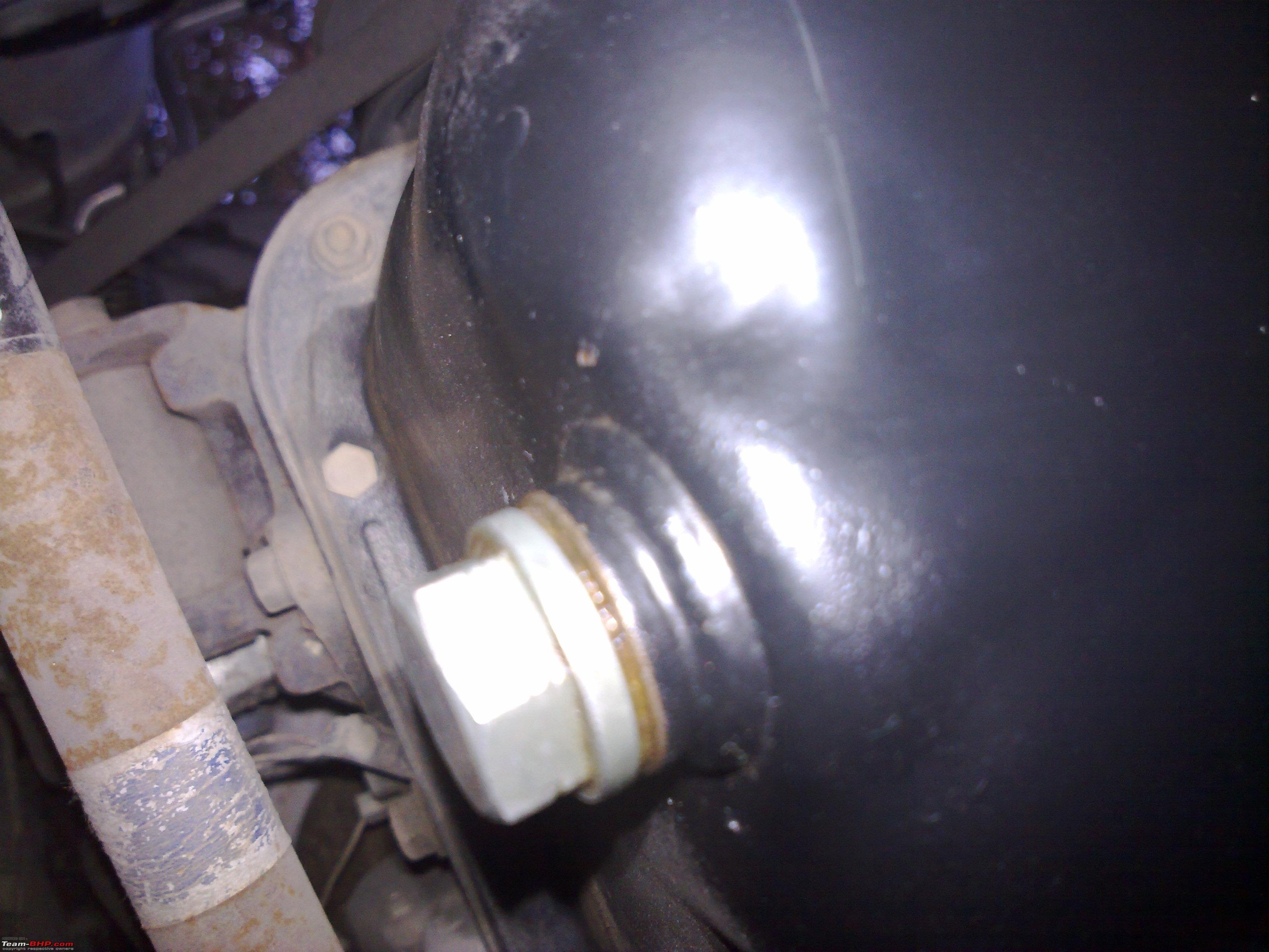

@all
I cleaned up the sump area with soap water. I have cleaned it up to the best of my reach(car was not jacked up). Here are the pics.

As the drain hole is at the bottom and not protected, it can be damaged if a large object hits it - brush against a boulder, or the edge of a crater. Once hit at an oblique angle the drain plug can deform the hole slightly to induce a leak.
This can also be the reason, once you changed to synthetic oil
In my opinion synthetic oil is an overkill for normal use, unless you are running at high revs constantly, or traveling in regions of extreme cold/heat. Secondly most of the synthetic oils have the same service interval as mineral oil.
Now, that you mention it, I found slight oil stains on the valve door gasket, right under the oil filler cap where it was written 12VALVE. The oil had seeped from the gasket to outside and was doing so gradually. This was after my first synthetic oil change at 6K kms & 1yr of ownership. I was prepared for leakage after reading about synthetic oil's characteristics on old engines (the 800cc motor is almost 2 decades old).The seepage was slow to moderate at first, but it subsided later on & never reappeared.
Delhi has climatic extremes,so, I thought synthetic made more sense & also, I was getting better engine response.
I will change to Castrol Magnatec or equivalent semi synth at my next oil change, just to see if the seepage stops.

The "old" in this context really means old - en engine with lots of KM on the odo, not a new engine but of older generation! The slight stain you observed can happen when they spill a little oil on the sides of the neck while filling.
The leak from the drain nut area can happen only a) if the washer is damaged / missing, b) if they have cross threaded the drain nut while tightening and c) if there was a hit in that area while driving.

I meant Engines which were of the mineral oil era. These F8 series engines were originally meant for mineral oil & at most, semi synthetic. I read it online on a reputed website that:
1) If Kms wise old engine, previously running on mineral oil is made to run on synthetic, the issue of oil leak crops up.
2) If an engine utilizing old technology is made to run on modern synthetic oil, there is a good chance of oil leaking.
3) If mineral & synthetic oil are mixed. For eg. If synthetic oil in an engine is topped up with regular mineral oil, it leads to oil leak & some gasket issues.
As you can see from pics, there has been no external hit on the sump area. The marks on the nut are tool marks caused by the mechanic. So, it is either the gasket or the sump threads itself.
