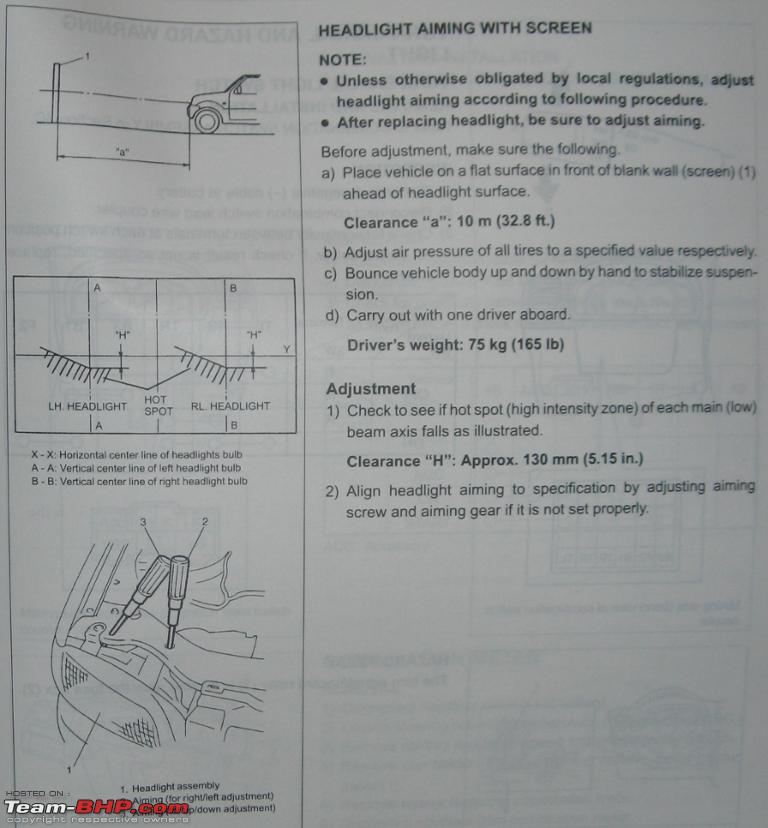

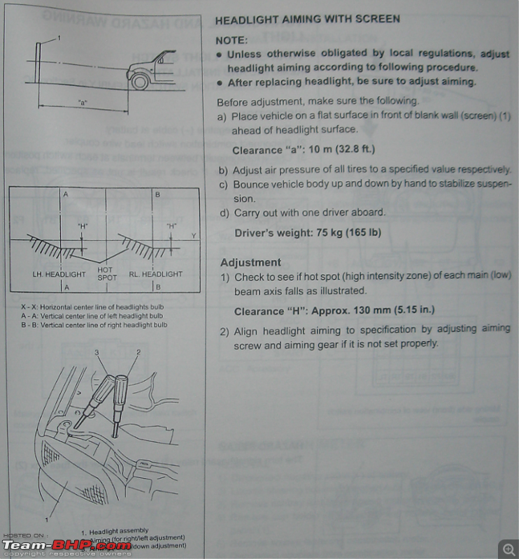

After crashing the front of my alto, the headlights have become mis-Aligned. Can anyone guide me on how to adjust the focus of the headlights?
The headlight assembly will be mounted on three screws, which are also used for minor alignment. If the headlights are out by a large amount, you may have to go to a denter and get the base where the lights are mounted aligned.
To check alignment -
- Park the car on a flat surface with front touching a wall.
- Switch the main beam on and mark the light centre on the wall for both the beams
- Reverse the car some 3 meters from the wall.
- Check the beam centre on the wall
- Adjust till the centre hits the marks
- If possible reverse further and check where the beam hits the wall. If the surface is flat then you should hit the same spot
Alternatively go to a straight lonely road when it is dusty. Switch the high beams on, their trajectory will be visible in the dusty environment. Adjust the beams till you get them parallel to the ground. Sit in the car and check how much they depress. If necessary adjust the beams upwards to compensate for the dip.

Originally Posted by KkVaidya View Post
After crashing the front of my alto, the headlights have become misaligned.
Hope this helps...
The headlight itself:
Aiming procedure:
