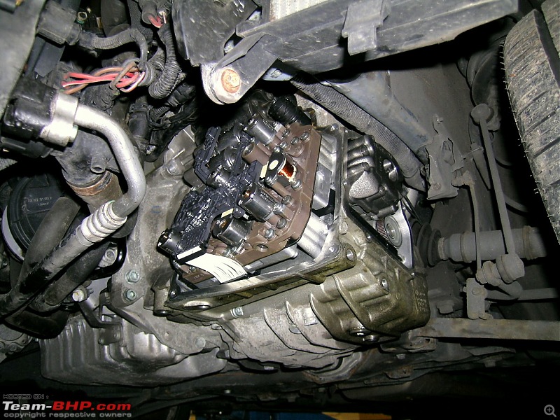

A bit of googling revealed that this is a problematic area not only for Skodas, but also VWs and Audis which sport a DSG.
V-16, hope the problem is solved and the Superb hits the road soon.
Here's a pic of the mechatronic module.

What a place to put all the electronics, no wonder they fail in the heat! It has wire connectors dipped in oil!
I ve seen and worked on far more sensors dipped in oil and heat on HEMM machinery.
They are made to be there and withstand the conditions. It is, as it appears now, a universal problem with the DSG.
V-16, Hope Skoda fix this under warranty and FoC. What surprises me is their lack of ability to diagnose the Mechatronic failure even using their laptops plugged in. Heck, I was so smitten by the DSG, and now...this...
OT: The Mechatronic(the word is used for any piece of machinery/work that combines mechanicals with electronics), going by its placement and appearance is the brain of the dual clutches and triggers the gear changes based on various inputs to it.
