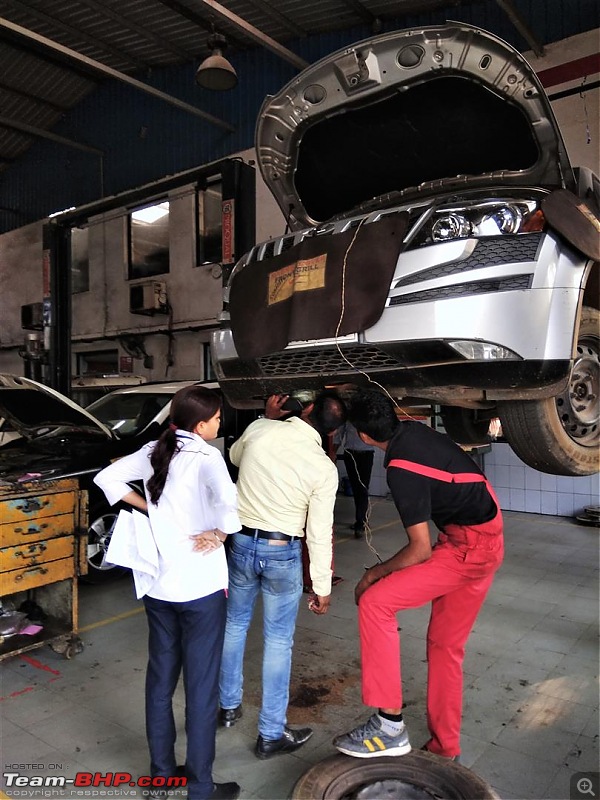

A faint abnormal noise (khat-khat) was coming from the front suspension while going over potholes and I decided to get the complete suspension system (front and rear) fully overhauled as I like my car to be in perfect condition always.
The work was carried out at Royal Motors, Kolkata (M&M Service Center) over a period of two days. The complete suspension system was dismantled and all parts showing any sign of wear or tear were changed. Some parts (like shock absorbers) were covered under extended warranty but I had to pay for other parts (having rubber components) such as bushes, ball joints and kits.
My total bill came to Rs 7,500 (parts - Rs 4,600; labour - Rs 1,400; machine shop charges - Rs 1,500). I do not know the cost for the parts that were covered under warranty.
After the overhaul the abnormal noise was gone and the suspension felt like brand new.
