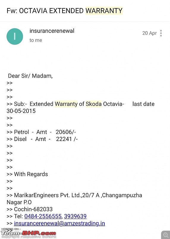

Review: Skoda Octavia (3rd-gen)-image.jpg
Is there a last date for getting the extended warranty or is Marikar trying to scam its customers?
I just called them up and they said they received a circular which says the warranty can be extended till May end.
Can any of you please verify this from a different dealer? Thanks in advance.
