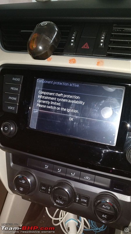

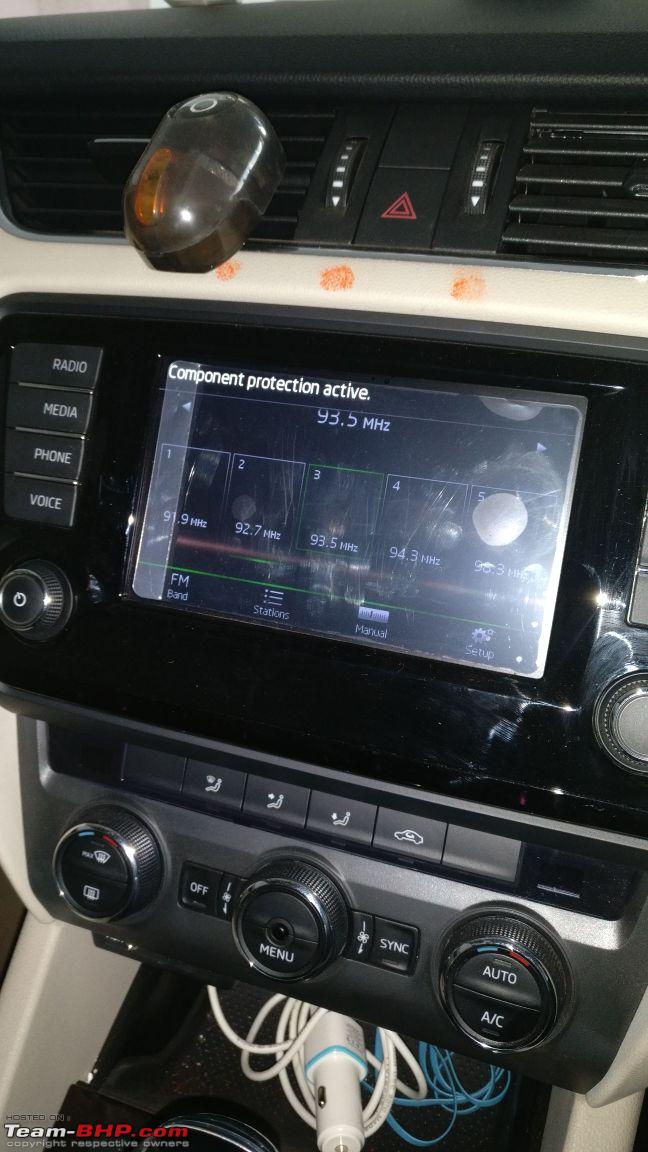

I am suddenly facing this weird issue with my Octavia Style Plus 1.8 TSI.
Whenever, i switch on the car, i get this error in my HU of "Component Theft Protection".
Even after ignition, the error doesn't go away, and has locked the working of the HU, including the rear parking sensors and camera, extremely essential for our parking use.
Have contacted the service rep of the car, and sent him the issue and similar pictures. He said, that the issue has been raised with Skoda, but no response has been received yet.
PS : I do not think, the car was subject to any theft activity, as it was minimally used in the past week, when the error occured.
Request the able guidance and assistance of all. Thanks in advance.

Any chance of rats or other pests damaging any wires? Is the battery in perfect condition?
Asking as the car was unused for a week.
So, what happened today was that, the entire car stopped functioning i.e. doors won't open, and when opened through manual key, it showed no signs of life. Opened the bonnet next to find small rat droppings around the engine area (as informed by my driverji). Immediately called roadside assistance, and the car has been taken to the workshop for correction. Will update on the issue for future benefit.
So, I guess, this is a rodent problem, but it shall be the first of its kind in our building. Is there any anti-rodent treatment for Skoda available? I guess Maruti has something similar. Or will an underbody protection suffice for minimizing further damage.
EDIT : Turns out it was a rodent issue. A couple of the wires had been cut, which have been replaced at the Skoda Service Centre. Car running in ever-so-fresh condition again. I am overall satisfied with the level of response by the Skoda people until now.
Had you or perhaps any kid pressed several buttons on the HU together? There is one such feature in probably most of the modern car's these days, Which disables (Blocks) the HU once the car leaves the factory and then is again unlocked when it reaches the service centre before being delivered to the customer, AFAIK its a small glitch and should be fixed promptly, Why don't you down the car to the service centre?
