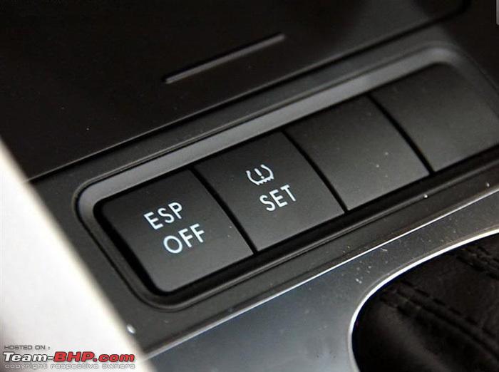

That is a cool VCDS mod
The Octavia has this TPMS menu as part of the head unit which is very convenient. In cars that do not have the system settings integrated into the head unit (for example, Jetta), a separate TPMS switch near the gear box console has to be used to set and clear the TPMS system (The TP switch on the head unit is not related to TPMS). Image below shows this switch next to the ESP OFF switch
Review: Skoda Octavia (3rd-gen)-tpms-switch.jpg
Image courtesy: Google search
I have been thinking of enabling this in my Jetta (for that I need to get a VCDS cable first ), but this would involve installing the TPMS switch and routing the wire from the TPMS switch to the ABS module in the engine bay. This wiring part is keeping me away from attempting this mod. Another option is to enable TPMS, and when the car throws a TPMS error, clear it using the VCDS cable.
