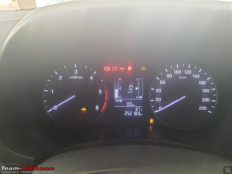

252k up in Creta 1.6, no issues, no complaints, total satisfaction.
An Alcazar joined to share the duties 3 weeks back so this one gets home duties now.

Originally Posted by sids1811 View Post
[i]252k up in Creta 1.6, no issues, no complaints, total satisfaction.
Attachment 2328642
That's quite an epic number! Congratulations, as a guy who owns a 2.5 years old 1.4 Creta it feels nice to see the numbers it can do. I've already touched 105k kms in this time so really appreciate the 200k kms plus posts. Can you please confirm when was the timing belt kit changed? Any major expenses incurred. Also when was the clutch plate kit changed? I know the 1.4 is mechanically quite different from the 1.6 b but still any info is most welcome. Thanks.

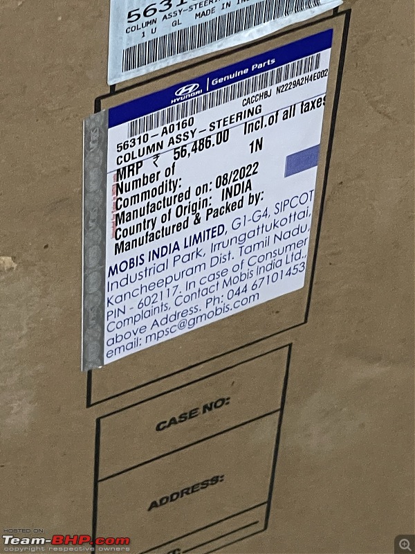

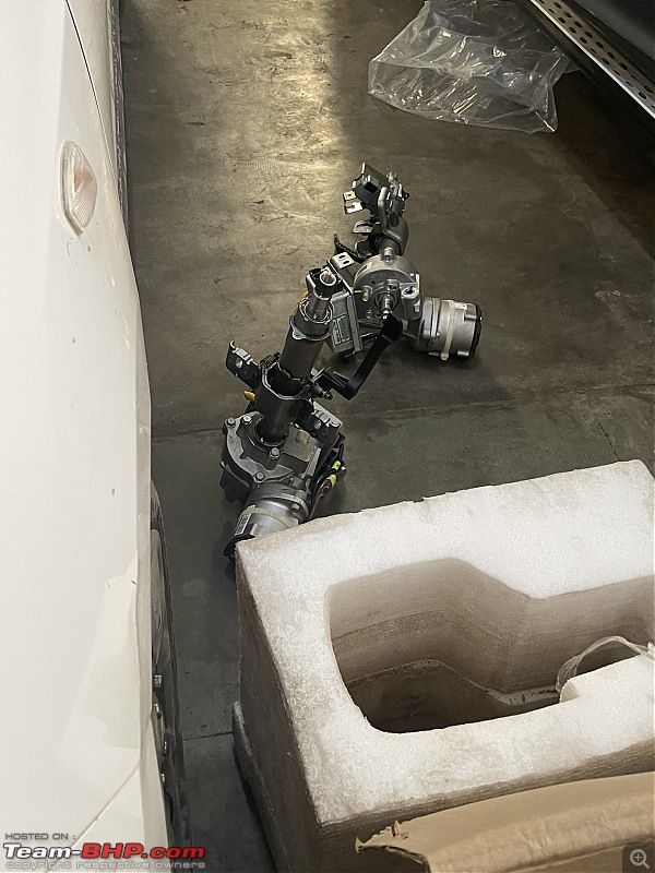

Hi Guys,
It’s been a long time since I’ve been active here, I just wanted to post a quick update.
The steering column issues crept in one again and the same old kat-kat noise started to pester the enthusiast in me.
Took the car for servicing a month back and discussed it with my SA at Mahadev Hyundai, Faridabad about the recurring problem. He was the one who got the column replaced under warranty 2 years back and since my warranty was expired, he told me that he will try to get it changed under goodwill by writing a mail to Hyundai India about the problem which has been in my car since the start.
He dropped and email and after 3 days he called me up and told me that the part has been approved and will be replaced free of cost by Hyundai.
He called me up a day before yesterday and told me that the part has arrived and I can bring the car the next day to get it replaced, which I promptly did and the problem is now finally gone, fingers crossed and I’m really happy to be driving my car without that noise.
Attaching a few pictures, sorry for the resolution of the said pictures.
