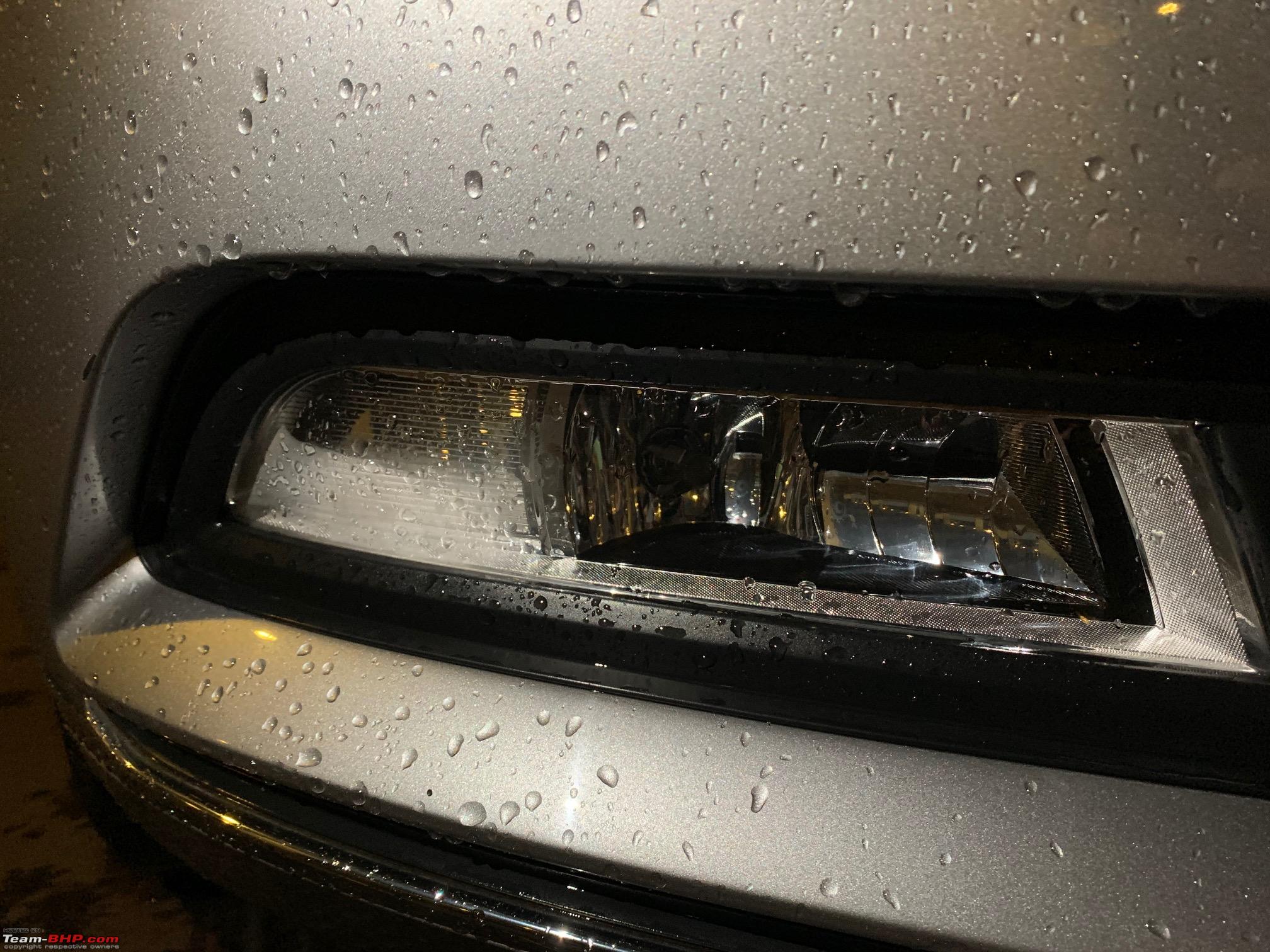

Hi,
I've encountered the same issue on my car as well. Sadly, it has popped up on both the head-lights as well as fog-lights. My car is a Dec-2018 model and has never had any of the lights damaged / changed.
This problem only pops up when the car is driven in the rain, and it goes away in a few hours when the car is parked back in my basement. However, I did not notice this problem during the previous (2019) monsoon.
Wonder what is causing this, since it didn't occur under similar usage conditions previously.
@srgntpepper - What did the technicians at the VW workshop say to justify this as normal?
Driven: Volkswagen Passat-img_9748.jpg
Driven: Volkswagen Passat-img_9750.jpg
Driven: Volkswagen Passat-img_9751.jpg
Driven: Volkswagen Passat-img_9752.jpg
fordfreak is offline   (1) Thanks

It's happening due to the temperature variation inside the capsule and outside it. If this fogging clears in a couple of hours then it's fine if not then it's of concern and you should get it checked

Welcome to a permanent VW feature in India ( Monsoon areas for sure). You will learn to live with it.

Yes. They said it's normal and to be expected. The basic funda being the lamps aren't airtight for cooling purposes. Once humid air goes in, and then cools down, condensation is going to happen. They even sent me an official looking vw video saying so. It was sent on wa, let me see if I can find it.
Haven't encountered the problem this year. So while I'd have it checked and the issue put on record for warranty reasons. I wouldn't worry.
The car has been out in heavy rains last 15 hours in Lonavla. Attaching pics.
