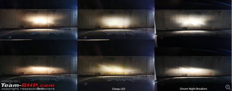

So how do they fare?
When we were allowed to take our steads out within the district, I had a chance to try the LEDs in lit, poorly lit and unlit roads. And I switched to the Night Breakers because the LEDs were not any good. Here is a comparison -
Taste of Freedom | My Mahindra Thar LX Diesel AT | 50,000 km Update (Page 15)-03-let-there-light.jpg
The LEDs were scattering light in low beam, and the cut-off was not as defined as it is in either of the halogens. The low beams of Night Breakers definitely looks closer to 4300K, and the high beams definitely warmer.
So what next? I will now experiment with LED, but then I do not want to order stuff online only to find the low beam scattering light, or not having the desired intensity.
