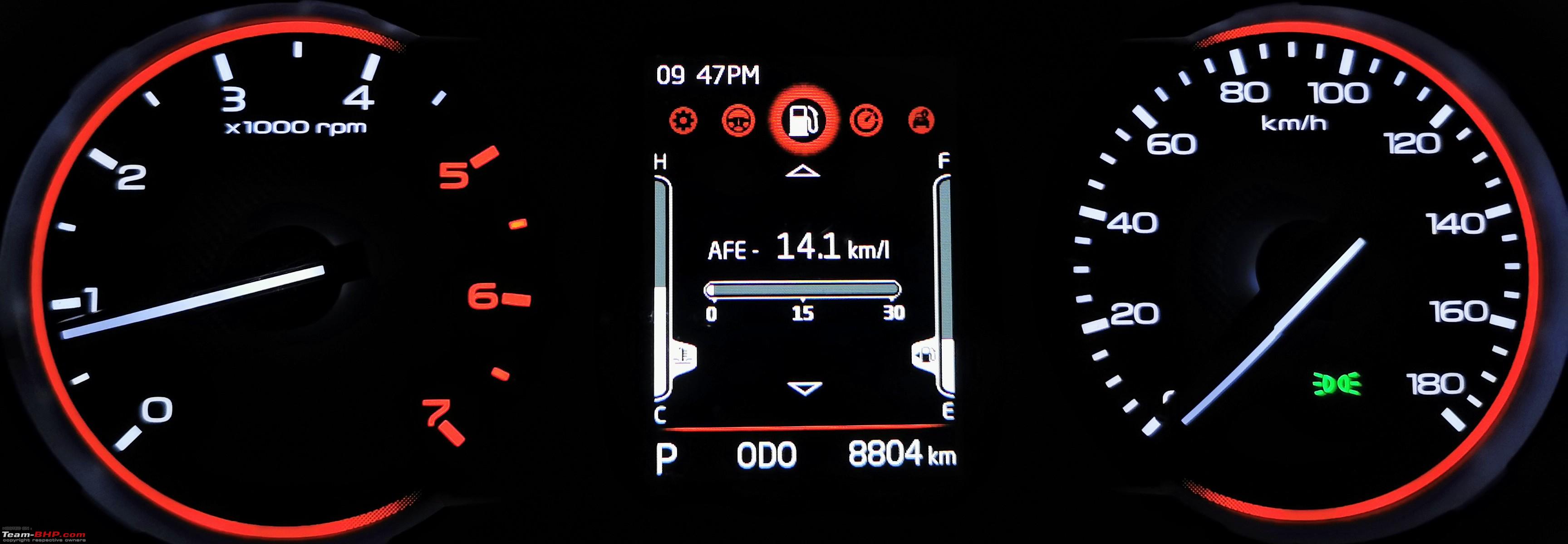

I clocked 8,800 KM with my Thar on 21st Feb - 93 days after taking delivery. I did the CJB-MAA round-trip thrice (~3000 KM), and CJB-HYD (~2000 KM), CJB - Kanyakumari (~900 KM), and CJB - TRZ (~500 KM) round-trips once - and then there is my short shunt to Valparai. Rest were all puttering around the town, including my day out off-roading. My mileage across all these munching has been 11.53 KMPL - mind you, mine is a Diesel Automatic.
Considering the clicks my clock has clicked with my Thar, I think I am now eligible to post an addendum to my likes, dislikes, and observations.
Taste of Freedom | My Mahindra Thar LX Diesel AT | 50,000 km Update (Page 15)-img_20210228_2147182.jpg

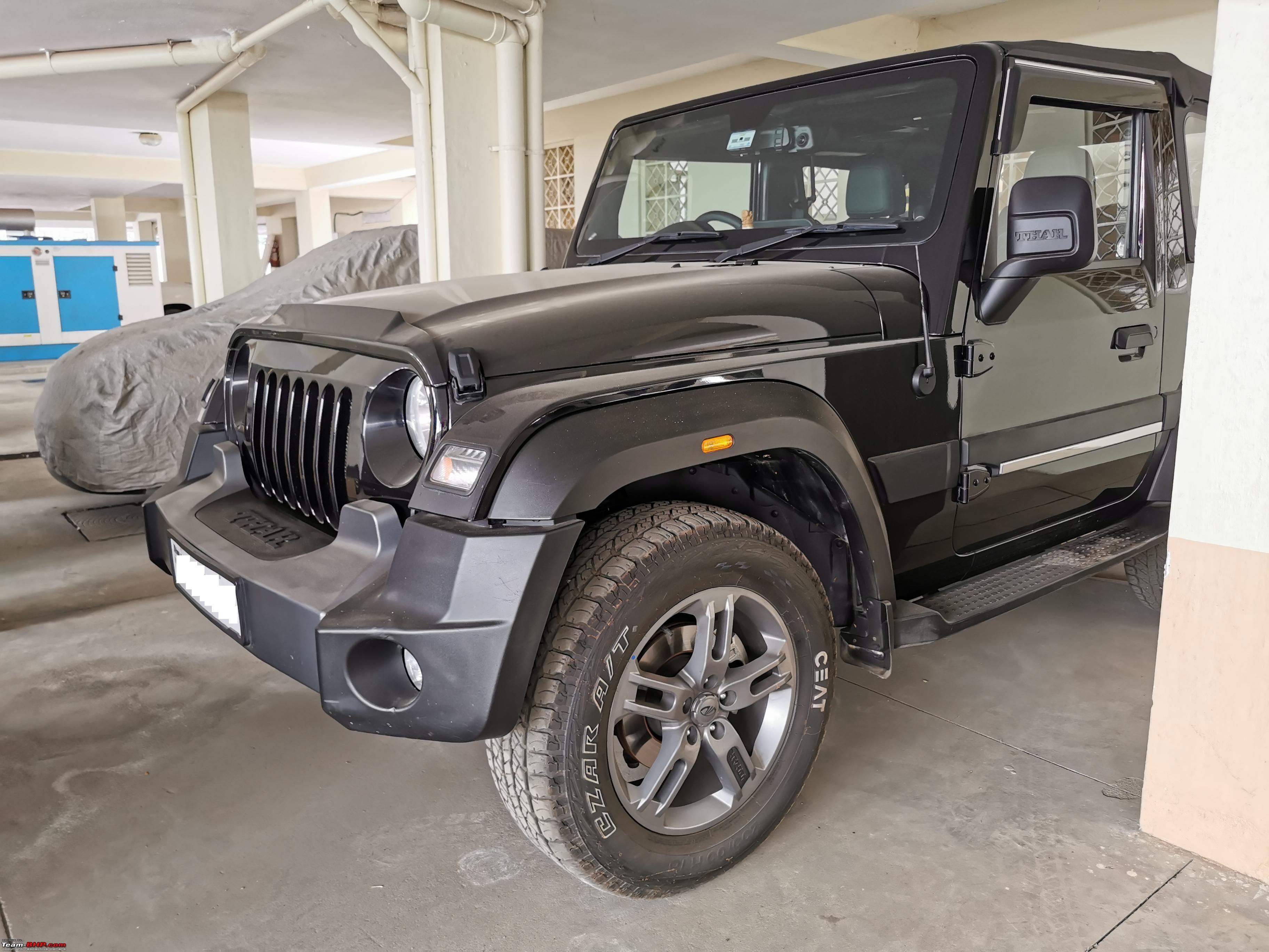

Didn't I tell you about the looks - with the convertible soft top removed completely?!!
Taste of Freedom | My Mahindra Thar LX Diesel AT | 50,000 km Update (Page 15)-1.jpg

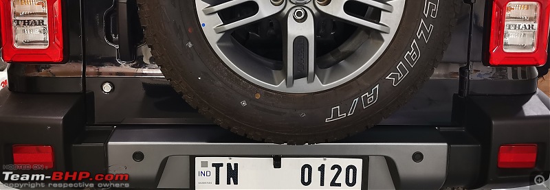

The rear cam got placed right above the registration plate - while this is the most logical position, it is also kind of low. And because this cam will also be an always-on rear-view mirror, driving at night is an irritant, with all the headlight glares - not they dont hurt the eyes, coz there is no reflection - but it is a video of a bright light playing diagonally above your left eye!
The rear cam..
Taste of Freedom | My Mahindra Thar LX Diesel AT | 50,000 km Update (Page 15)-02-rear-cam.jpg

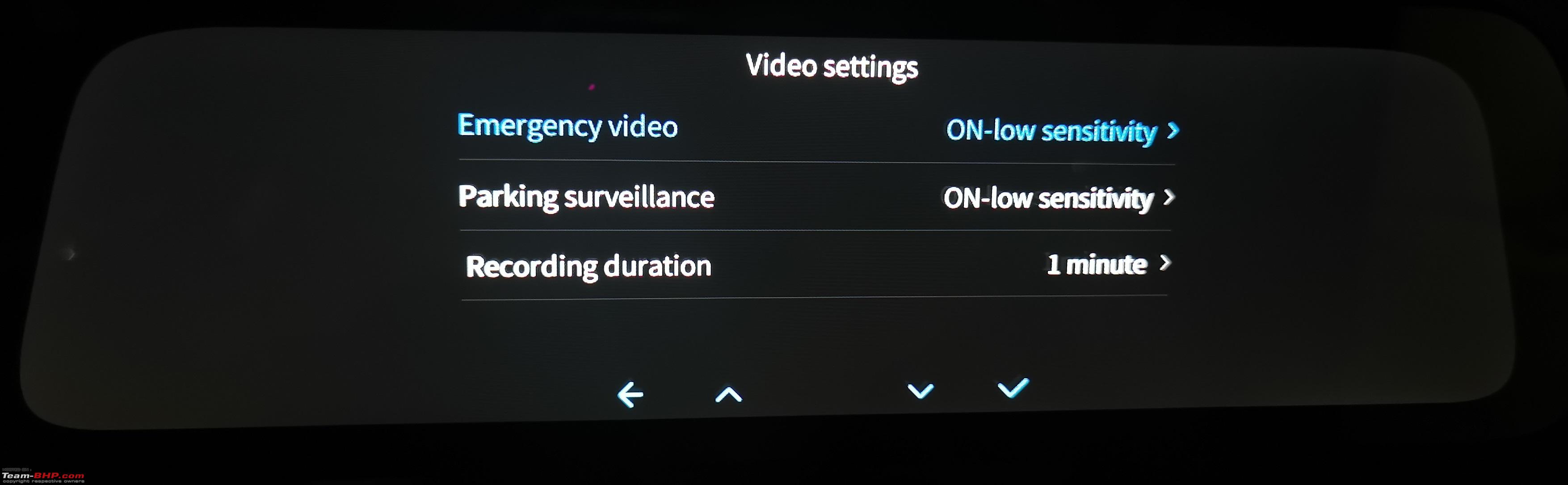

I hardwired it to get the parking surveillance option in the settings
Taste of Freedom | My Mahindra Thar LX Diesel AT | 50,000 km Update (Page 15)-04-parking-surveillance.jpg
The emergency video is one where the cam records and locks the clip if it detected a sudden deceleration/ shock. This happens quite a lot in our cities - if not for someone testing your brakes, it will be that crater dug in the road that you off-road in! You will have to keep a check on how many such videos it locks assuming you got into a crash, as these will occupy space unless deleted. I record 1 minute videos because when they get overwritten (when space runs out), I don't lose a 3 min (for example) video in case I needed the oldest one for something.
Speaking of space, each of the cameras will record in series of minute-long videos in separate folders, and each such video will be 100 MB - so you will need 200 MB per minute. The 64GB card that I have in the cam stores an approx 5.5 hours of recordings, and I haven't experimented (yet) with a 128 GB card (though the specs say the max is 64 GB - what's wrong in trying, eh?!)

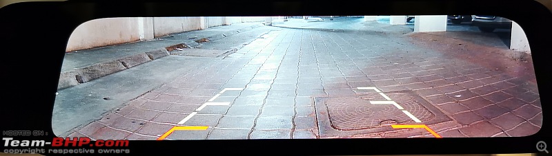

And this is what happens when you engage the reverse gear -
Taste of Freedom | My Mahindra Thar LX Diesel AT | 50,000 km Update (Page 15)-10-reverse-rear.jpg
You will have to tap the reverse light (I tapped the rear-right reversing light) for the reversing mode to get enabled. Use something like this to be safe.
