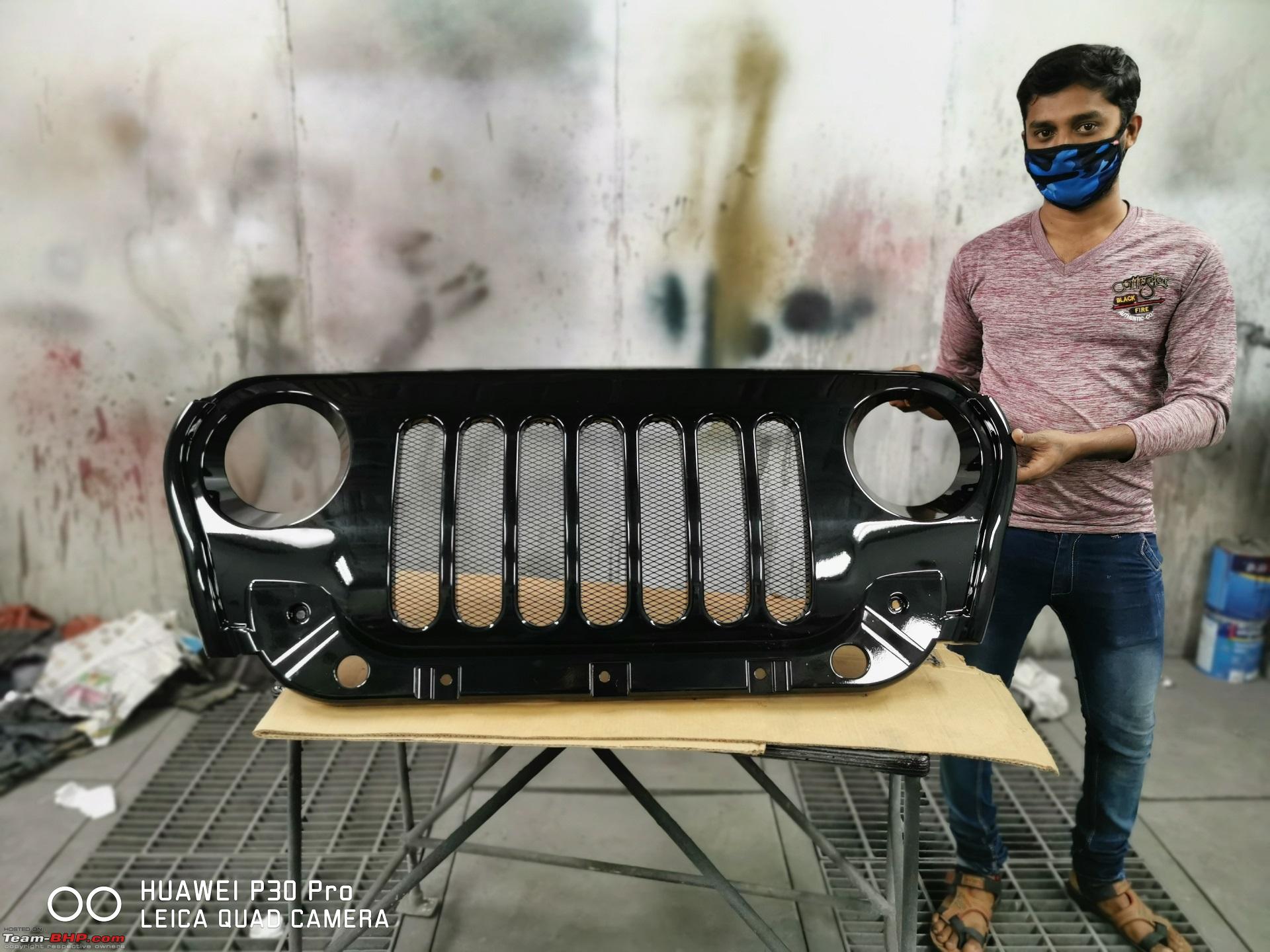

[center]The finished grill. The one holding it is Sarath from Sun Combine - he's done a good job with the finish and affixing the mesh.
Attachment 2093290
Customary "Before" shot.
Attachment 2093897
How about an "After" shot? Or did I miss it?
Edit: Never mind, I spotted it in one of the previous posts. Looks cool.
Where is it? I found one with a really steep and awkward angle, is that the one or I missed something too.
Edit: Ok. I see the problem. The link takes you to installation post which does NOT have a good "after" shot and you naturally scroll down thinking its the first post in the thread. It's not! The after shot is actually somewhere up above :/

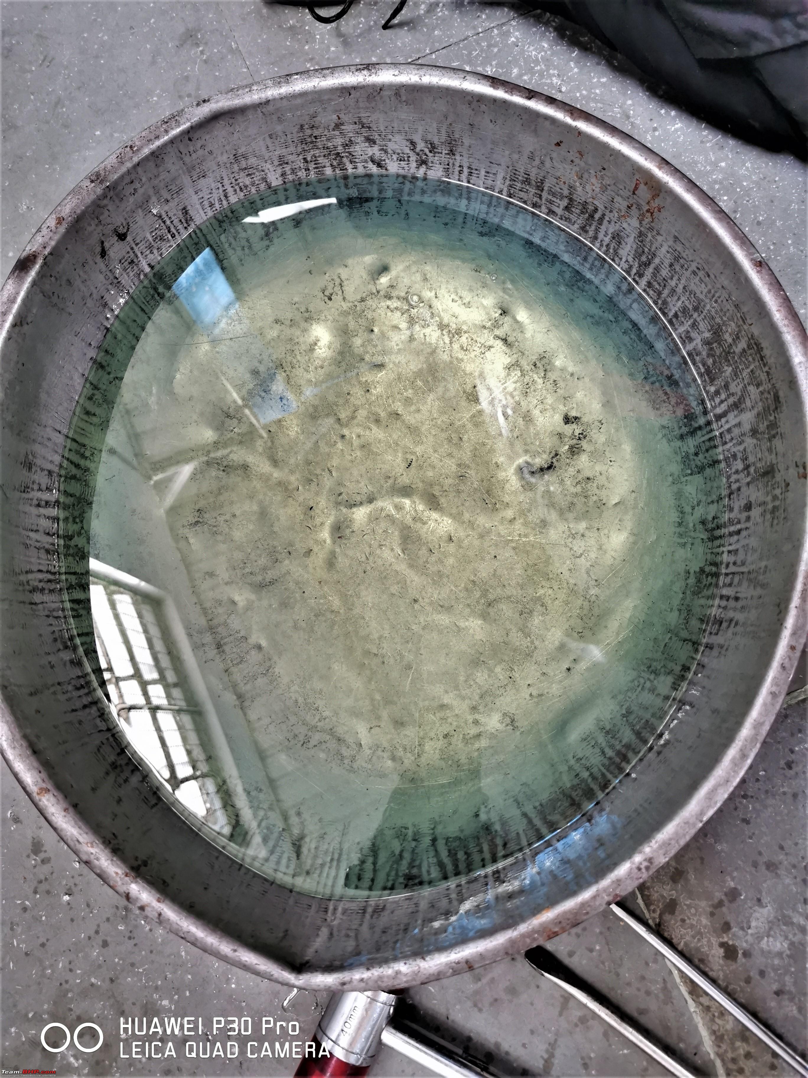

With that out of the way, the next elimination was the Diesel in the tank. I was prepared, and was sure I'd have only 5 to 10 liters in the tank (did not refill after reaching Coimbatore). And here goes - the tank being dismounted
Taste of Freedom | My Mahindra Thar LX Diesel AT | 50,000 km Update (Page 15)-03-diesel-tank.jpg
Taste of Freedom | My Mahindra Thar LX Diesel AT | 50,000 km Update (Page 15)-04-diesel-tank.jpg
If you have a sharp eye, you will notice two dates on the Diesel tank - one in August and one in October. Looks like the tank and the chassis (see my post on the grill mod) were manufactured in August itself, but the actually assembly happened only in end of October. Wonder why, which component caused this delay?!
This is all of it, the entire tank emptied - No, no water here. Not even dust or similar impurity. My apologies, Mr. Ambani, for doubting your fuel's purity!
Taste of Freedom | My Mahindra Thar LX Diesel AT | 50,000 km Update (Page 15)-05-no-no-water-here.jpg

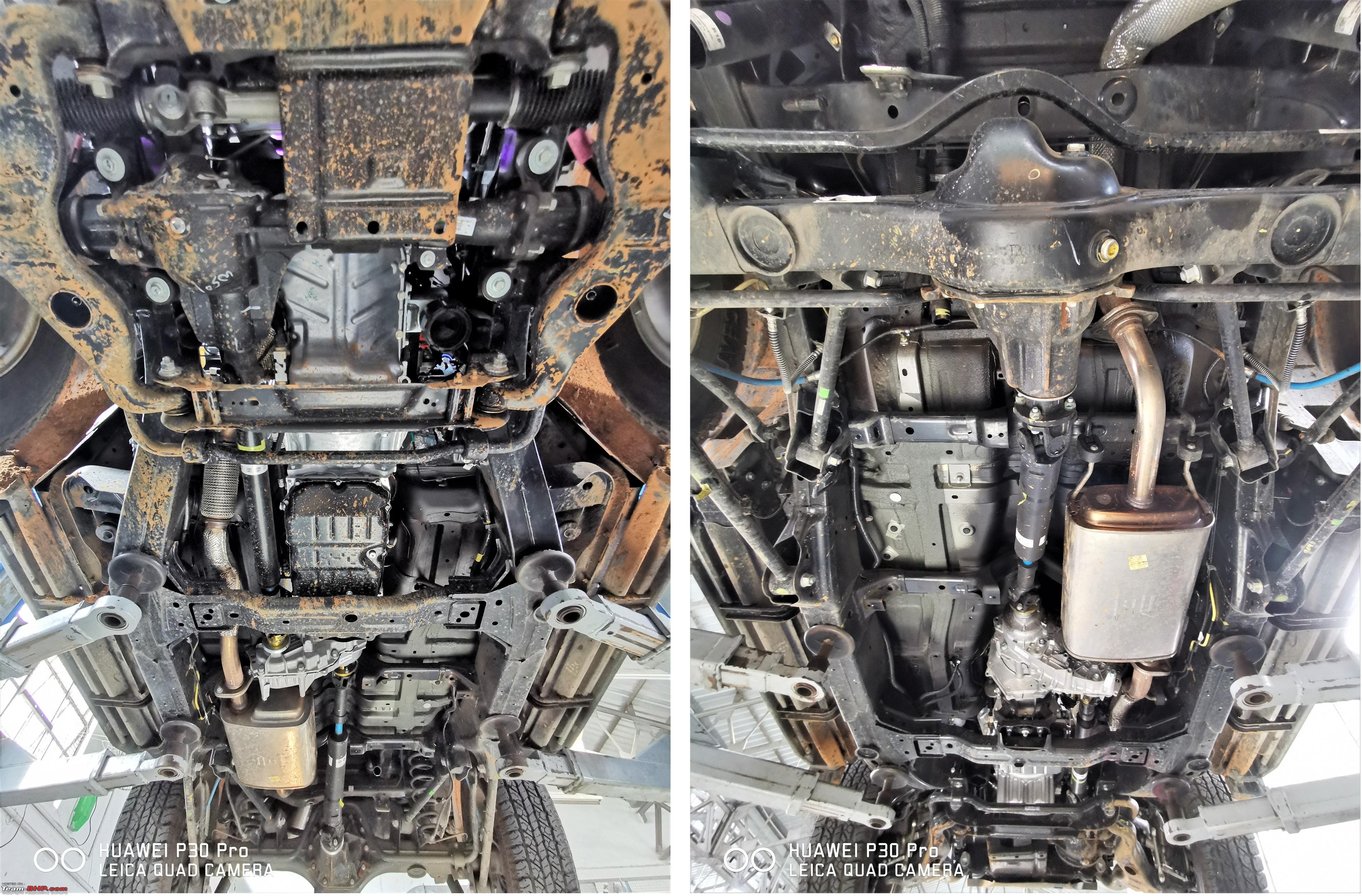

Now, in case anyone is interested, here is a underbody view - from the rear axle as well as the front. Note that the Diesel tank was not mounted back when I took these...
Taste of Freedom | My Mahindra Thar LX Diesel AT | 50,000 km Update (Page 15)-06-underbody-front-view-back-view.jpg
My bad fellas! Didn't know my 7-slat mod will go to the hot threads - and had a not-so-linear tale going. Let me keep this in mind least I fall out of sync.. Or I'll just leave my narration as-is so that everyone will have to catch up from the beginning of the story to make sense of it?!!
Originally Posted by Capt.Arun View Post
What I'd like to know from you is regarding the mesh insert, is it a part of the Auto Ignite 7 slat or you had it sourced elsewhere.
Congrats on your booking! When is your beast expected?
The Auto Ignite 7 Slat that I chose did not come with the mesh, and Sun Combine did a jugaad with glue/ m-seal for it. Auto Ignite however has a 5-slat Angry Bird grill with mesh that they quoted 7500 when I asked back then.
Taste of Freedom | My Mahindra Thar LX Diesel AT | 50,000 km Update (Page 15)-auto-ignite-5-slat-mesh.jpg
I Obviously went with the 7-slat...
I'm pretty sure there will be tons of options - if you look at the stock grill, the "grill" part is removable - am sure there should be easier/ better mods for 7 slat using that. Even otherwise, a painted 7-slat was going for 11k in Delhi (my net total was way too costly that I am not even saying out loud!)
Originally Posted by Jaggu View Post
It is an offroad vehicle and will get dirty, how is it supposed to be cleaned, especially underbody if one cant use pressure wash? Hope this is not a copy paste error from an EV or something?
I checked this with my dealer's service team. While they are good with washing the underbody, the pressure needs to be kept in check and the front (under the engine bay) needs care.
Here is a view of the electricals in the engine bay (passenger side), from underneath -
Taste of Freedom | My Mahindra Thar LX Diesel AT | 50,000 km Update (Page 15)-08-spot-ecu.jpg
And the view from the driver side, underneath the Thar and into the engine bay -
Taste of Freedom | My Mahindra Thar LX Diesel AT | 50,000 km Update (Page 15)-09-driver-side.jpg
While I wouldn't mind hosing it down, I will definitely be wary of pressure washing the front underbody of the Thar, at least until I get a better protective plate.
