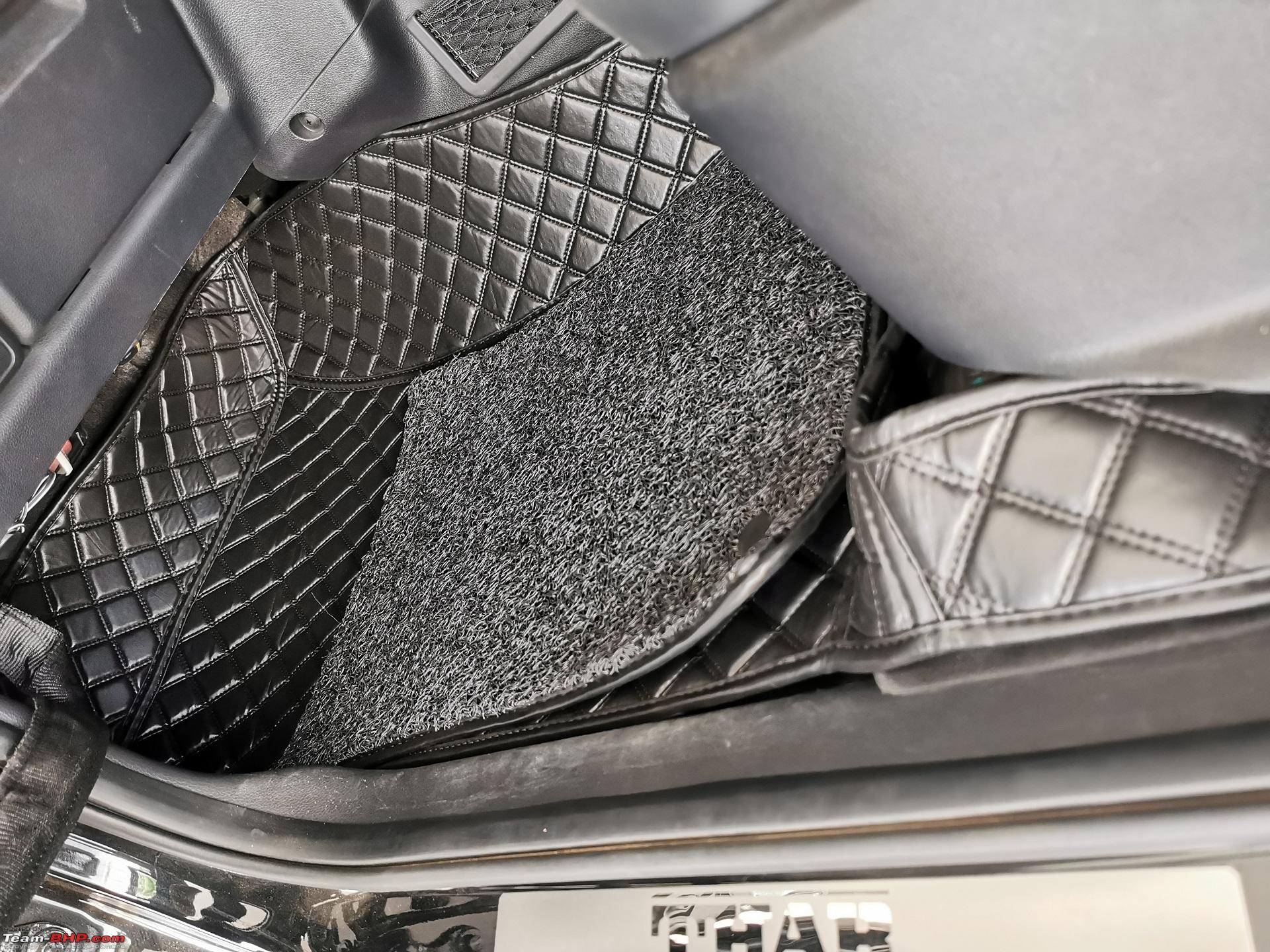

This is how it looks like in the driver footwell - I have not Velcro'd it at all so far!
Taste of Freedom | My Mahindra Thar LX Diesel AT | 50,000 km Update (Page 15)-08-autofurnish-6.jpgTaste of Freedom | My Mahindra Thar LX Diesel AT | 50,000 km Update (Page 15)-09-autofurnish-7.jpg

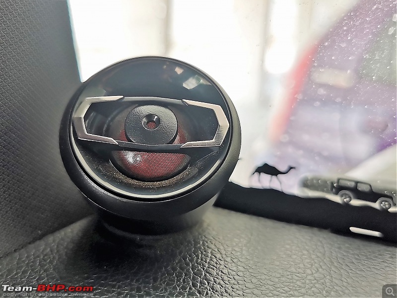

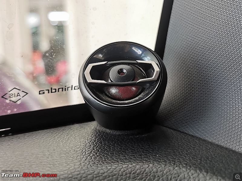

Got the coaxials installed on the roll cage speaker provision, and disconnect the tweeters from chirping in my ears. Installed the components' mids under the dash, and placed the highs at the corners of the A-pillar and the dashboard.
Taste of Freedom | My Mahindra Thar LX Diesel AT | 50,000 km Update (Page 15)-15b-tweeter.jpgTaste of Freedom | My Mahindra Thar LX Diesel AT | 50,000 km Update (Page 15)-15a-tweeter.jpg

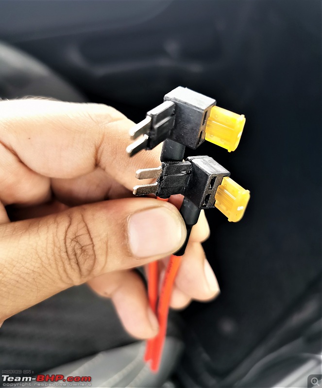

The hardwire kit comes with fuse taps like these -
Taste of Freedom | My Mahindra Thar LX Diesel AT | 50,000 km Update (Page 15)-19-70mai.jpg
Its needs two taps - a regular fuse (I tapped the cabin lamp fuse (F36) for this), and ACC power fuse (I tapped the MBFM ACC (F64) for this).
