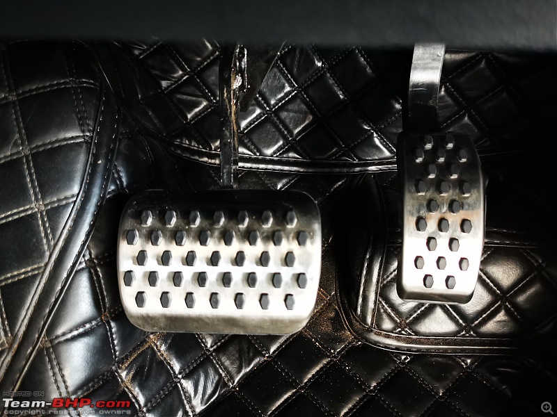

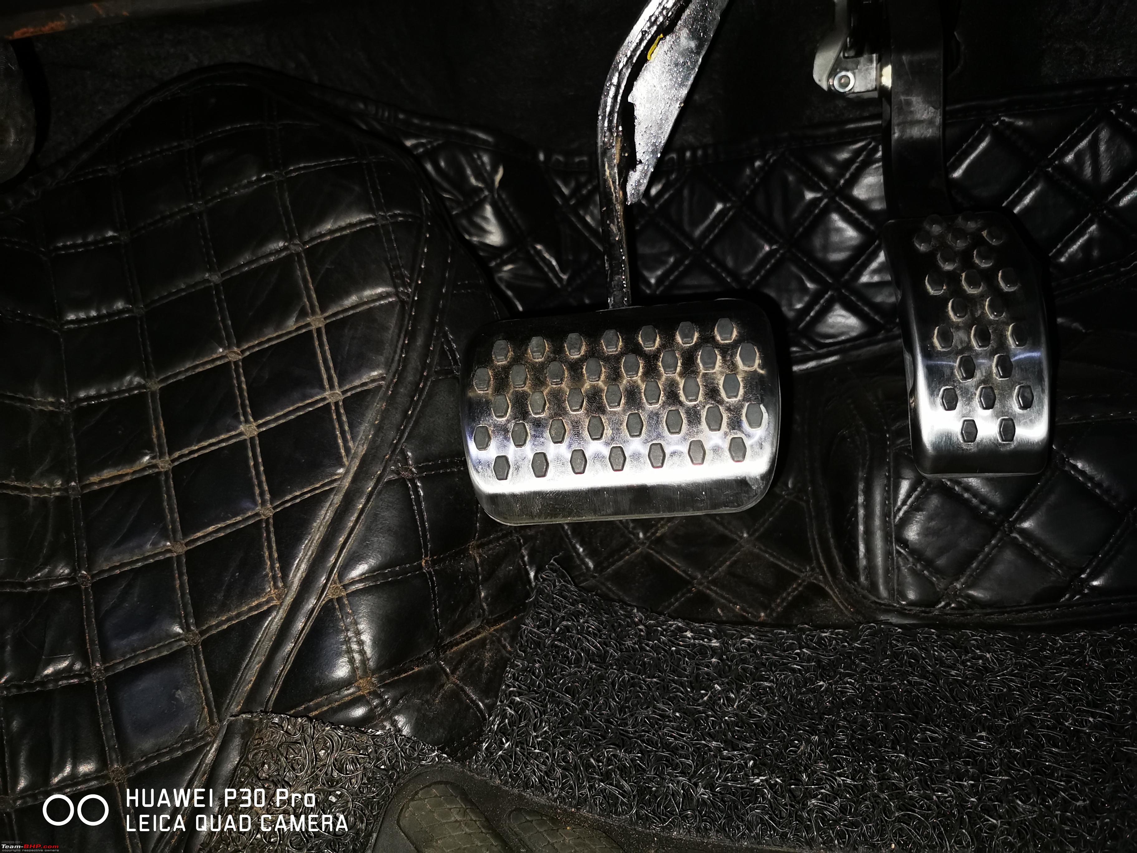

Sporty Pedals (from the XUV7OO)
I like my pedals with metallic finish, and when the XUV7OO's accessories came out, I zeroed in on one of its accessories - this:
Taste of Freedom | My Mahindra Thar LX Diesel AT | 50,000 km Update (Page 15)-01-pedal-set.jpg
A closer look
Taste of Freedom | My Mahindra Thar LX Diesel AT | 50,000 km Update (Page 15)-02-closer-look.jpgTaste of Freedom | My Mahindra Thar LX Diesel AT | 50,000 km Update (Page 15)-03-closer-look.jpgTaste of Freedom | My Mahindra Thar LX Diesel AT | 50,000 km Update (Page 15)-04-closer-look.jpg
The brake pedal is a direct fit - remove the stock rubber cover, and fit the 7OO's over the pedal's frame
Taste of Freedom | My Mahindra Thar LX Diesel AT | 50,000 km Update (Page 15)-05-brake-pedal.jpg
The accelerator pedal however does not fit. At least not rightaway!
Taste of Freedom | My Mahindra Thar LX Diesel AT | 50,000 km Update (Page 15)-06-mismatch.jpg
I had to gently bend the 7OO's accelerator pedal to match the Thar's curvature before I could put 'em on. Again, a crude jugaad, but worked!
Taste of Freedom | My Mahindra Thar LX Diesel AT | 50,000 km Update (Page 15)-07-done.jpg

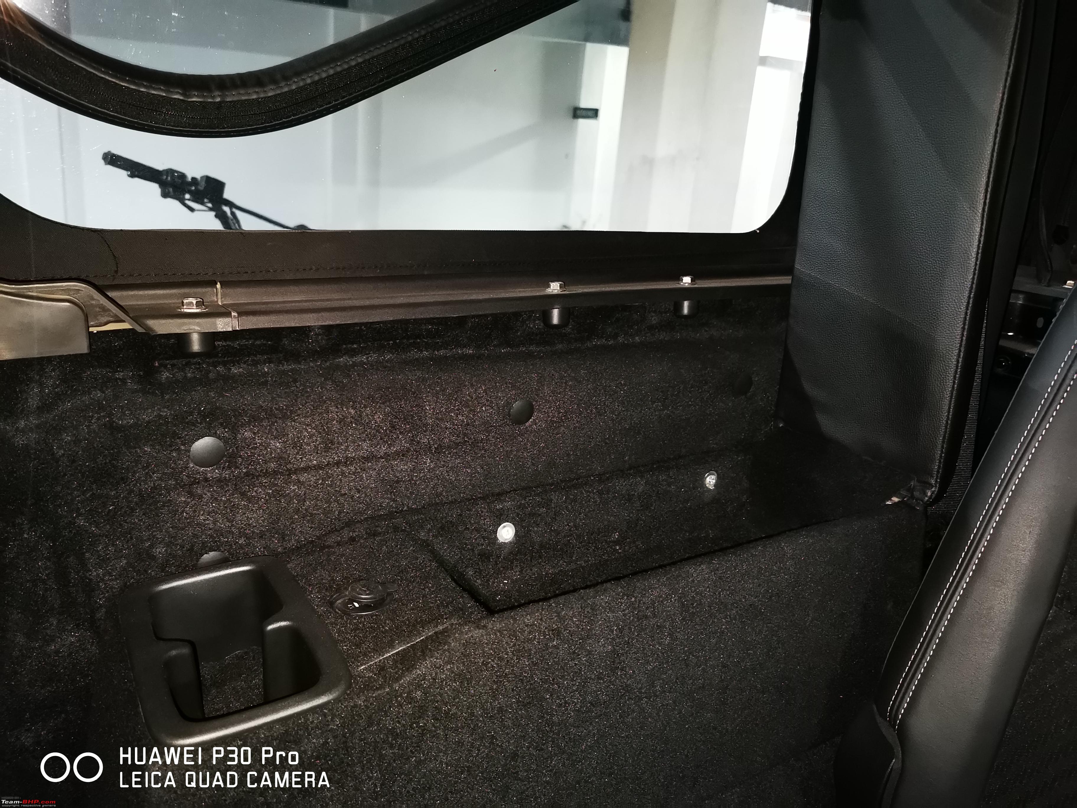

The rear ones, however have to be drilled in place. They come with two USB charging ports each side - I have decided not to wire these.
These do give a more finished look, and adds a bit to the comfort for the kids...
Taste of Freedom | My Mahindra Thar LX Diesel AT | 50,000 km Update (Page 15)-14-rear-armrest.jpg
...and a cubby hole at the rear to - perfect for the kids to stove off their Harry Potter!
Taste of Freedom | My Mahindra Thar LX Diesel AT | 50,000 km Update (Page 15)-15-rear-armrests-cubby-hole.jpg
