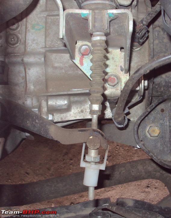

8,500km on the odo,and the driver has been complaining of a hardened clutch for the past few days.I drove it to check,and i found the clutch a bit hardened too,not too much to make it uncomfortable to drive,but just the effort has gone up in the last 2-3 days.The car has always been sedately and properly driven,with proper run-in,no riding on the clutch.The car is never left with driver alone,and he has never driven rashly.The service centre guys are in insisting on a clutch replacement,said it will cost 10K!!I really doubt this.
Try and get it replaced under warranty. I got my clutch replaced at 12 thousand km because it had become hard. Mine is a Swift Diesel.
I had the same complaint & I was suggested the same. Get a can of WD-40(available at hardware store for 60Rs.), jack the car up or look under it if you can (front, slightly left side, just along the radiator) & you will see the (dirty/muddy) clutch linkage (Alto K10 has cable clutch). Thoroughly spray with WD40 & leave for 30 minutes. After the elapsed time, if you press the clutch, it will go straight down as if the pedal is free.
Don't worry, you have remedied the clutch hardness to better than factory position. Feel free to repeat the process as & when the clutch tightens up.
Can't take pics now as it is dark. Can upload tomorrow if required.

re: 2010 Maruti Alto K10 : Review
@Just cause Thank you for those suggestions, had taken the car to a local mechanic,to just see what could be the problem.He insisted that application of lubricant or WD40 will not help,instead we need to replace the cable altogether.
Here is a pic of the cable.
Clean & spray the oily round part & also, the other end of the black arm (not visible in pic). It will lighten up significantly. Clutch cable doesn't go bad that soon. It will most probably lighten up after 30 min of application of WD40. I also apply WD40 to the gear joints also & the gear lever becomes butter smooth after that(not applicable to K10 as it has cable type gearing).
