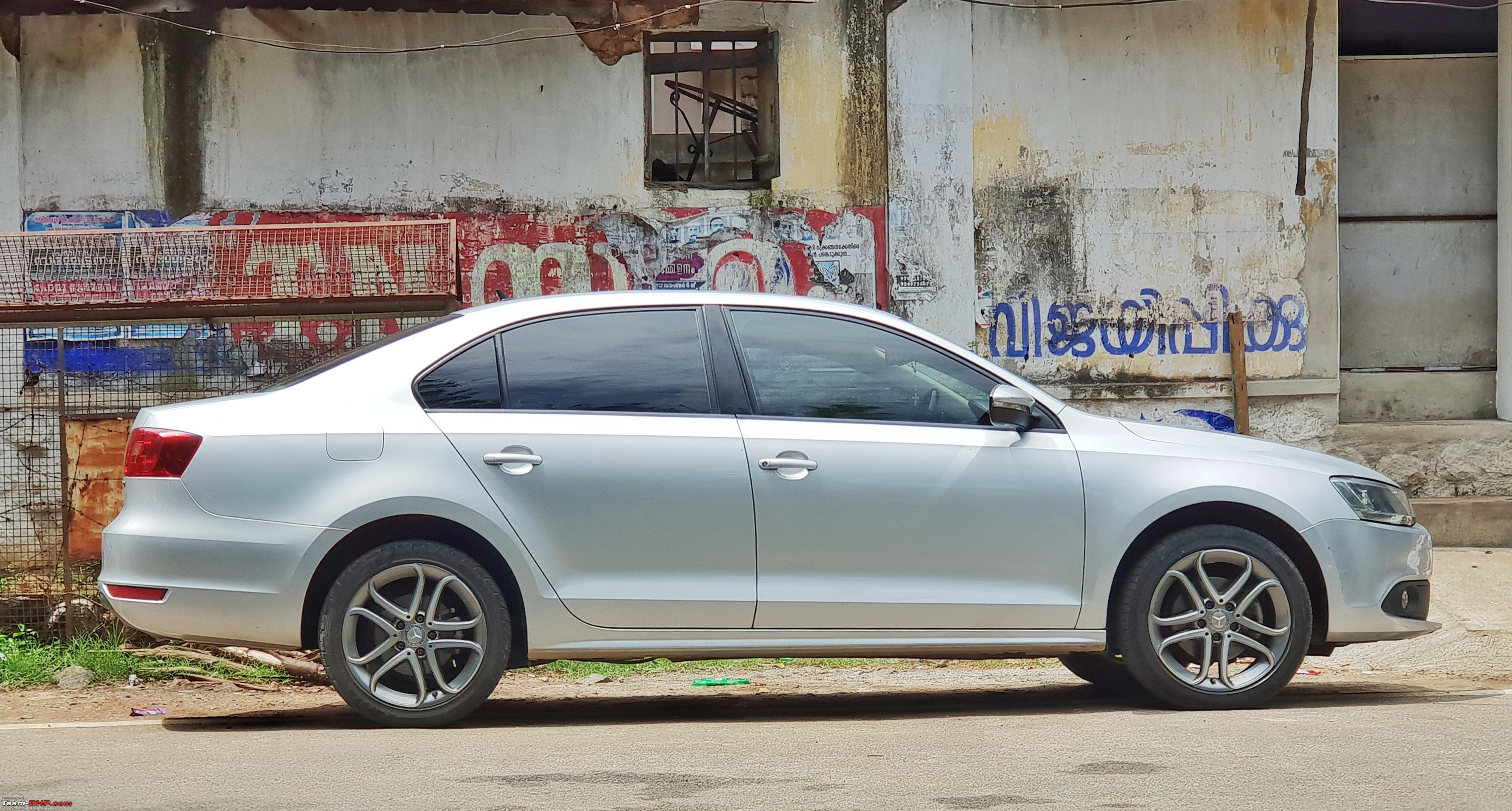

A much awaited wheel swap. Mercedes Benz A-Class 17 Inch OEM Wheels with Michelin Pilot Preceda for the humble VW Jetta TDi. The wheels have same 112 PCD, nylon hub-center rings 66.6MM - 57.1MM makes sure these stay on the hub!
That looks cool. What is the tyre size here? I tried 17" 225 R50 Michelin PS4, and it touches the tyre well when the car is fully loaded. I was hoping that it'll work - but, it didn't
I am running on 225/45 R17, took a few rides fully loaded, nothing scraped while turning or while navigating humps. So i suggest the same tire size.
