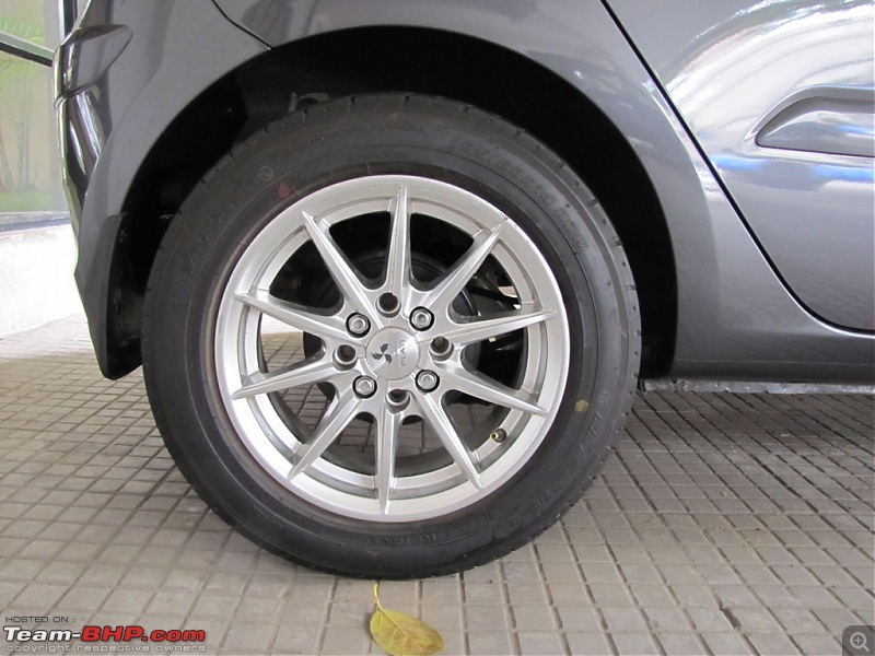

Pictures of my i10 Asta with 14" Plati alloy and Yoko ES100 185/60R14 footwear.

Hey those are my tires and wheels!
Noticed minutely and found that the wheels are a bit different - 90% same though!
BTW where did you get them from?
Also - when did you get the kappa2 version? You had a red kappa sportz AT right? Am I missing something?

Same place from where you got yours Sid - Minku Agarwal! It seems it has become his trademark. Everywhere I go, people see the alloy/tire combo and readily identify that it's from his shop.
I wanted a 6-spoke rim but they had 10-spoke PY829 available in the shop. I wanted to see more and ordered 6-spoke PY628 from the catalog. Finally after seeing both rims on the car decided to go for 10-spoke. Also, I was looking for Yoko A drive or Michelin XM1+ for a comfortable ride but they had Yoko ES100 and Pirelli available.
http://platiindia.com/serverImages/829.jpg
http://platiindia.com/serverImages/628.jpg
I can no longer see the rim that you bought. The closest one in Plati catalog is PY128 which is similar but the lug nut arrangements are different.
http://platiindia.com/serverImages/128.jpg
I sold my i10 AT in early 2010 when I left for USA. Got the k2 Asta recently - it has been only a few weeks.

I guess he is the prime dealer of plati rims in Kolkata.

Ya the one having my design is for 114 PCD i guess. Also - the rim you did not choose looked a bit too 'bling'.
