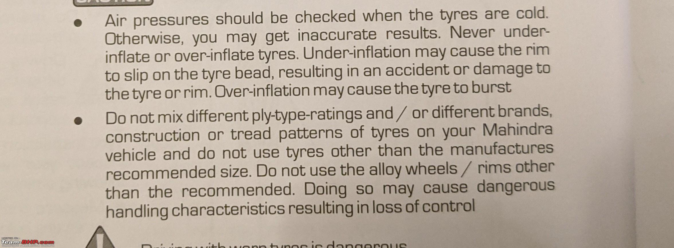

Originally Posted by Lobogris View Post
It is not at all obvious. No manual states the tyres have to be from the same manufacturer. Some manuals recommend similar size and tread wear which is quite reasonable.
Sir would you please read the previous page, I have posted it from two different owner's manual. Now you want more ? Sure here we go, this one specifically mentions No to different brand as well.
Same Tread pattern means, same tire - Apollo accelere does not have same tread pattern as Continental MC5, they may however has same tread wear number , which is not comparable between brands either , these are two different things, but you know that already.
Kosfactor is offline   (3) Thanks
