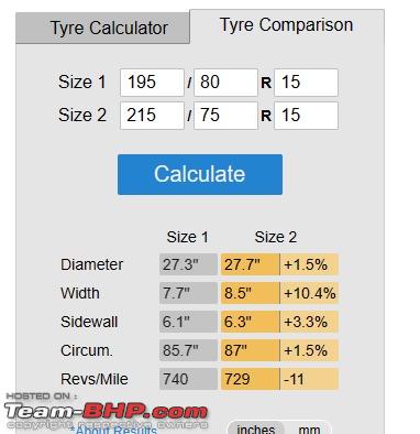

Continental CrossContact AT with 215 width at 28psi of Nitrogen
Your sidewall has increased by moving from 195/80 to 215/75.
Attachment 2470403
You are correct, this is my boo boo moment. But honestly after dropping the pressure down to 28 the car's ride has gone from excellent to sublime. I do not see the need to go any lower unless it's not being driven on tarmac. I will indeed try some different pressures and report my findings on the thread. Thanks for pointing this out.
Sure but I think it will be difficult to find the difference so easily as both are very good. Yoko's have a soft sidewall or used to have, I have seen sidewalls getting damaged. But I think, Yoko has unconditional warranty on these tyres ( made locally)
Moving our tire discussion to this thread, I was told the Yokohama Geolander AT have a much tougher sidewall and wear characteristics compared to the Continental CrossContact AT. That's honestly my primary curiosoty since I did prefer the looks for the Geolander, especially the ones with white lettering on the sidewall. Unfortunately that only comes with the 235 width so it was out of the question for me.
Have been offered the same warranty on the Continental tires and it does give peace of mind since this car doesn't have the tire insurance like other cars I own.
What is the final tire pressure you went with? Also suggest this route to test out the suspension, the road is horrible. I was able to go decent speeds and the car just floats over the bad bits, feels incredible.
