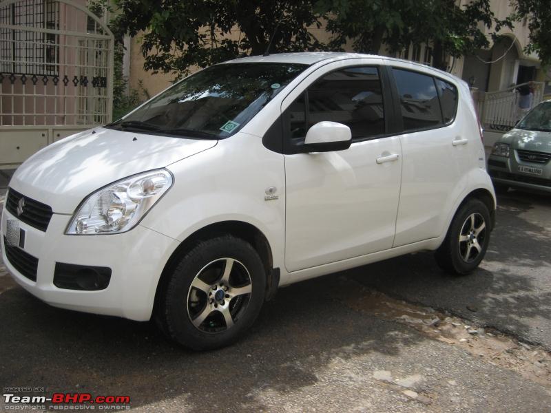

Can u please tell me whether u upgraded the tyres on the same steel rim or u purchased new alloy wheels.what u did with your stock wheels & rim which u got along with the car.please quote how much did u spend for 5 michelin tyres (any other option instead of michelin)and if u got a set 0f 5 alloy wheels please quote that also.If possible can u put a snap of the car showing the wheels.
I had given away the stock wheels and rims. I got everything around 33K (5 tyres + 5 alloy wheels). You can check this link and here
