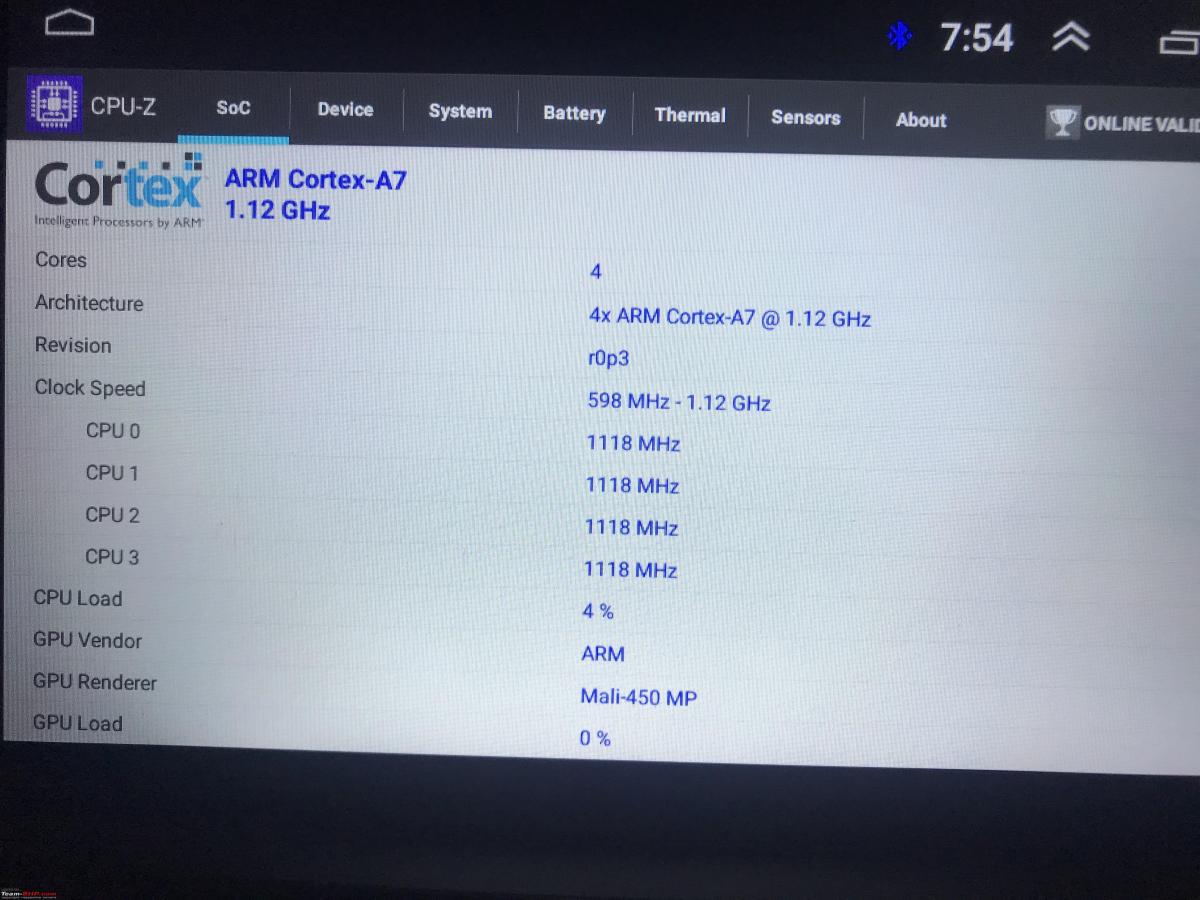

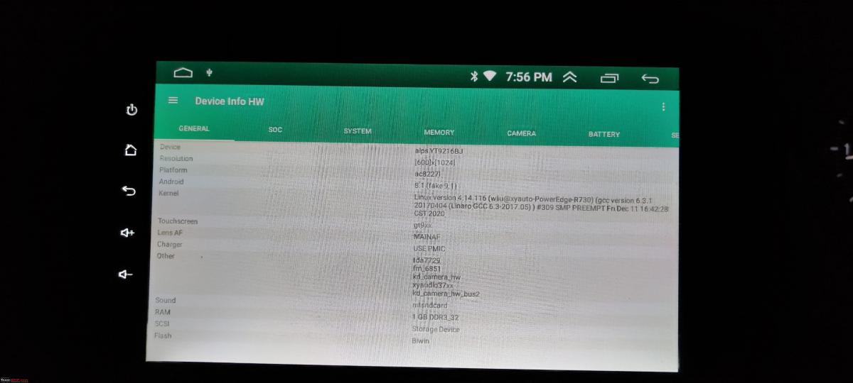

I got the HU installed on January 27th and it looked okay. The system info option on the UI claimed the promised features. The display was not the crispest, to say the least, but then I thought it could be due to the low pixel density. I didn't get much time to fiddle with the HU in the following days as I was busy. Today, someone from the Kerala Honda Amaze group asked me to share a video with the feature walk-through of the HU so that he can decide whether to purchase the HU or not. So, just for the sake of shooting the video, I installed CPU-Z and was quite shocked to see the details reported by CPU-Z. The CPU was 1.12 Ghz quad core processor, the RAM was just 1GB and the display was 1024x600 pixels with a pixel density of 159dpi. Confused, I installed Devie Info HW to re-check the specs. It reported the same specs as what CPU-Z had reported, and in addition reported one more thing - Android version was 8.1 as opposed to 9.1 claimed by the HU UI. To be precise, the android version was reported as 8.1(fake 9.1). So I decided to check the details further. Even in the Android device info, the Android version was marked as 9.1 and they even had the animation corresponding to Android Pie. Also, when I checked the RAM details after enabling the developer options, it showed 1 GB as RAM.
CPU-Z Specs:
Device info specs:
Device info RAM:

So, In summary, FoxFire is selling low spec Android HUs as high spec HUs by editing the details in the UI. I am sure that this is not the case with just me or the OP. Most probably a lot of users have fallen for this scam. I am not sure what to do next.
