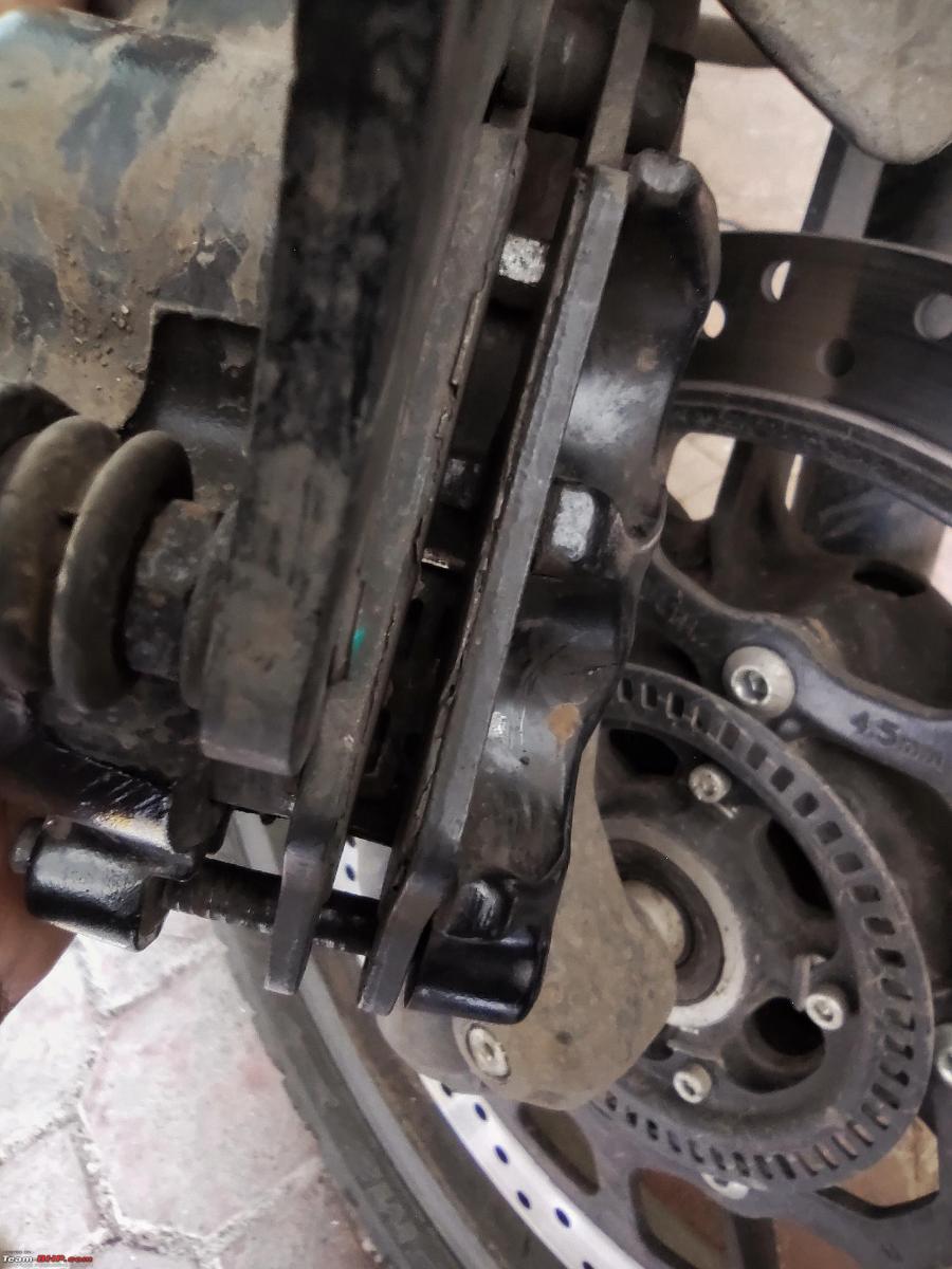

Went down to the parking with most tools, 1/2" socket set, and new brake pads. Removed both axial bolts and this was the sight. It had gone beyond the limits, and should have replaced the brake pads even before the Sat ride.
Removed both pins to take out old pads, here is a comparison of old with new. Pads thickness 0.9mm Vs 4.7mm.

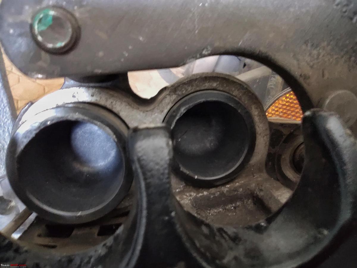

Next task was to push back pistons to make room for new pads. I started pushing piston one after the other only to reach the situation of one in, the other out.
That made me realise Ari's mention of opening the brake fluid reservoir, had forgotten about it. Spread a rag for any unintentional brake fluid spill and went back to pushing back pistons.

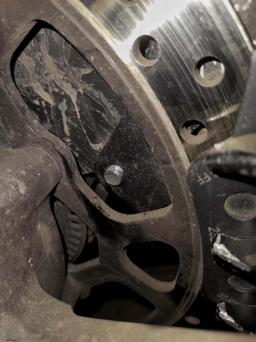

Fixed brake fluid reservoir cap and last thing was to tighten axial bolts. Almost the entire DIY went well so far. Just as I was tightening 2nd bolt with a ratchet handle, more torque got applied (perils of not carrying a torque wrench) and the bolt snapped into two.
Next task was to remove the bottom part of the broken bolt.

I couldn't spare time in the upcoming week to delve much other than trying to remove the bolt with different pliers. I decided to visit auto workshops in the suburbs. First I visited a welder and his suggestion was to get the braking system removed from a mechanic and then explore removing the bolt. Found a mechanic working on an RX100 two outlets away. Mechanic's idea was to remove the front wheel and slide out the brake system from the brake disc.
He put up a jack with a wooden block beneath the engine to lift up the front wheel and then the search started for the 12 mm Allen key. He didn't have it, he checked with nearby 4-5 workshops that also didn't have it.
The next thing was to use a 12mm bolt with a longer handle welded to it. Unfortunately, that didn't work either. Myself and mechanic decided to visit hardware shops in the suburb to get a 12mm Allen key. I tried at New Rekha Hardware, but his stock was over and promised to get it the next day. I picked up bolts from there, it was a black, unfinished one.
Luckily, the mechanic got it from another hardware store and we could proceed with removing the front wheel. Next things were easy, we were able to get enough space to remove the bolt with a plier, no need to go back to Welder.
