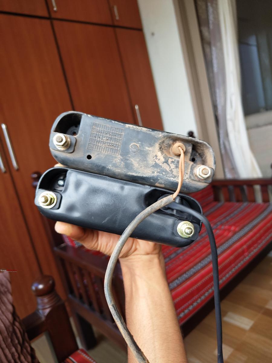

The existing stock rear fog lamp reflector was burnt and more over water ingress caused the reflector to worsen. I tried putting LED bulb but it was of no use. for the time-being my uncle at home had 3 led strips so I mounted the same for a few months and was on the look out for a replacement.

I noticed the OEM one had provision to mount the LED reflector along with the LED's same where the Autogold had them. So it was decided to transplant the LED onto the stock rear fog lamp and also use the stock rear fog lamp wiring harness than using the Autogold one:
