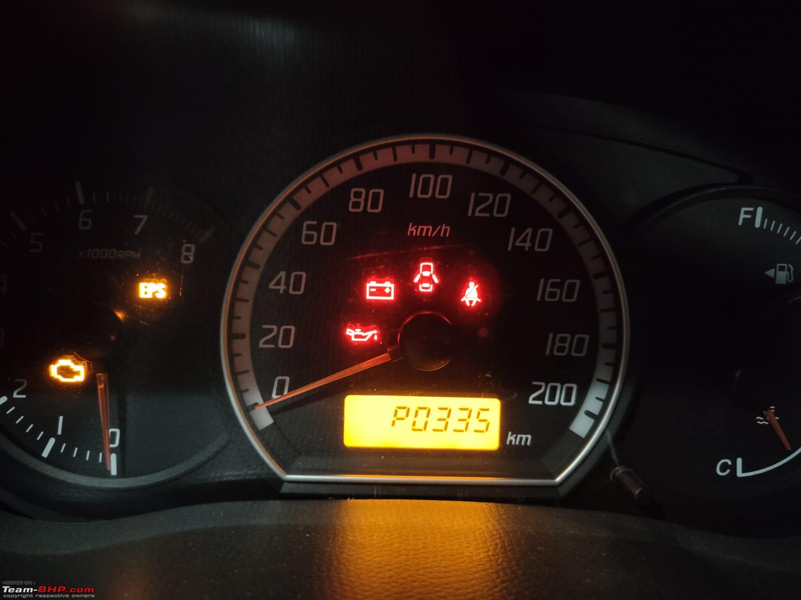

Displaying the DTC's and Erasing them without any Scanner !
This generation of Swift has an hidden feature to display the Diagnostic- Trouble Codes (DTC) and clear them without the use of any scanner. I stumbled across this when I read the Service Manual, quite interesting I tell you. This was also mentioned in the international Swift Service Manual. Nice of Suzuki to implement this easter egg.
So basically here DTC is divided into two sections:
  • Body Control Module (BCM) Related DTC
  • Engine Control Unit (ECU) Related DTC
Each of them have a different way of displaying DTC's on the speedometer.
To view Body Control Module(BCM) related DTC's
1) Turn ignition switch to OFF position.
2) Perform following Steps a) to d) within 10 seconds after ignition switch is turned ON and engine stops.
a) Turn headlight switch to clearance lights position.
b) Turn headlight switch to off position.
c) Perform Steps a) and b) 3 times total.
d) Press and release driver side door switch 3 times.
3) Check DTC displayed on odometer of combination meter
When more than 2 DTCs are stored in memory, flashing for each DTC starts with the smallest DTC number in increasing order. Also, DTC is indicated repeatedly until the ignition switch is turned off.
Azure Grey 2006 Maruti-Suzuki Swift VXi | Ownership Review-clearance-light.jpg
Clearance Light position in the Headlight stalk
The DTC's if any, should be displayed on the odometer display in the combination meter as such.
Azure Grey 2006 Maruti-Suzuki Swift VXi | Ownership Review-img_20210812_112250.jpg

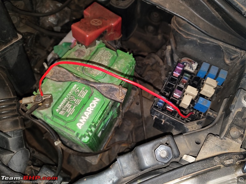

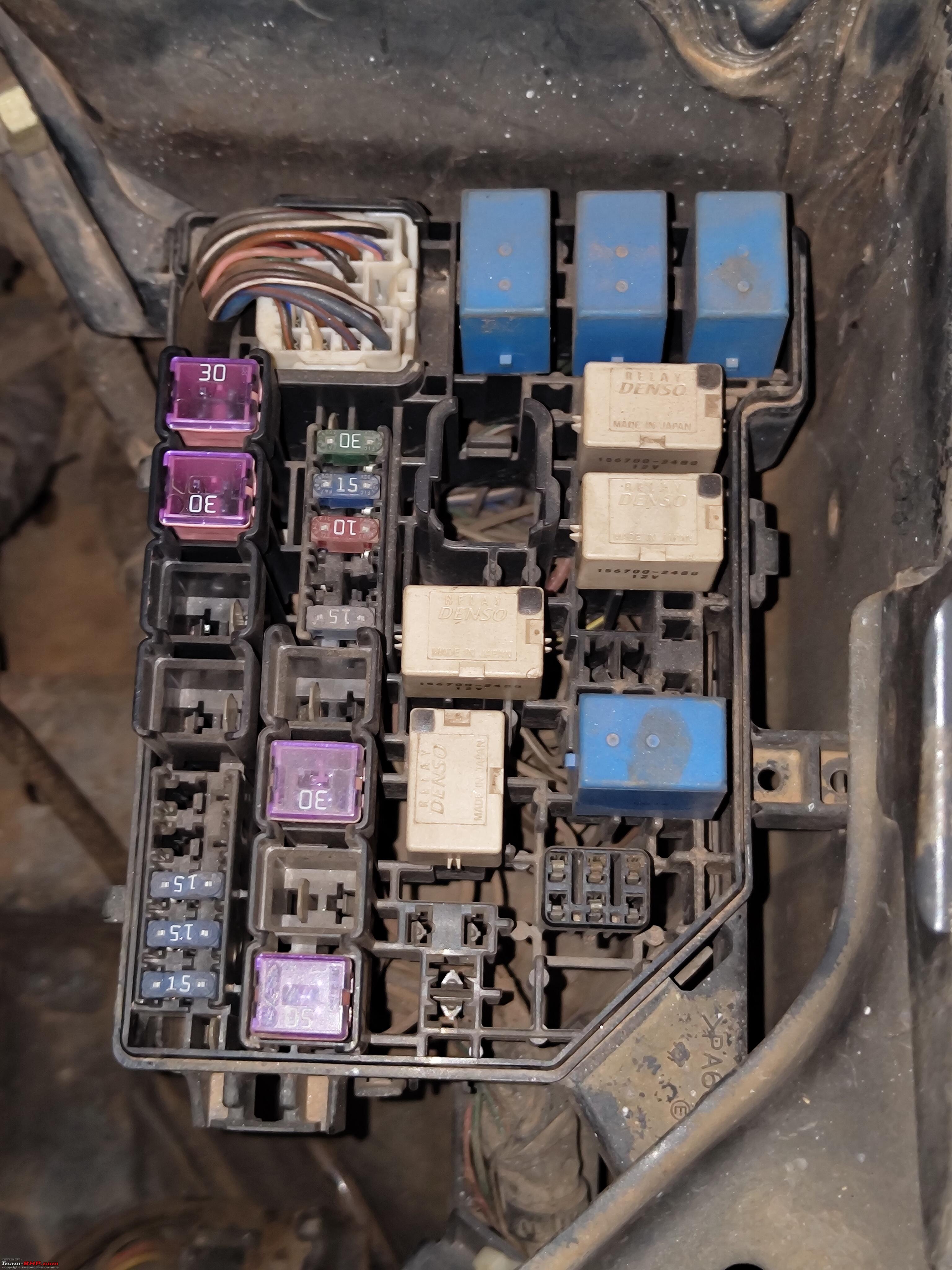

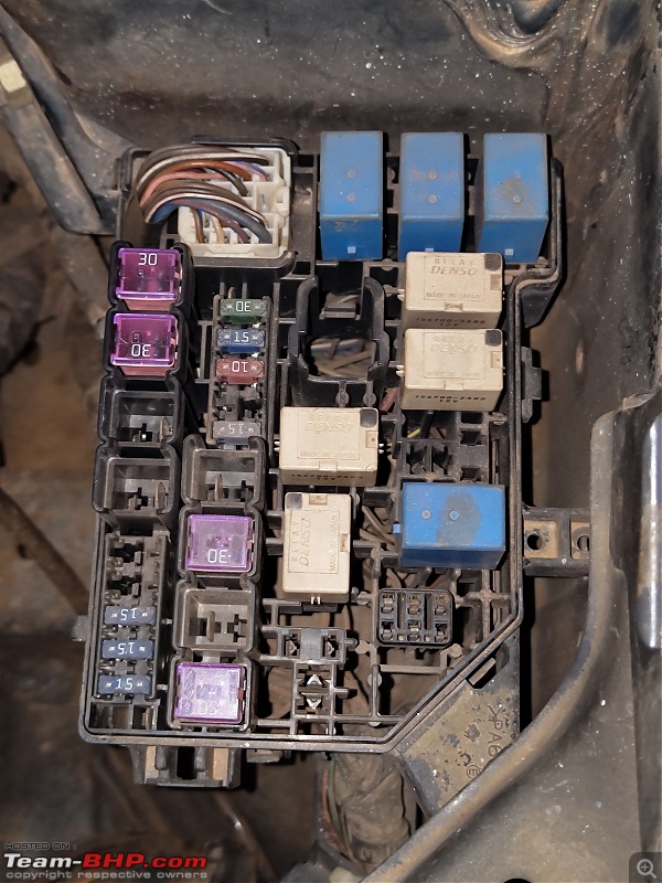

To view Engine Control Unit (ECU) Related DTC's
In the engine bay , locate the Fuse box and open it.
Engine Fuse box without its cover
Ground the Highlighted pin using a wire to the battery negative.
Now put the car in ignition, ECU Related DTC's should be displayed on the odometer display in the combination meter as such.
