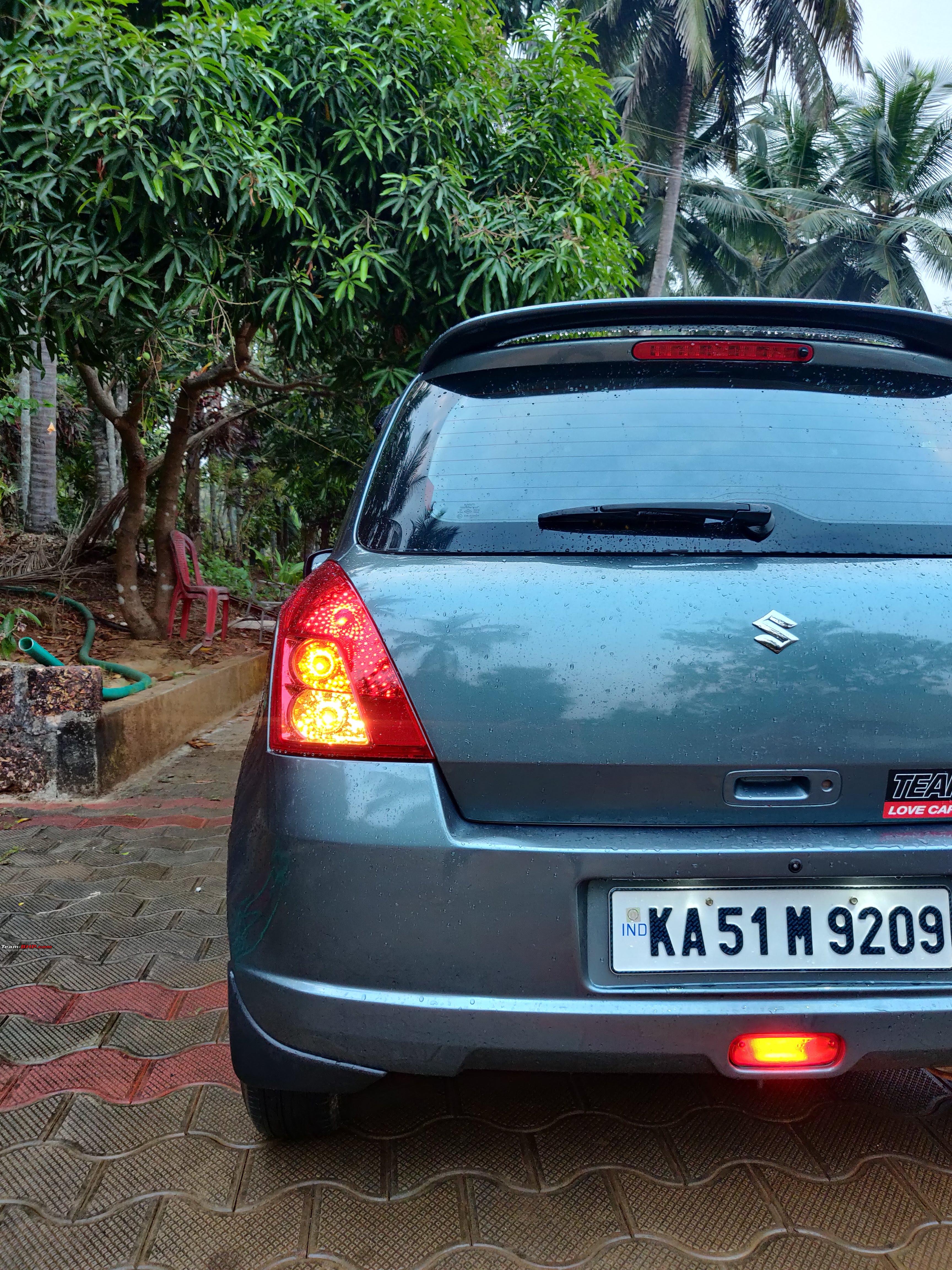

Adding a Rear Wiper

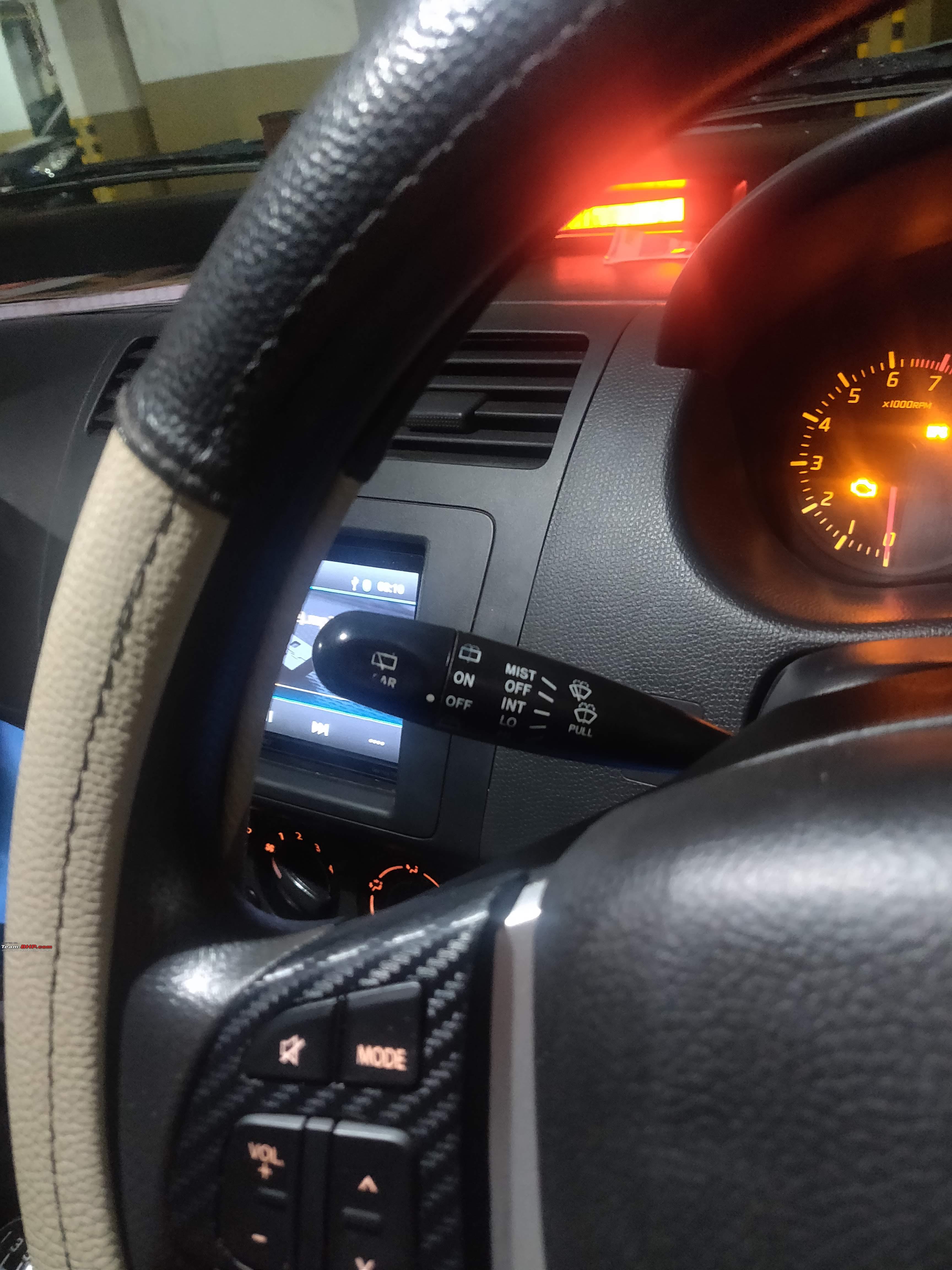

During a road trip to Murudeshwar, it was raining heavily. My car being the VXi variant, Rear wiper was never present. The First generation Swift got the rear wiper only the ZXi variant which was top of the line Initially I thought I wouldn't be requiring it, but during this road trip, I actually felt the need for a rear wiper as I could see nothing in my IRVM.
So I started scouting and doing my homework on how I could fit a rear wiper on the Swift. I also learnt that I would need to change my rear glass to the one which comes in the ZXi with the wiper hole and the defogger elements. I called up MASS and asked how much it would cost for the glass change inclusive of labour, they quoted 5000rs.Upon that I would have needed to buy the following things
  • Rear Wiper motor
  • Floor wiring
  • Rear End Door Wire Harness
  • Wiper Arm
  • Wiper blade
  • Rubber Grommets
  • Washer reservoir
  • Washer Pump
  • Plumbing
  • Rear Wiper Switch
  • New HMSL with washer option
The estimate for the above items crossed 10,000Rs along with the glass change and so upon discussion with dad, it was abandoned for the mean time.

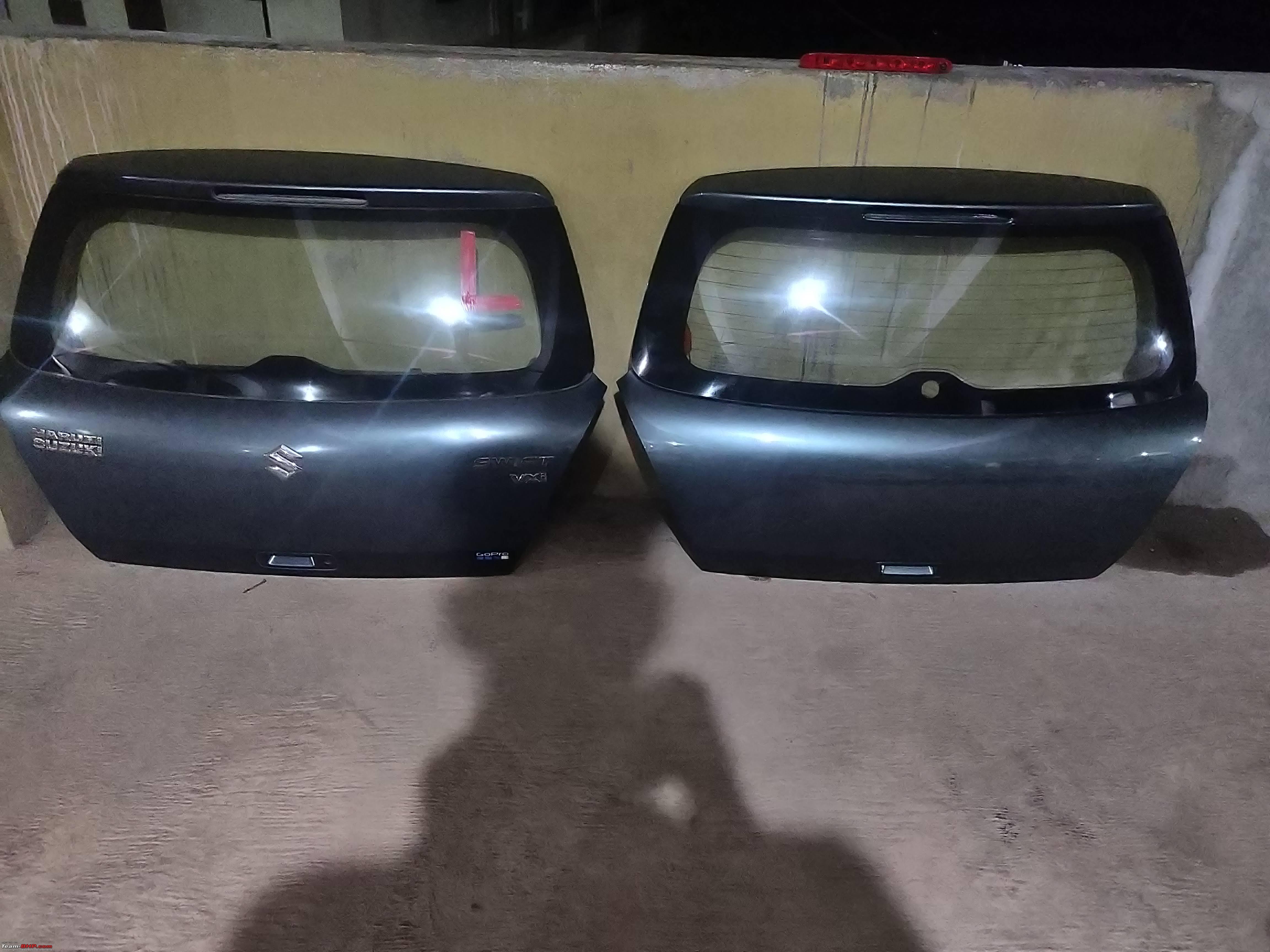

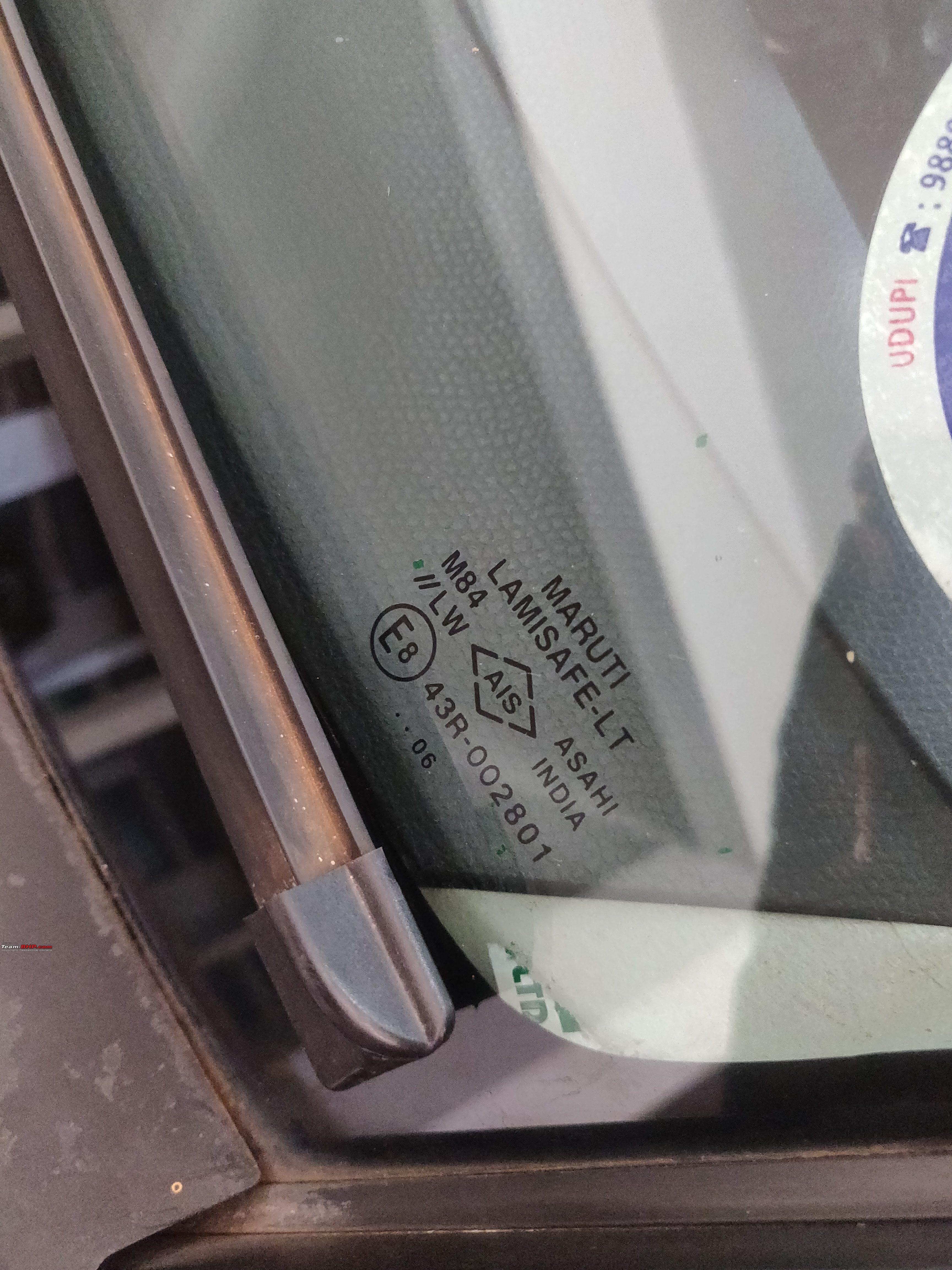

The next week I swung by the scrap yard to search for few parts for the Swift and I was shocked to see a whole ZXi rear door with all the parts in it in the scrapyard. The Rear end door was in great shape with no dents and a clean rear glass with the whole wiper assembly and another bonus , an Electromagnetic Tailgate Opener.
Immediately called up dad and we decided to pick it up ASAP. Negotiations happened and we picked it up for dirt cheap price the same day. Now since the Boot door which we found was not the same colour as my Swift, a Repaint was needed. Called up my Painter and asked him to get the paint ready.

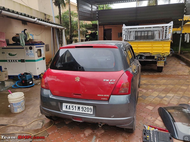

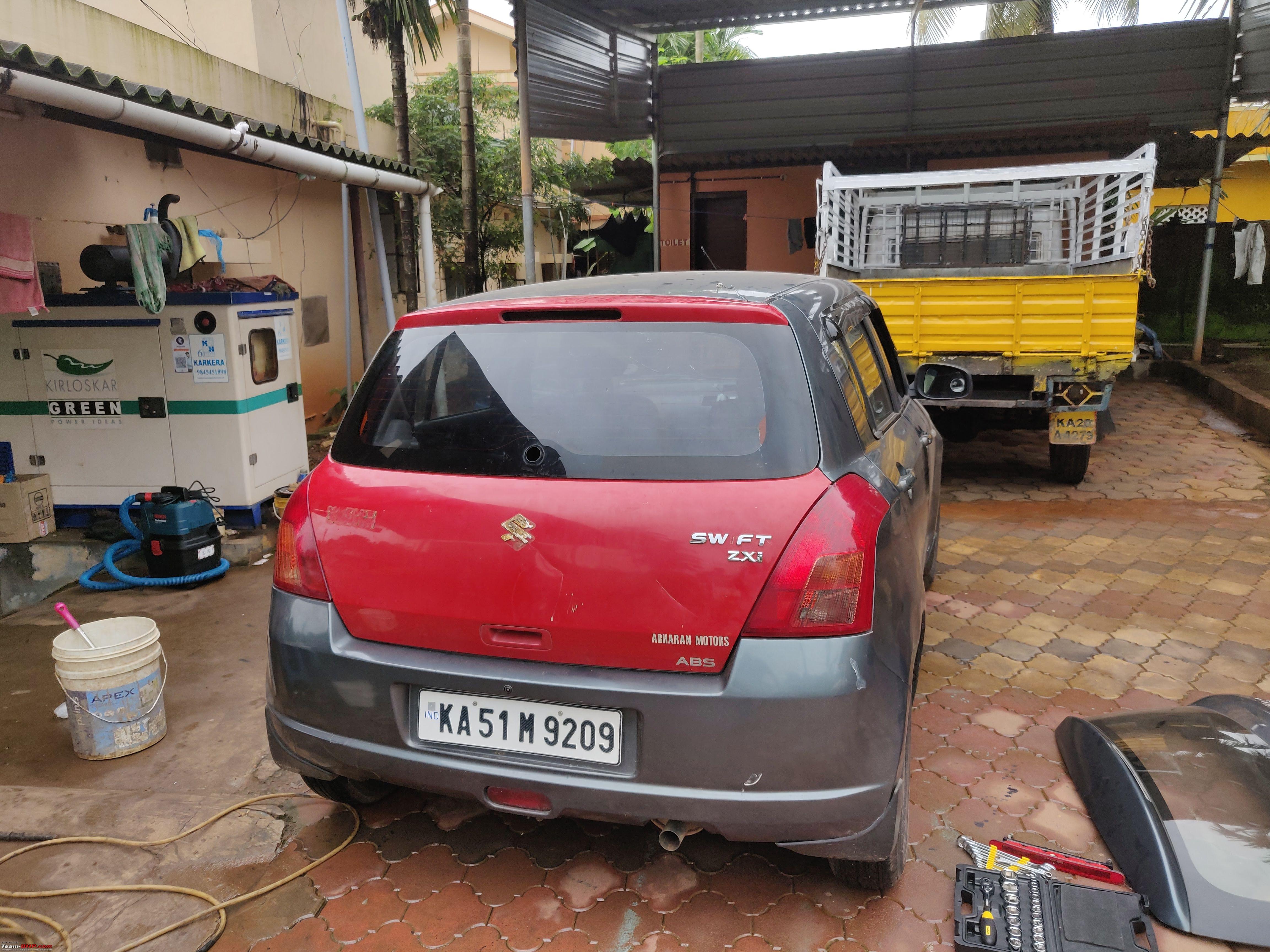

Now, I had to check the panel gaps and see if it was within the tolerance levels, so I removed my boot door and placed the ZXi boot and checked the fitment. It was perfect !
Hope this photo doesn't pop up in the weird and wacky Mod's Thread

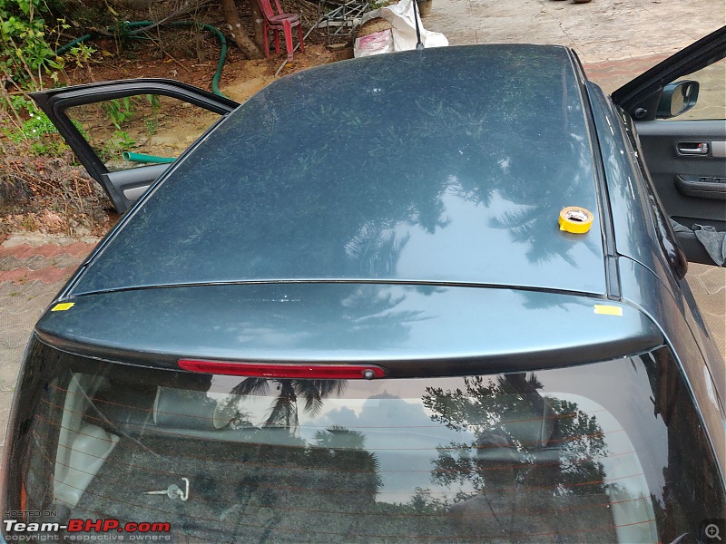

I removed the wiper assembly and handed the door over to my painter in my village. In about a week he was done painting and pinged me saying its done , The paint job was done nicely with almost nill orange peel and the paint matching was very accurate.
Azure Grey 2006 Maruti-Suzuki Swift VXi | Ownership Review-paint-boot-done.jpg

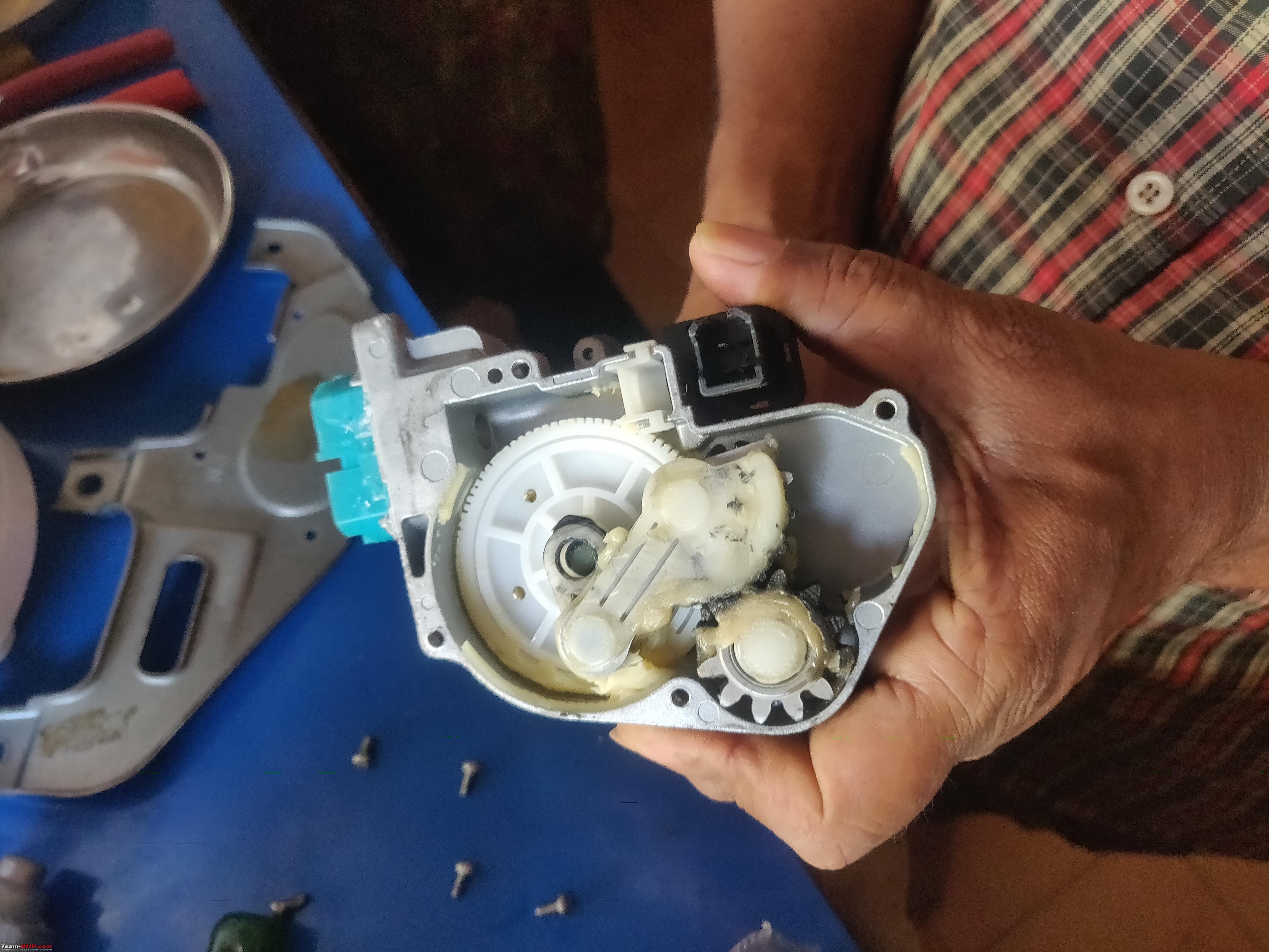

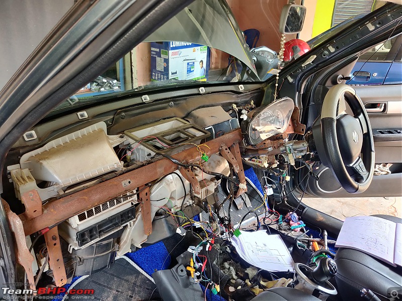

So now I start my homework to understand how the Rear wiper works in the ZXi variant. I managed to download the International Swift Service manual and used that as an reference to understand how it was wired in the ZXi.
Azure Grey 2006 Maruti-Suzuki Swift VXi | Ownership Review-rear-wiper-service.jpg
I even opened up the rear wiper motor to see how it functions and cleaned its internals, replaced carbon brushes and lubricated them well.

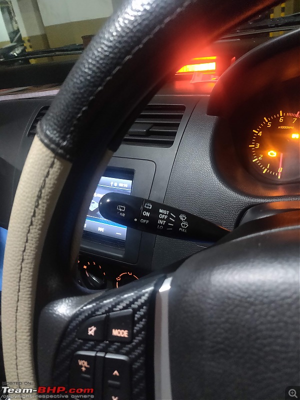

Since this was a major mod involving wiring around the BCM, Dad suggested taking it to an auto electrician and get it done, I agreed. Started scouting around for knowledgeable auto electricians and none of them were ready to do it since the BCM was involved. Meanwhile my close buddy and BHPian ChiranjitP sourced a rear wiper switch and sent it over to me. At last, I managed to convince an auto electrician who was near my college to get it done. He also repairs ECM's so that was what convinced me he can do it. I printed all the diagrams required and showed it to him. He told me to get the car next day morning 9 AM. I went home and installed the new boot door and kept it all ready.
Azure Grey 2006 Maruti-Suzuki Swift VXi | Ownership Review-old-new-boot-door.jpg
Skipped a day of college and the work was started, He mentioned it was easier to remove the dashboard and work with the wiring because the BCM is not easily accessible. So they started removing the dashboard and in an hour and started the wiring. we tried wiring the rear wiper as per the diagrams but later found out my BCM doesn't have that circuit in it as the International swift got a rear wiper Intermittent function too but Indian Variants never got it. The electrician then didn't want to abandon the project so tapped power from an empty relay socket in the BCM. We replaced the washer reservoir tank and installed a washer pump for the rear washer. Passed the wiring though the firewall grommet and did it successfully. It worked perfectly. The work was completed by evening and it looked superb.
Some photos of the Project.
Azure Grey 2006 Maruti-Suzuki Swift VXi | Ownership Review-rear-wiper-switch.jpg
Azure Grey 2006 Maruti-Suzuki Swift VXi | Ownership Review-complete-proj.jpg

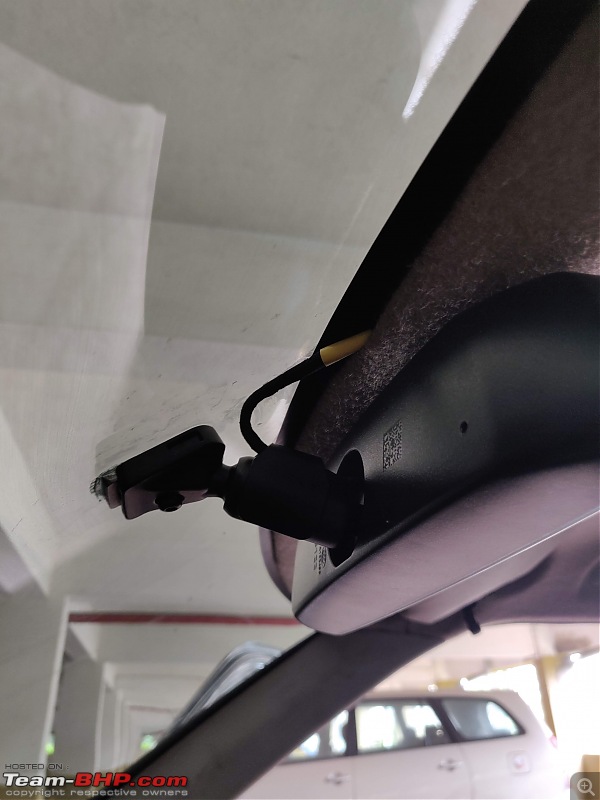

Adding An Auto Dimming IRVM
My Generation Swift VXi/LXi did not even get a manual Day/Night IRVM. So I started scouting Boodmo for the IRVM, while I was at it I immediately noticed an Honda IRVM which is listed for ₹422 and I saw a connector coming from the IRVM. Did a few searches on the internet and found out it's an Auto dimming IRVM and few people had installed it on their Honda vehicles. It got me thinking, If it's done on their vehicles why would it not be possible on mine ? and so the homework started !
I learnt that that the IRVM is mounted on the windshield using a Mount, now since my car got a roof mounted IRVM it had no mount on the windshield. Now the basics were learnt so I immediately called up my close buddy ChiranjitP and told him about my findings and asked if he would want to do it too along with me. He immediately agreed and so we both placed orders on Boodmo and it arrived within 5 days at my place.
I rushed to Honda Service Center and managed to get two mounts ,one for me and other for Chiranjit. Decided that Araldite Standard Epoxy was the best glue to stick the mount to the windshield and procured it from my hardware store.
Measured and stuck the mount with the glue and let it cure for about a day.
Used a fuse tap and did the wiring at home and mounted the IRVM on the windshield firmly, Tightened the torx screw at the bottom.
Photos of Final results
Azure Grey 2006 Maruti-Suzuki Swift VXi | Ownership Review-irvm-installed.jpg
Azure Grey 2006 Maruti-Suzuki Swift VXi | Ownership Review-irvm-installed-2.jpg
Azure Grey 2006 Maruti-Suzuki Swift VXi | Ownership Review-irvm-installed-3.jpg

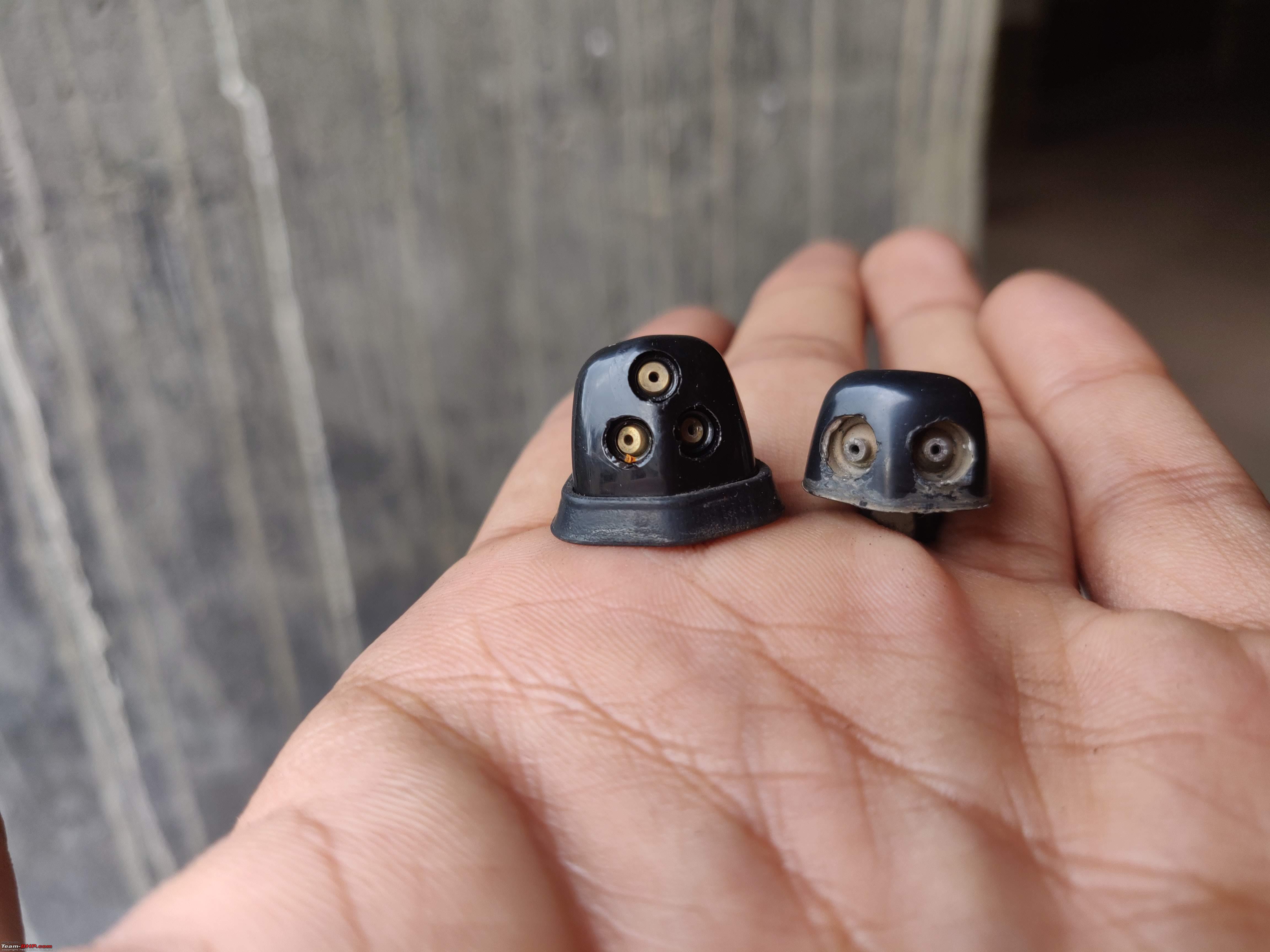

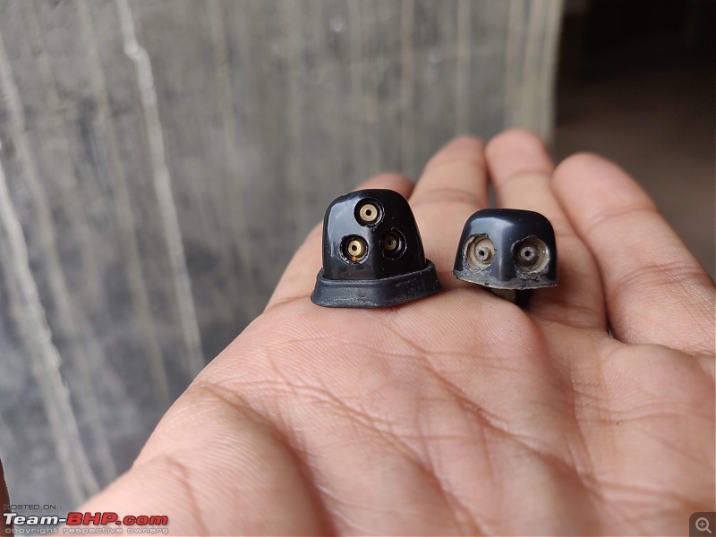

Upgrading the Wiper Washer Nozzles

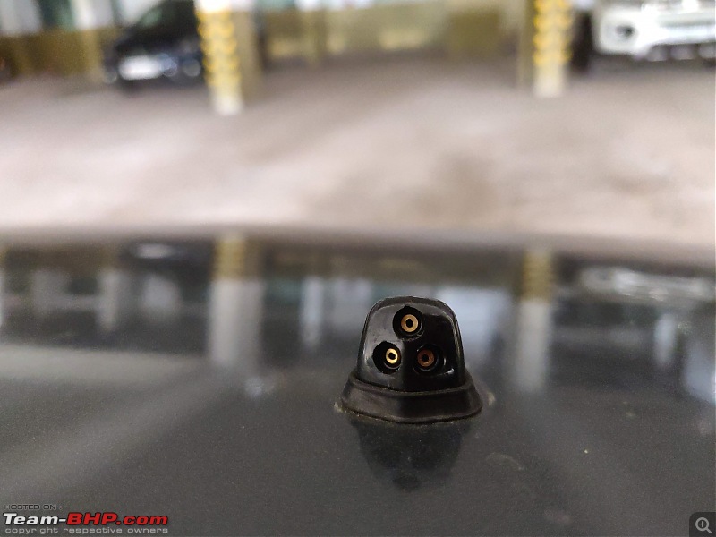

I noticed my wiper nozzles jets were choked and their spray was not efficient even with the nozzle cleaned. The second gen Swift comes with 3 jets where as mine has just 2 jets. Upon seeing the photo in boodmo I knew it would be a direct fit and 3 jets would mean better spray on the windshield.
Part name- NOZZLE WASHER
Price- ₹50
Part number- 38480M74L00
Boodmo Link
New nozzle vs old wiper nozzle
Azure Grey 2006 Maruti-Suzuki Swift VXi | Ownership Review-new-installed.jpg
New nozzles installed

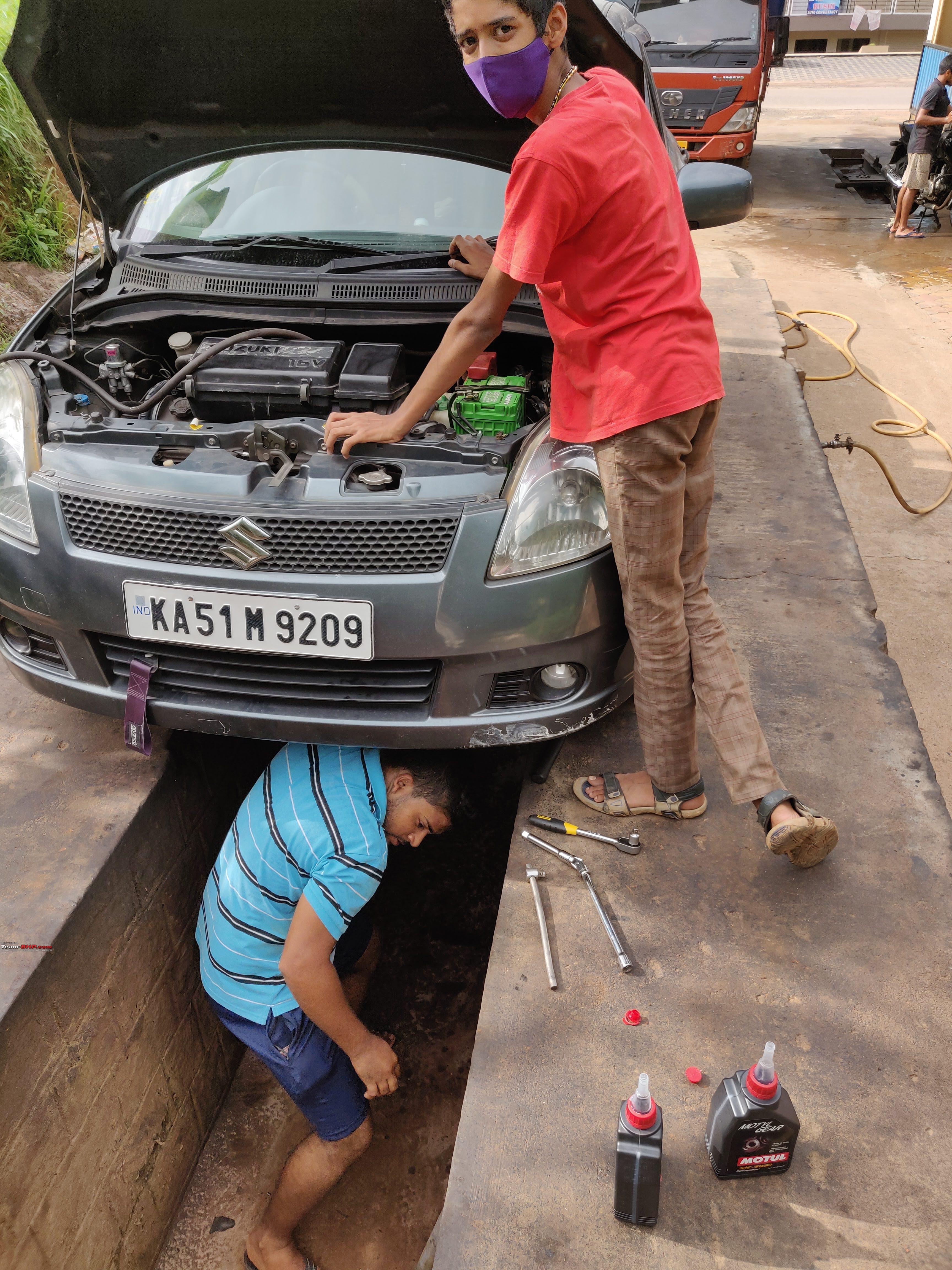

Changing the Gear Oil
I was facing slight resistance when shifting gears, After discussing with fellow friends and mechanics, they recommended to change the gear oil first and see if that solves the issue, I obliged. The owners manual recommended 2.2Litre of 75W90 Gear oil for the gearbox. I couldn't find 75W90 grade gear oil in my locality, Checked Amazon and Flipkart and procured 2 units of MOTUL MotylGear SAE 75W-90 for ₹920. The gear shifting eventually became
much better after driving about 5kms or so after the gear oil change.
Link for MOTUL MotylGear SAE 75W-90
Did the Gear Oil change as a DIY with the help of my dear friend and younger cousin who is very eager to learn new things about vehicles.

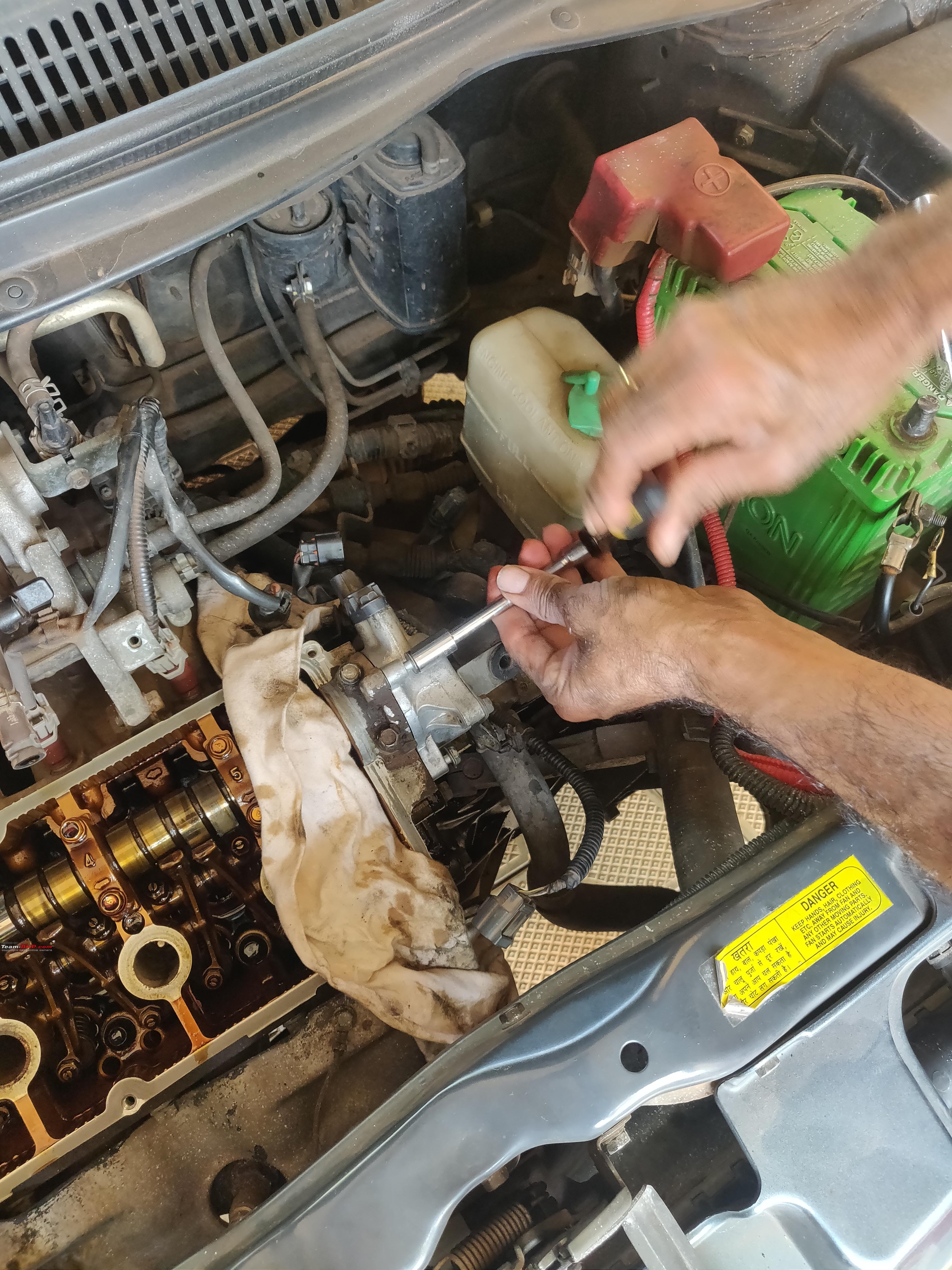

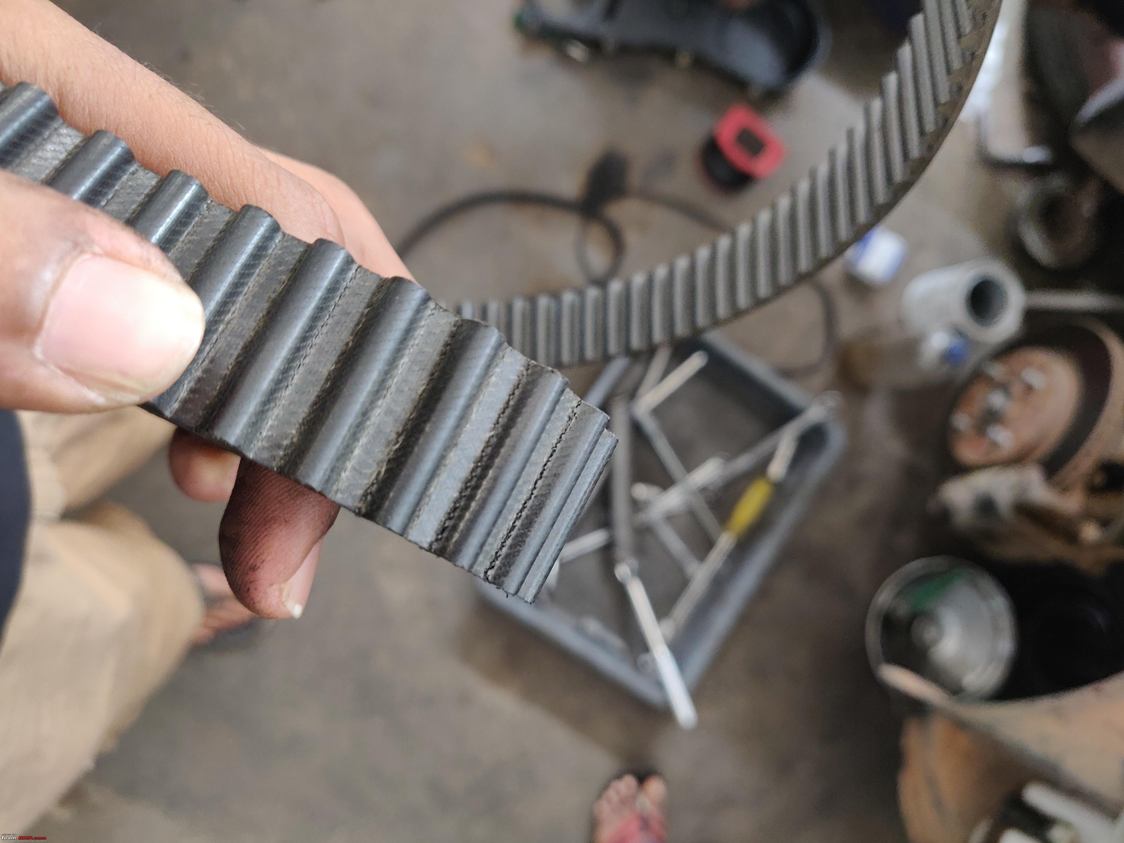

Timing Belt Replacement
The Swift had crossed 15 Years and I knew the Timing belt was not changed in its lifetime so it would be the best time to get the Timing belt changed. According to the Service Manual, Timing belt is to be changed at the 1,00,000km Milestone but there is no time frame mentioned. Rubber over time breaks-down, cracks and looses its temper.

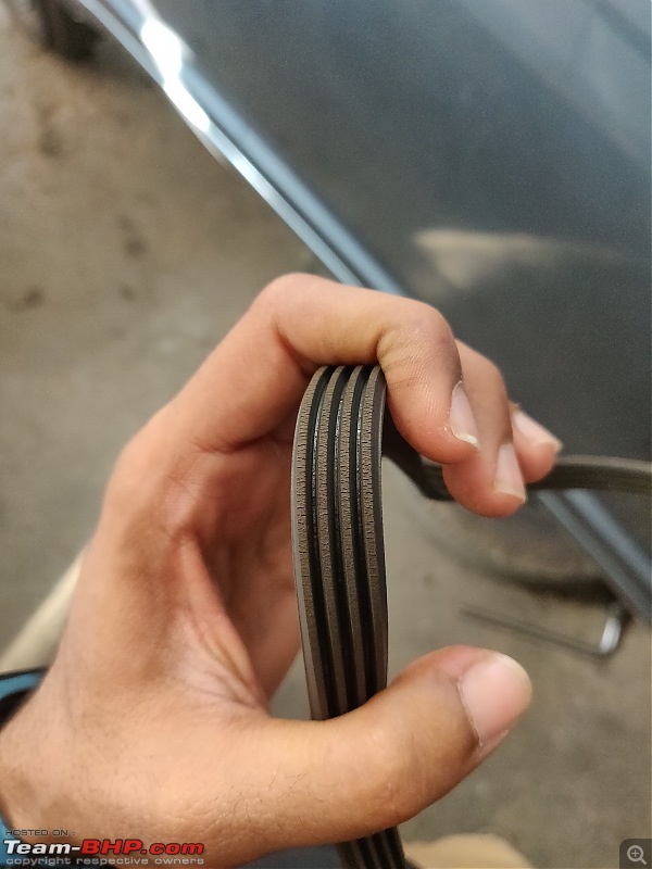

Azure Grey 2006 Maruti-Suzuki Swift VXi | Ownership Review-ac-belt-crack.jpg
AC belt had become weak and a replacement was due so it was good I chose to change all belts.

New Belt vs Old Belt
Old Belt vs New belt, Notice the cracks on the old belt
Close up of the cracks

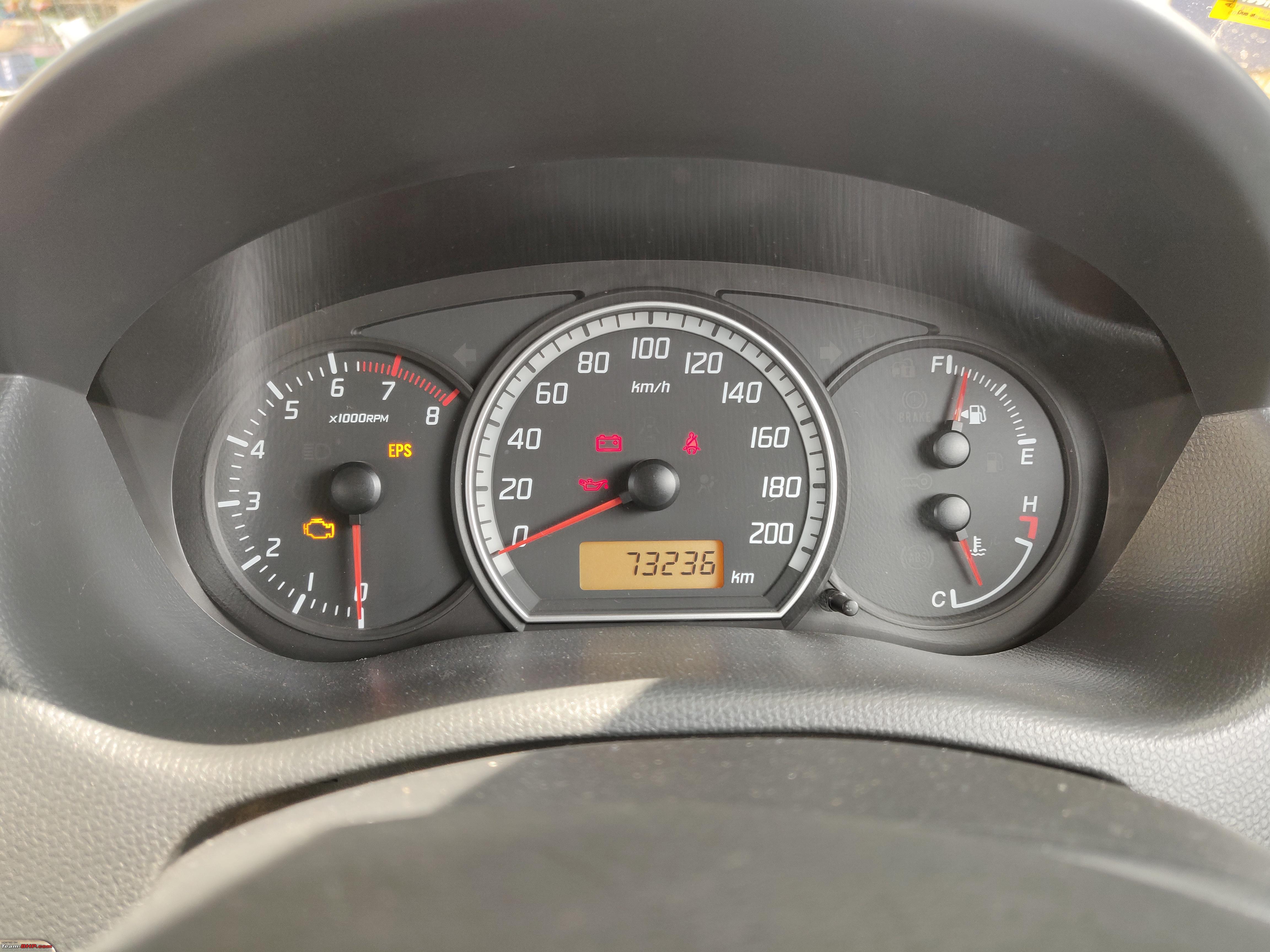

Odometer reading at the Time of Timing belt Replacment

It was well over a year since I serviced the car, and I didn't want to face the previous episode of getting ripped off, so I decided to do the service myself at Home. Anyways I had the required tools, so it was a breeze.
The Odometer was 74130kms, so technically, the car did about 8000kms since the last service. I managed to get a great deal on Mobil 1 5W40 3.5Litre Fully Synthetic Engine oil on Amazon for ₹1618. The seller sent the very recent manufactured stock as well.

The Swift G13BB Engine has a common leak from the tappet cover near the DLI Sensor. So I decided to fix that as well. The following things were replaced during this service.
I unbolted the tappet cover and the DLI Sensor case, and to my surprise, there was almost NILL sludge. Dad helped in cleaning the DLI Sensor case and replaced the Case O-ring. Installed new Spark Plug O-Rings and the new Tappet Cover Gasket.

Azure Grey 2006 Maruti-Suzuki Swift VXi | Ownership Review-old-glass-make.jpg
Make of the Old Windshield 06 (AIS)

New Taillights
The Taillights on my Swift were having water seepage issues and moreover I felt it would be best to change them to the Type 2 Taillights ( 2008-2010 Swift). They were of clear lens type compared to my stock Taillights. The new Taillights were ordered from Boodmo. The rear looks have changed post these new taillights
Type 1 Stock Taillights
Azure Grey 2006 Maruti-Suzuki Swift VXi | Ownership Review-img_20220319_131139.jpg
Type 2 Taillights
Azure Grey 2006 Maruti-Suzuki Swift VXi | Ownership Review-img_20220316_162451.jpg
The Taillights are manufactured by Lumax.
Azure Grey 2006 Maruti-Suzuki Swift VXi | Ownership Review-img_20220316_162416.jpg
Final look after plonking in the new Taillights.
SGP Spoiler
My very close buddy ChiranjitP shipped me a rare swift spoiler which he procured with the help of DBHPian Leoshashi. This spoiler is an SGP ( Suzuki Genuine Part ). Whilst the swift got a host of Accessories, I always longed to plonk in a spoiler on my swift due to the bald look at the rear. I got the spoiler painted in my village and the painter did a fantastic job. Colour matching was accurate as well.
Azure Grey 2006 Maruti-Suzuki Swift VXi | Ownership Review-painted-spoiler-1.jpg
Dad and me decided to install the spoiler ourselves. The holes were measured and marked accordingly. Once the holes were drilled, I applied primer and waited about 20 minutes to dry.
Azure Grey 2006 Maruti-Suzuki Swift VXi | Ownership Review-spoiler-drilled-hole.jpg
To further protect, I cut out rubber bushes to use them as gaskets to have no water seepage.
Azure Grey 2006 Maruti-Suzuki Swift VXi | Ownership Review-rubber-washers.jpg
Final look after installing the spoiler!
Azure Grey 2006 Maruti-Suzuki Swift VXi | Ownership Review-img_20220320_065303.jpg
Huge thanks to BHPian ChiranjitP and DBHPian Leoshashi for making this happen
Azure Grey 2006 Maruti-Suzuki Swift VXi | Ownership Review-final-look-after-spoiler.jpg
