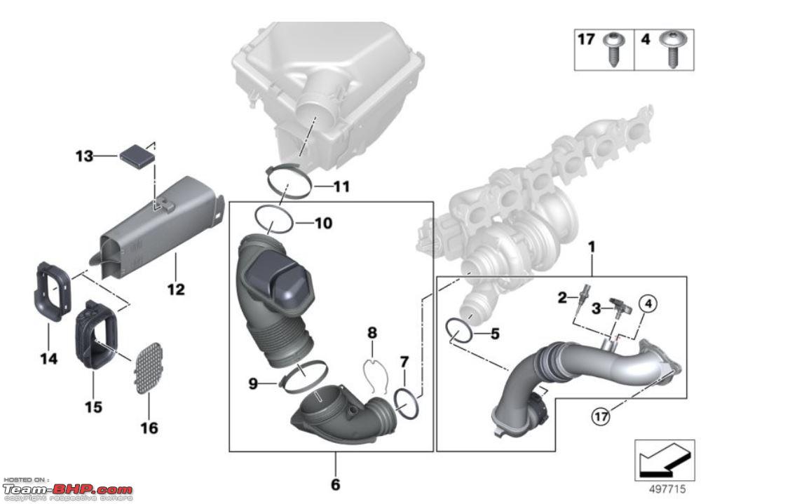

The above mod works for all B47 and B48 F30s sold in India. Your car may be already equipped with the duct so you may be able to make do with just the air scoops.
Better Image of the mod attached below (Parts - 15,16). Part 14 needs to be removed.
