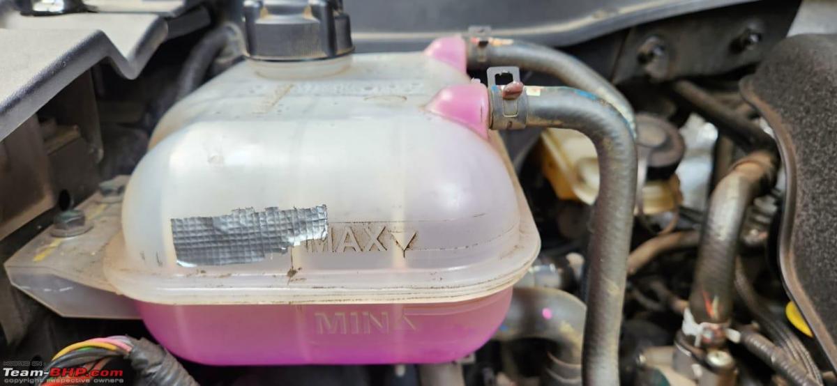

While the battery guy was checking the battery, I suddenly noticed that the Engine Coolant was below the minimum mark in the reservoir. The car was not showing any extreme temperature warning though.
I immediately rushed to the service centre on 09th October and brought this to the notice. There is no apparent leak from any of the hoses or from the reservoir. We filled the reservoir with Coolant and took the vehicle for a test ride. Apparently, the Check Engine light issue seems to have got resolved and I was not able to replicate it after filling the coolant. I am not sure if there is any link between low coolant and a Check Engine System warning.
I was asked to drive the vehicle for a day and check if the coolant quantity is getting low. I had quite a bit of city driving today. When I checked the coolant quantity today morning, it had reduced slightly from what we had filled yesterday. We had fixed a piece of tape to mark the level of coolant in the reservoir as it was slightly off from the Max quantity mark.
Though it was slightly lower than the MAX mark, I took a chance and took the car to work. Did around 50 kilometres with crazy bumper-to-bumper traffic on JVLR and Ladakh like a ride through the Aarey milk colony (Bhpians from Mumbai would know what I mean). As expected, the coolant was just under the MIN mark when I was back home by evening.
