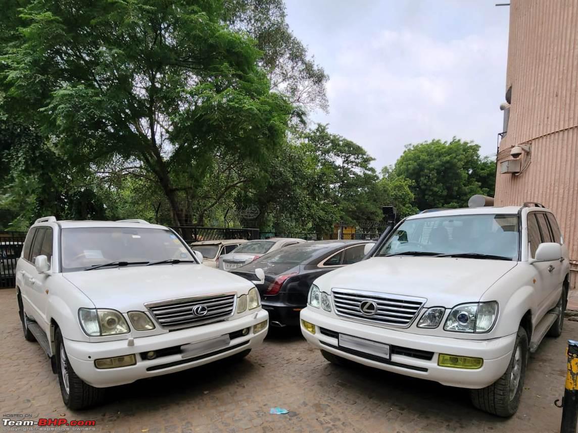

The RR wasn't posted earlier because of the car in front of it:
I also had this lovely LX470 Cygnus (left) in for work around the same time, but we'll save that for another thread.
