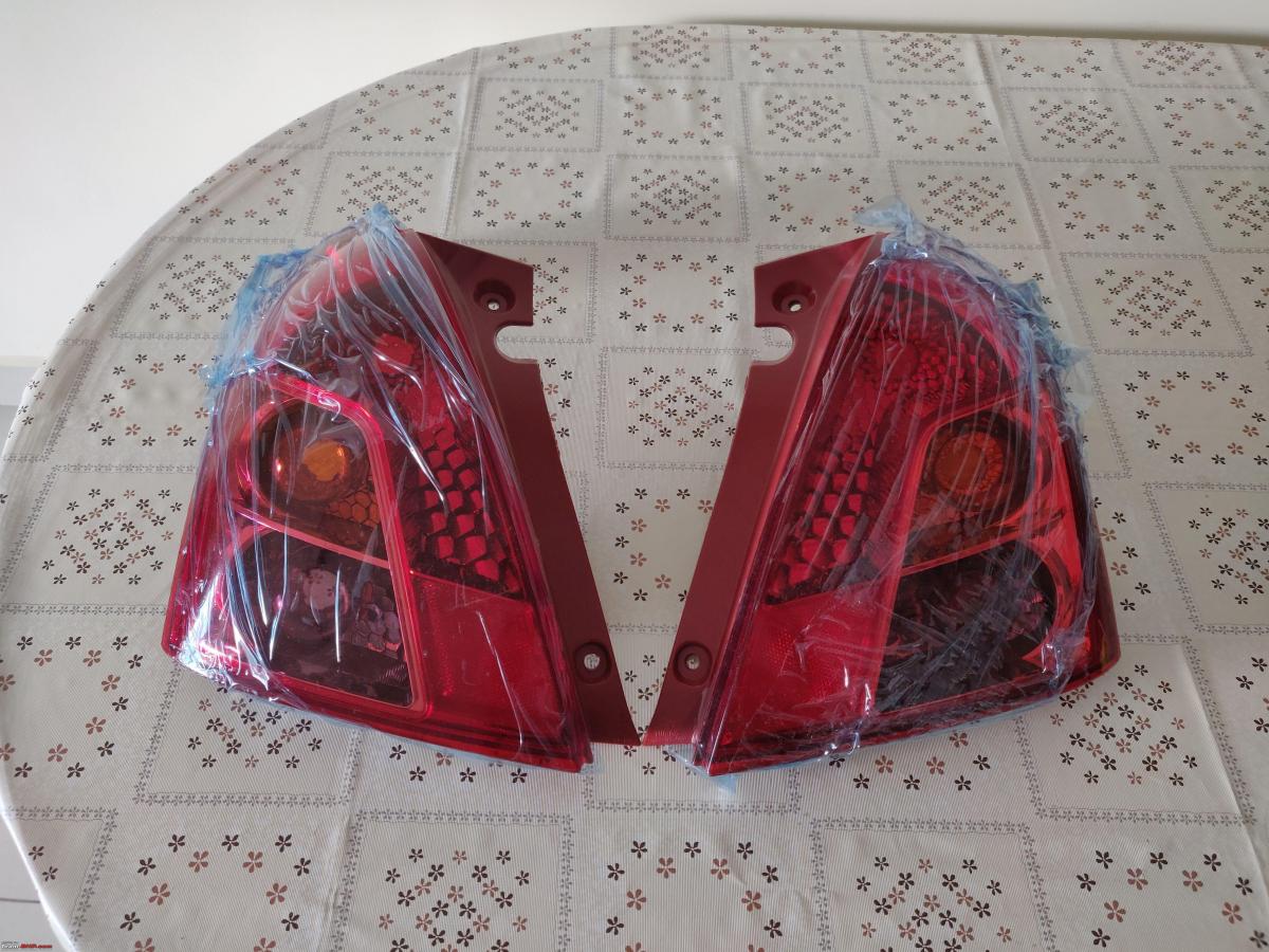

New taillights:
The taillights on my Swift were having water seepage issues and moreover I felt it would be best to change them to the Type 2 taillights ( 2008-2010 Swift). They were of clear lens type compared to my stock taillights. The new taillights were ordered from Boodmo. The rear looks have changed post these new taillights.
Type 1 stock taillights:
Type 2 taillights:
The taillights are manufactured by Lumax:
Final look after plonking in the new taillamps:
