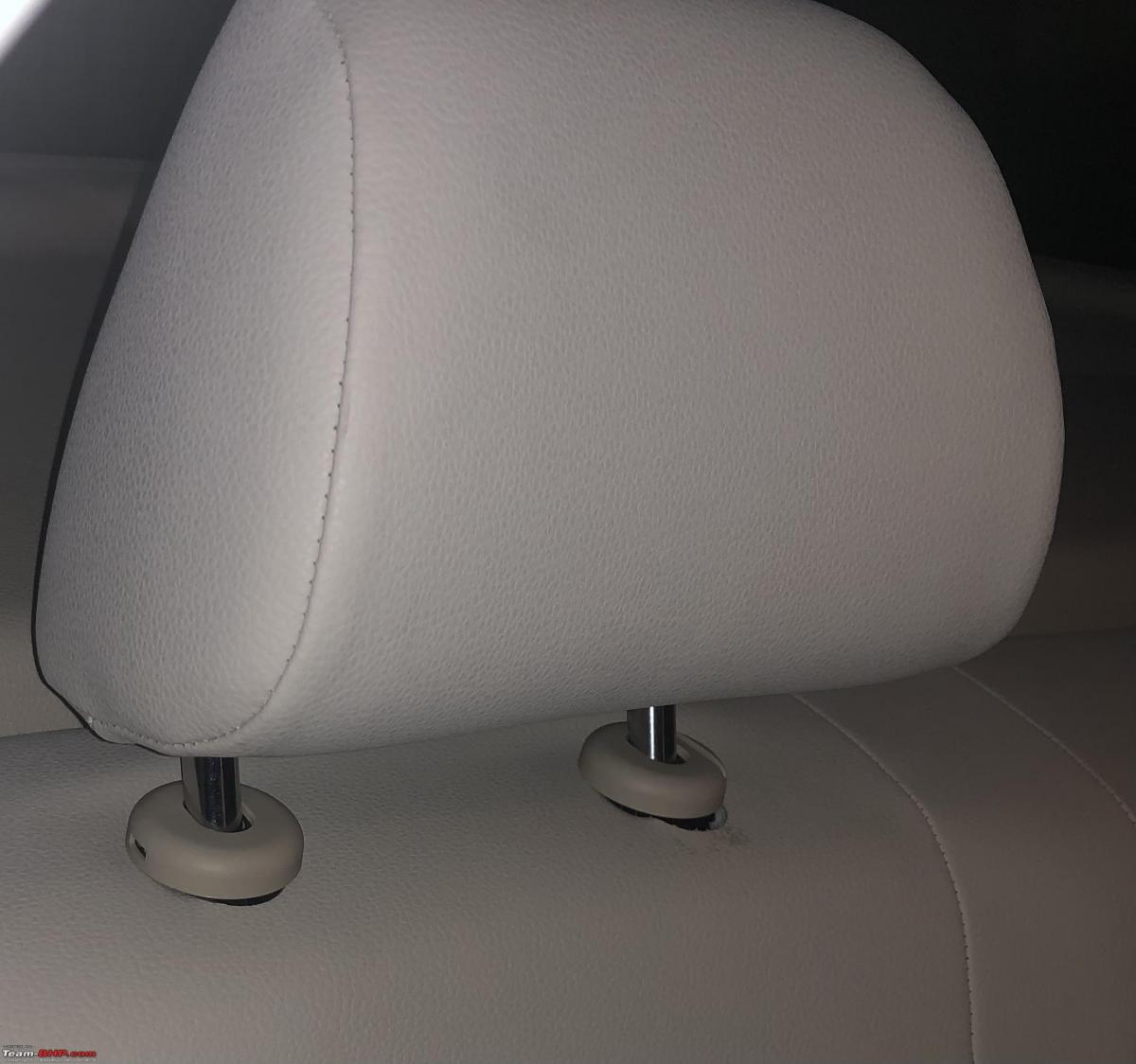

  • Seat covers have not been properly cut & stitched leaving behind ugly gaps exposing a serious quality issue.

  • Did you not check these issues during PDI?
  • Did you take up with VW? What is their say?
I guess almost all these issues can be fixed by their ASS team. Hope you get a fix soon and enjoy the car to the utmost.
