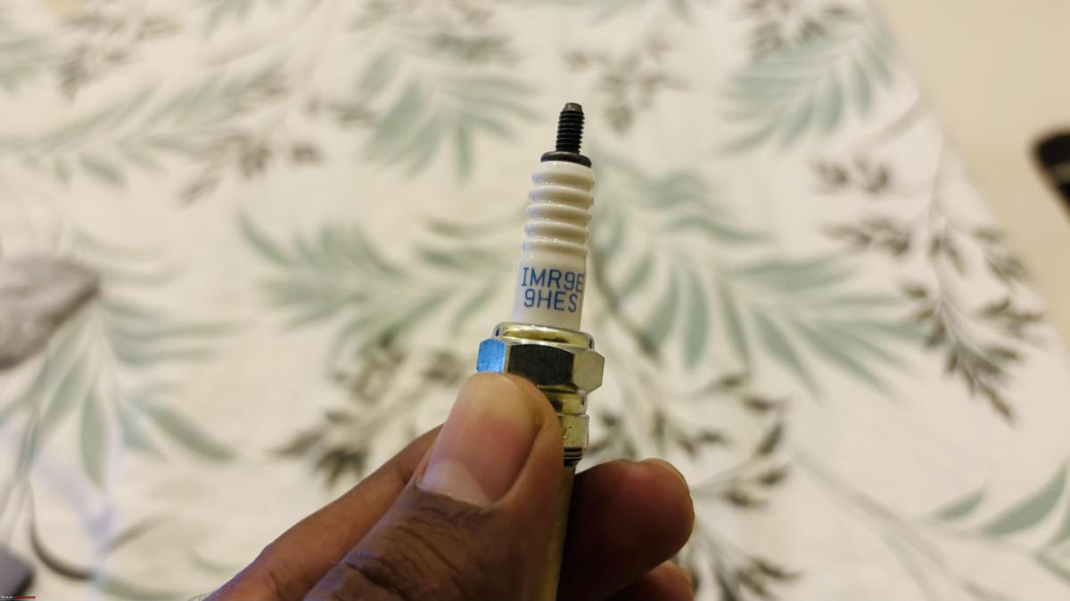

Cleaned the throttle bodies, and air filter and installed new plugs as well. As always, a big thank you to Adhil Salim from Bigwing Topline Cochin, who arranged for the spark plugs as it's really really hard to get these when you need them. I would like to thank HMSI too for arranging the spares for the Blade whenever asked for. Also thanks to Abhishek from Bikers Lounge, Calicut for helping out on my Knitty gritty works on the Blade.

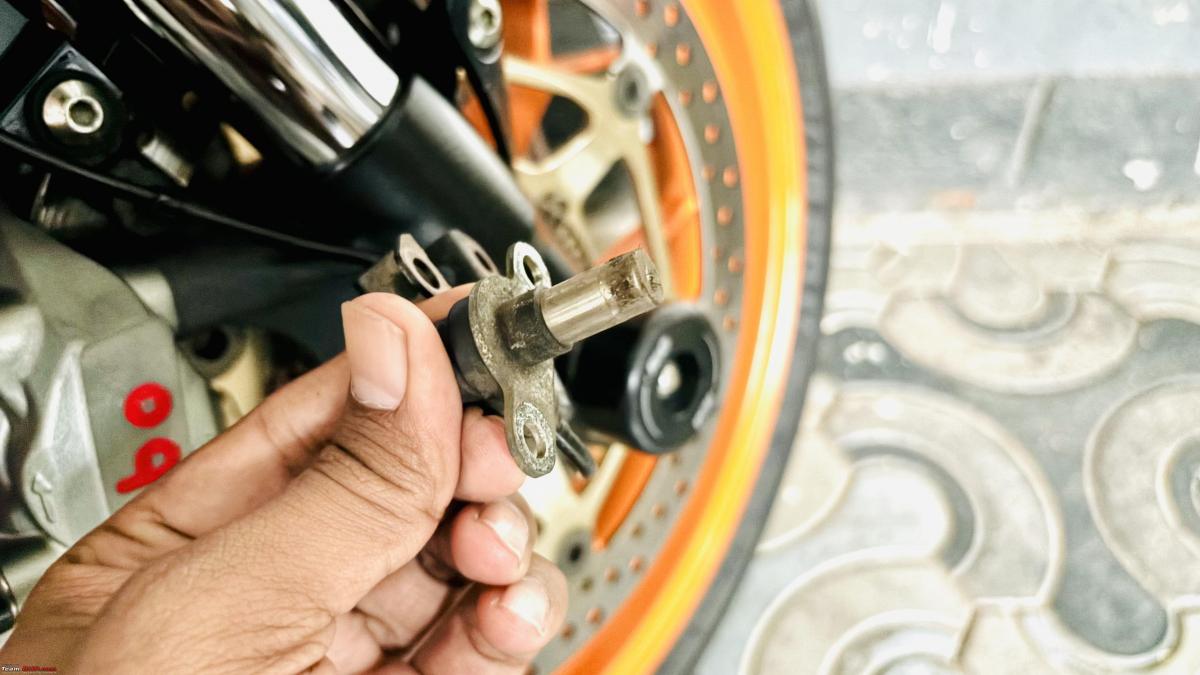

One more thing that was bothering me was ABS switching off at times. This would make the ABS light flash and this phenomenon makes the front brake lose its bite. Removed the ABS sensors to find them pretty muddy and dirty and whatnot. Cleaned them with brake cleaner and the issue has been resolved.
Before cleaning. Greasy stuff on the sensor led to it being unable to send proper signals
