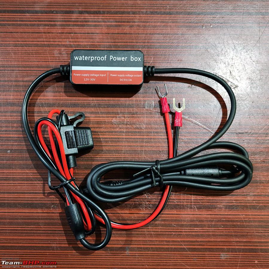

Waterproof power box to connect to accessory power supply (switched). Multiple options were given to power up the device -
BMW R1250GS Adventure Pro MY2020 - Style HP - The Comprehensive Review-bmw-r1250gsa-aoocci-c6-pro-21122024_12.jpg

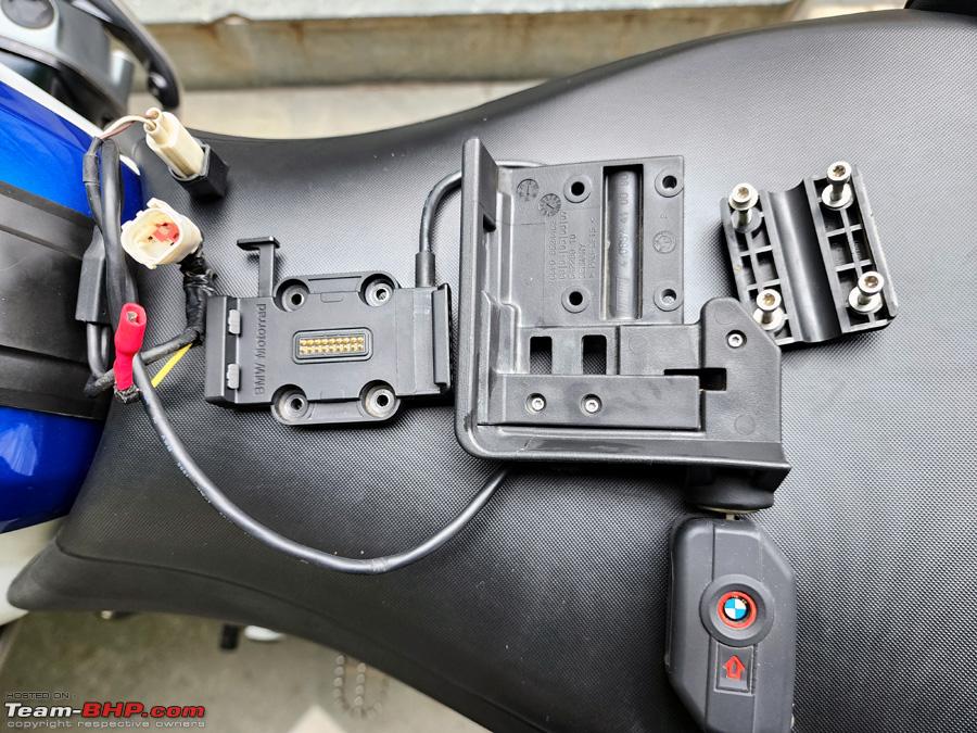

Nav Mount removed in 5 minutes -
BMW R1250GS Adventure Pro MY2020 - Style HP - The Comprehensive Review-bmw-r1250gsa-aoocci-c6-pro-21122024_21.jpg

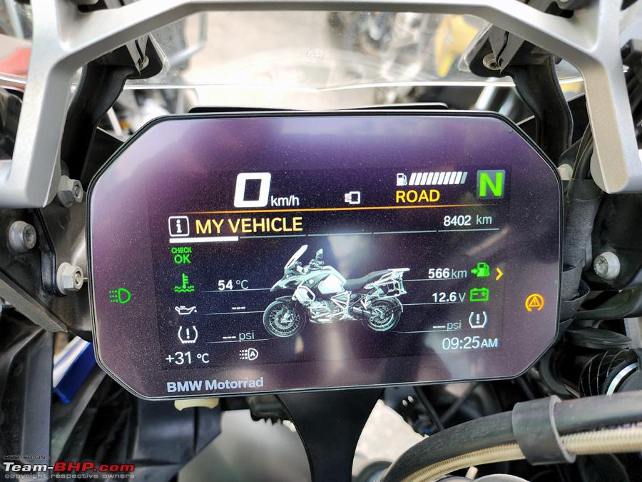

The odo was at 8402kms, so it was exactly 4367kms from the last full service in Oct'2021 -
BMW R1250GS Adventure Pro MY2020 - Style HP - The Comprehensive Review-bmw-r1250gsa-3rd-service-8402kms-13052025_4.jpg

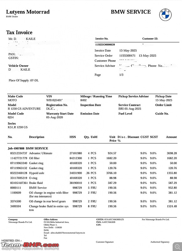

The service advisor advised me that there were 4 campaigns for my bike, which were compulsory to proceed further for the service. Most essential of these were "Retrofitting Rear Wheel Swinging Arm Drainage" of the drive shaft or the cardan shaft, as they call it in BMW terminology and "Checking (Testing) of the Cardan Shaft" and 2nd was the "Replacing Throttle Grip" even though mine was working perfectly, besides updating the software etc. My bike was under extended 5 year warranty till 05-08-2025 and all these work were supposed to be done FREE of cost -
BMW R1250GS Adventure Pro MY2020 - Style HP - The Comprehensive Review-bmw-r1250gsa-3rd-service-8402kms-13052025_7.jpg

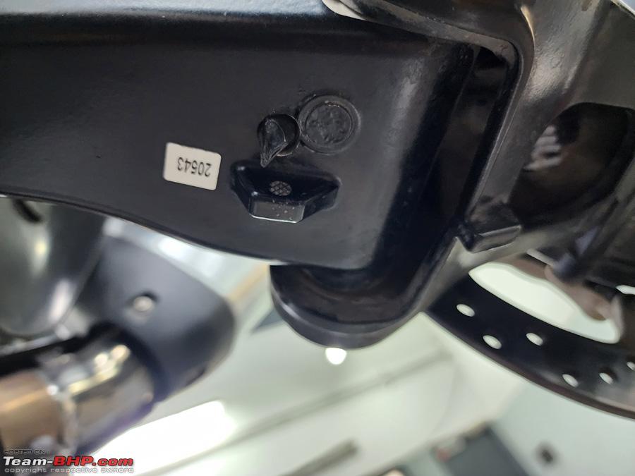

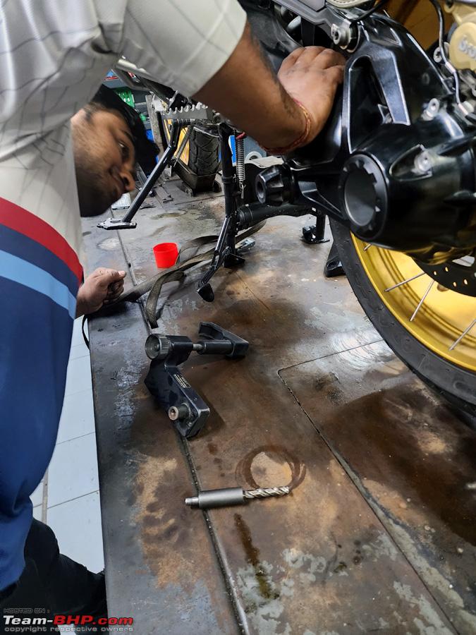

The Hypoid Axle (Gear Oil) drain plug being removed, which uses a new O-ring. Notice the already opened Gear Oil filler plug which uses a copper washer -
BMW R1250GS Adventure Pro MY2020 - Style HP - The Comprehensive Review-bmw-r1250gsa-3rd-service-8402kms-13052025_18.jpg

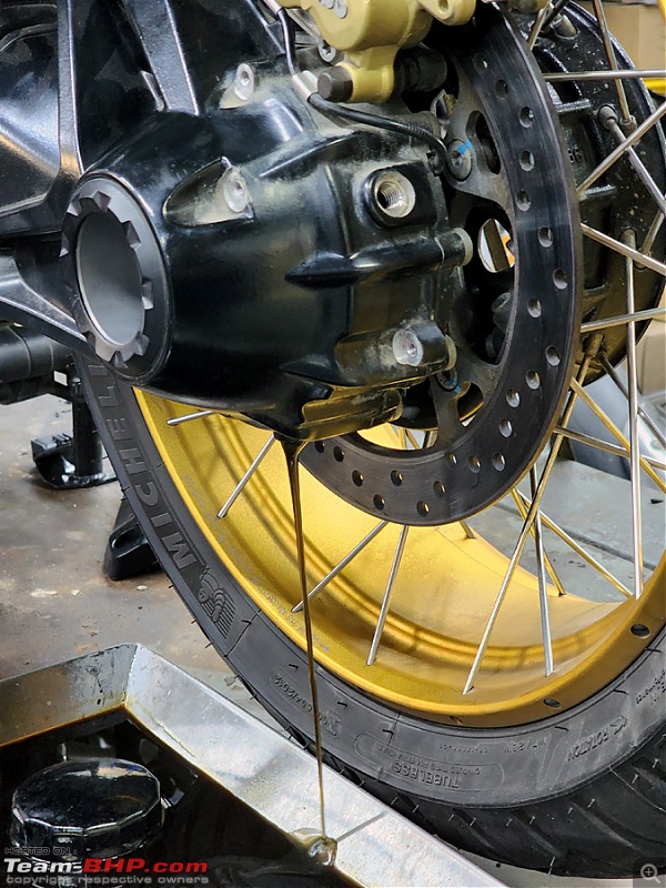

Gear Oil being drained -
BMW R1250GS Adventure Pro MY2020 - Style HP - The Comprehensive Review-bmw-r1250gsa-3rd-service-8402kms-13052025_19.jpg
Exact 180 ml gear (hypoid axle) oil was measured. Its grade is G3 SAE 70W80 GL5 -
BMW R1250GS Adventure Pro MY2020 - Style HP - The Comprehensive Review-bmw-r1250gsa-3rd-service-8402kms-13052025_20.jpg

Time for "Retrofitting Rear Wheel Swinging Arm Drainage", the 2nd pro-active under warranty job -
BMW R1250GS Adventure Pro MY2020 - Style HP - The Comprehensive Review-bmw-r1250gsa-3rd-service-8402kms-13052025_26.jpg
This requires drilling a hole (Oh My GOD!!) with this custom made contraption, with detailed procedure sent by BMW Germany. Notice the drill bit!! -
BMW R1250GS Adventure Pro MY2020 - Style HP - The Comprehensive Review-bmw-r1250gsa-3rd-service-8402kms-13052025_27.jpg
Here is this contraption fitted, to exact specifications, on the rear wheel swinging arm -
BMW R1250GS Adventure Pro MY2020 - Style HP - The Comprehensive Review-bmw-r1250gsa-3rd-service-8402kms-13052025_28.jpg

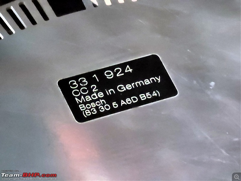

It is Made in Germany by Bosch. BMW doesn't do anything half-heartedly! -
BMW R1250GS Adventure Pro MY2020 - Style HP - The Comprehensive Review-bmw-r1250gsa-3rd-service-8402kms-13052025_29.jpg
The drill bit attached to the specified drill -
BMW R1250GS Adventure Pro MY2020 - Style HP - The Comprehensive Review-bmw-r1250gsa-3rd-service-8402kms-13052025_30.jpg

Exact 'Made in Germany' Rubber Bung for this hole is supplied. This helps in draining any moisture or water that may enter the swinging arm while river crossings (which I never did and will probably never do!), and thus preventing any corrosion of the cardan shaft (drive shaft) which CAN lead to catastrophic failure (and law suits...Lolz) -
BMW R1250GS Adventure Pro MY2020 - Style HP - The Comprehensive Review-bmw-r1250gsa-3rd-service-8402kms-13052025_33.jpg
Nicely fitted in position with super glue. BTW, the newer bikes come with this already done from the factory -
BMW R1250GS Adventure Pro MY2020 - Style HP - The Comprehensive Review-bmw-r1250gsa-3rd-service-8402kms-13052025_34.jpg

Again, Made in Germany, by Bosch -
BMW R1250GS Adventure Pro MY2020 - Style HP - The Comprehensive Review-bmw-r1250gsa-3rd-service-8402kms-13052025_37.jpg

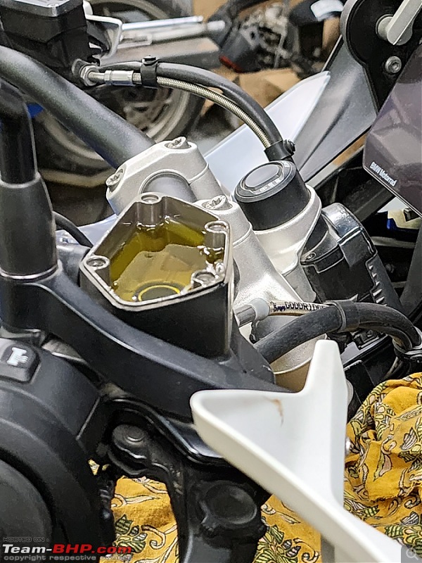

Time for a full Brake Fluid Replacement, which needs to be done every 2 years. A proper drain bottle was used so as to avoid introducing any bubbles in the system, which may cause mushy brakes -
BMW R1250GS Adventure Pro MY2020 - Style HP - The Comprehensive Review-bmw-r1250gsa-3rd-service-8402kms-13052025_46.jpg
All Brake Fluid was replaced and topped up with the fresh. Notice the colour of the new oil in the front brake fluid reservoir -
BMW R1250GS Adventure Pro MY2020 - Style HP - The Comprehensive Review-bmw-r1250gsa-3rd-service-8402kms-13052025_47.jpg

Here is the Total Service Cost I paid and all the parts charged -
BMW R1250GS Adventure Pro MY2020 - Style HP - The Comprehensive Review-bmw-r1250gsa-3rd-service-8402kms-13052025_51.jpg
A sum total of Rs. 12,771/- (add Rs. 3300/- for the rear brake pads procured by me). Not bad BMW, not bad at all!! -

8484 kms on the odo back home. All Checks were OK on the screen -
BMW R1250GS Adventure Pro MY2020 - Style HP - The Comprehensive Review-bmw-r1250gsa-3rd-service-8402kms-13052025_55.jpg
