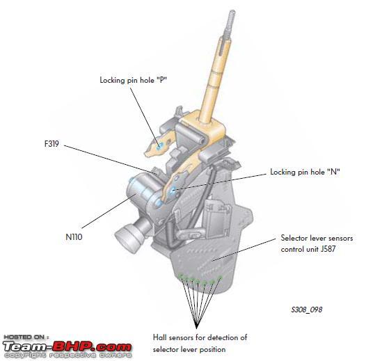

The issue mentioned here, from what I have understood, of not being able to move the gear selector or the selector not slotting into "D" mode could be possibly linked to what is called the "Hall Sensors" and the associated wiring harness.
Refer to the below diagram:
Quoting from this post.
The primary function is to register the position and make it available to the mechatronic unit via the CAN bus. Based on the signals, the control unit implements the driver's D or R or S or Tiptronic command and controls starter release.
If the control unit detects no selector lever position due to a malfunction of the senders or the solenoid, then both the clutches are opened. The cause has been apparently attributed to the gear shifting wiring harness in the assembly. The issue around this malfunction is noted by a transmission warning code.
The primary resolution offered has been to repair the harness else suggest a complete replacement of the shifter assembly.
