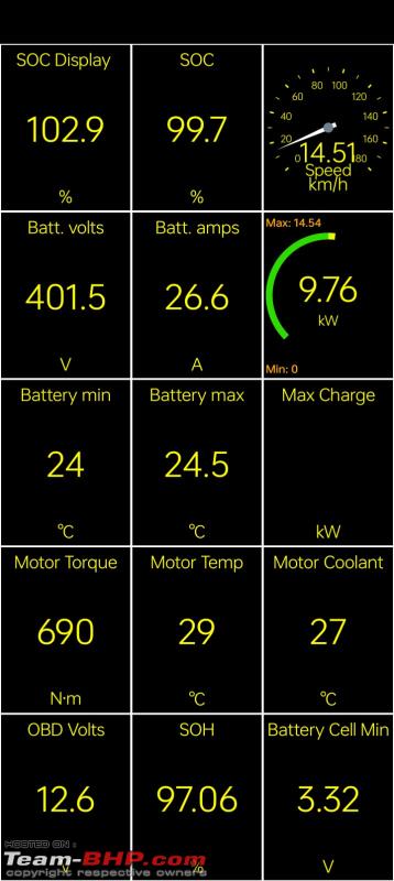

In the LFP battery cars of MG, the SoH calculation by default is a time based one. Everyday, it drops by 0.01 irrespective of whether the car has been used or not. That's because in LFP batteries, computing SoH is very hard and hence there is a time based counter which keeps decrementing SoH which in turn reduces your range as well. But all of this is software driven and is not connected to your actual battery health.
Turns out that there is a way to do an actual SoH measurement and it is typically triggered by taking the battery below 20% and charging all the way to 100% on AC.
My hypothesis on what is happening is the following:
The BMS keeps track of how much energy has been consumed from the battery from the time it was full. Suppose the SoH is 95% that means the battery is able to hold only 95% of it's original capacity. When you take the battery to a low SoC, it's able to see how much energy has been dispatched and how much energy is left in the battery (Voltage curve is linear here and hence it works).
If the energy dispatched + energy remaining > SoH * battery size value, the SoH is recomputed.
I have managed to bump up my SoH several times by doing this. I was able to track this through my OBD.
Before starting the charging session:
After finishing the charging session:
As you can see the SoH went up from 96.69% to 97.06%.
In summary, in non Tata EVs, I do think its good to take the car below 10% or 20% once in a while especially if your car has an LFP battery.
