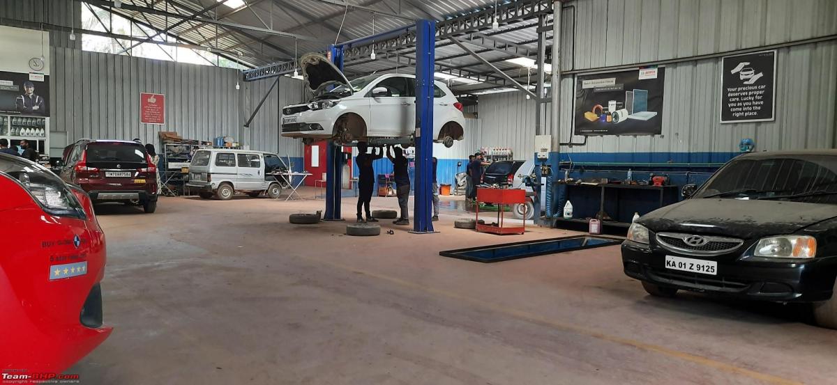

I just serviced my Baleno (1.2L petrol manual) at 49915 KM (~50,000KM service) and want to give some updates. The car is now 4yrs and 4 months old.
This time, I skipped the Maruti Service center and went to Bosch service center in Sarjapur. I usually spend around Rs 8K - 10K per service at Maruti (not NEXA) service center. I find Maruti service centers charge around 50% of the service amount as labour charge which is quite high. For a change, I want to service the car through these garages.
This is the odometer reading after I completed the service and returned home.
Despite what people think about Maruti cars and spares, getting some of the spares are not that easy. Getting 0W20 oil is not easy, for example, even this is not available in MGP stores. I checked two MGP stores, one in TN and one in KA and in both places they are not keeping this in stock. It is not possible to get it from service center as well for obvious reasons. I am able to procure one from Boodmo.
Cabin AC filter change: This one I did. It is a bit fiddly but able to do it. The roads are in bad shape near my home and AC filter gets dirty rather quickly. I also noticed small bits of plastic in the filter which the service guy pointed out that it is because of rats. I just ordered 3M rat spray.
Brakes are honestly rubbish on the car. It is pretty evident that Maruti spent a lot of time making the car light for fuel efficiency and features while completely ignoring safety which includes the thin sheet metal. I was looking for good brakes, I changed the stock brake pads to another set of stock pads during the 30K KM service and done some brake bleeding too, still, it was rubbish. While searching on Google, I came across EBC brake pads on this website.
I am not sure whether these are genuine brake pads or some fake Chinese stuff. These EBC Brake pads are twice as expensive compared to stock brake pads but I want to give them a try.
List of items I ordered and received for 50K service (some of them may not be needed for 50K service):
At Bosch service center, Sarjapur, Bangalore.
Engine oil, coolant, and brake fluid changed
Stock vs. EBC brake pads. The stock pads still have sufficient meat in them since I changed only at 30K service. I will bed the new brake pads for a few hundred km and then I will give my opinion on the EBC pads.
Spark plugs are in good nick but I still changed them.
Engine air filter. It is much dirtier than it appears to be in the photo.
Items ordered through Boodmo:
  • Cabin AC filter
  • Engine oil 0W20
  • TVS Girling brake caliper grease
Items ordered through local MGP store:
  • Engine oil filter
  • Brake oil
  • Coolant
  • Engine drain plug
  • Engine drain plug washer
  • Spark plug
  • Transmission oil plugs (will be using for future transmission oil change)
Items ordered through Motospunk:
Initially, the service advisor was a bit against changing the brake pads to EBC brake pads. He mentioned that many owners complain that EBC causes a lot of screeching noise (they also sell Bosch brake pads maybe that is why) etc. I am not sure about his claim. I hope the caliper grease on the back of the pad will resolve the screeching noise. I will run for a few 100KM and will see.
Some of the service guys don't want me to stand near the car during the service. They want me to sit in the "customer lounge". I did not oblige and I was near the car throughout the service, around 2.30hrs.
Overall, not bad and the service is comparable to Maruti service centers.
The service charge is Rs 2700 which is good, but I have not gone for water wash or interior cleaning.

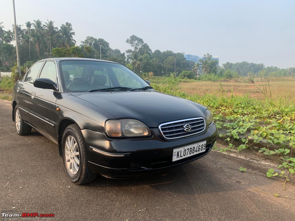

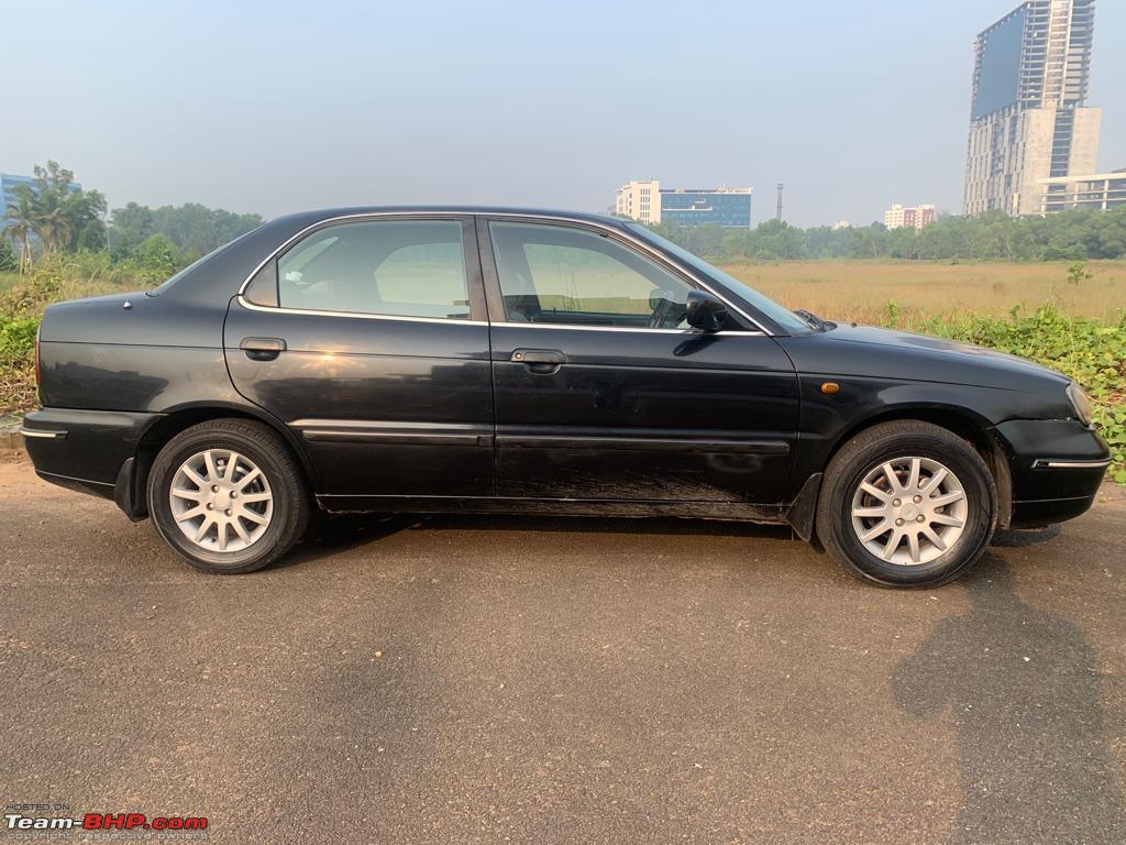

Restoration plans for a 2006 Maruti Baleno done 1.2 lakh km
The idea is to keep the car as stock as possible but incorporate mild performance modifications & revive the interior.
BHPian zacs recently shared this with other enthusiasts.
It was just another morning, my lazy eyes were wandering while sipping the tea. The Ciaz is looking beautiful in its Nexa Blue with slight fog in the background. The black Baleno, the car that served us from 2006, is next to it. It was spellbinding how it was when it came home back in the day. I still remember how excited I was. The car in Midnight Black was a treat then.
It has lost most of its charm over the 120k km it has already put through. The paint is faded, the body lines are not aligned, the interior is waning. The headlights hardly throw any light, the spoiler is lost to a truck back in 2014. Only by crop luck and my overconfidence, this one passes for another 5 years in November 2021. I took it for a spin and on that drive, I decided to give this old partner a new life it well deserved.
This is going to be a resto mode, the idea is to keep the car as stock as possible like it is now but is open to some mild mods to increase the performance, drivability and revive the interior to its original glory. Here is my current list.
  • Replace the clutch plate.
  • Remove the LPG and all the wiring harnesses that came with it (It was very common then to install the LPG kit straight after taking the delivery, though this one hardly ran any kms on LPG).
  • New bigger drilled or slotted rotors for better brakes, new pads and shoes all around.
  • Fix leaks if any.
  • Change all the lights.
  • Cold air intake.
  • Free flow (Automech have a silent setup in SS).
  • New front and rear bumper.
  • NGK Iridium spark plugs.
  • Lower 3 inches.
  • Spacers to make the wheels flush to body line (Want to keep the original 14-inch alloys after restoring it).
  • Add spoiler.
  • Dress the engine bay and boot (It’s a disaster now).
  • Remove the shabby seat covers and revive the old cushion.
  • Fix any rattling and add dampening.
  • Full on body works, align the lines and repaint the same midnight black.
Here is the car the morning I took it for a spin.
