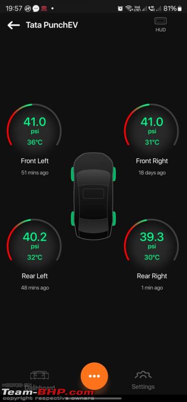

Faulty Sensairy TPMS replacement
Approximately a month ago I'd noticed the Front right tyre was not showing updated readings on the app. I suspected the sensor may have gone bad, but had decided to monitor it for a while.
On the 18th day, I messaged Sensairy customer support and they shipped out a replacement sensor under warranty.
I got this installed without much ceremony for ₹250 - this included the necessary balancing charges, at a local tyre shop near home.
Here's the faulty sensor readout
And here's the tyre getting attention
Job done in about 30 minutes and I was on my way.

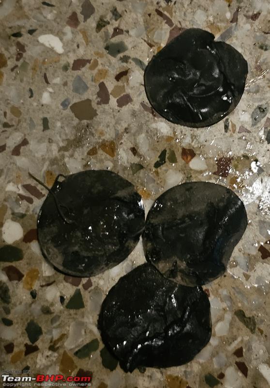

Punch EV owners reported, paper stickers glued on top of holes in the front and rear wheel wells , were the only protection against floods in the cabin!
One of them had in fact, reported flooding due to this issue in his car.
In Ruby's case I found these paper stickers in both rear wheel wells. Behind these innocent-looking paper stickers , were holes that opened into the cabin floor (and eventually carpet). If these fell off, and I passed through standing water, I could have easily gotten the carpet soaking wet.
Four holes are covered by cheap metallic paper fixed with Heatex glue.
And that wasn't all!
Closer inspection revealed all four were creased and much the worse for wear and tear, due to being attacked by mud and dirt , every day!
They were about to peel off—and in fact they did!
Here they are, after I removed these with relative ease. Yuck!
Notice how I exposed the hole with ease! Imagine the elements going to work on these stickers!
I patiently removed all 4; one was already perished, and I wasn't about to give Tata Motors the benefit of doubt, by leaving the rest there. Before installing the grommets, I washed the area clean.
Removing Paper stickers and replacing them with proper rubber grommets
Here is one such grommet, neatly installed.
One can only wonder—what these holes were for?
Why didn't Tata Motors spot weld these holes close during the manufacturing process?
Rubber grommets are not a permanent solution, but yes, they are cheap.
It also means I will need to remember to physically inspect and replace these grommets every 3 months and more frequently when it rains!
