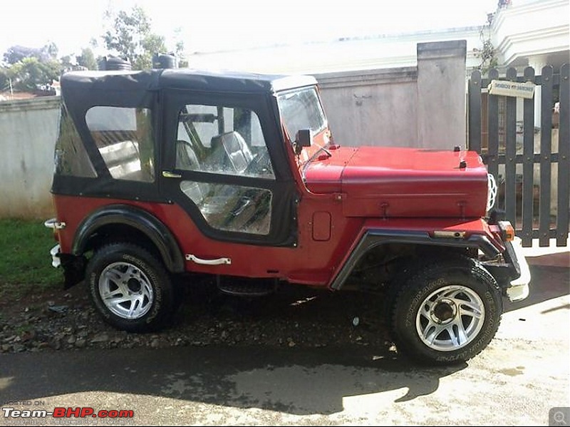

Guys,
Anyone aware of where I can get the same design wheels from Hijoin/HR in 7J, 15 inch. Or a similar design from any other manufacturer?
Its a bit urgent. My vehicle is literally standing on blocks now. Need new wheels asap.

Originally Posted by beejay View Post
Guys,
Try contacting SAI MAG WHEELS on their website or otherwise, they are the distributors for Hijoin/HR & some other brand/s
I did that, all the 139.7 PCD wheels are either 8j or 8.5
Here is the link for a 7J with 139.7 PCD from the store mentioned by Ricky
Mag Wheels,Automotive Wheels,Aluminum Alloy Wheels,Car Chrome Wheels,Supplier
Cheers,
Deepak
Cheers,
Deepak
Thanks Deepak, unfortunately this is the only one available, I guess.
