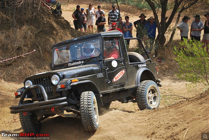

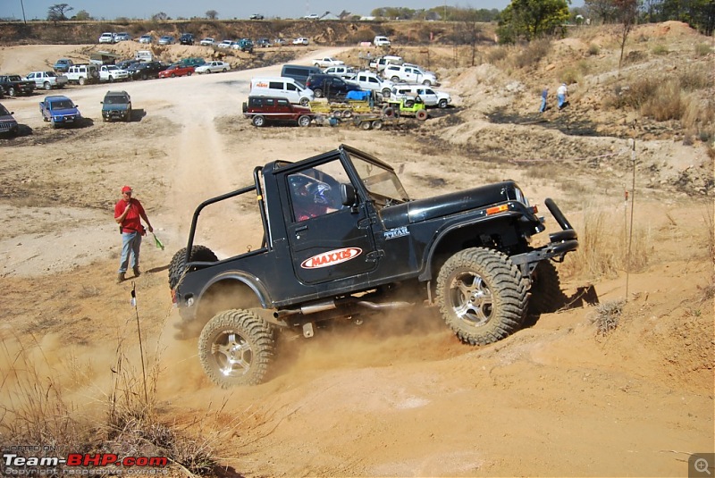

Some feedback and experience with Maxxis
When I started the Thar project, I really wanted to go big and wild, so I got a set of Maxxis Mudzilla 31*11.5*16 as they really looked mean and rough, but as most other things in live, its not always those pretty things that works the best.
One word... disappointed... The Mudzillas is very, very disappointing!
The side walls on the Mudzilla`s is extreme, so hard even when you deflate the tyres 0.7 bar - the tyres does not flex and the side walls & thread part stays very rigid. This then cause the tyres to have less grip due to a lack of flex.
Also these tyres are noise... very very noise on tar over 80km.h and very loose handling over 100km.h so that you getting scared looking at 120km.h ..... then I must mention... at this speed you can only hear one thing! The Tyres !!!
On the possitive side, if you get a set of these and drive in very rocky conditions where tyres are cut easily or looking for a tyre that will almost never puncture.
I then fitted a set of Maxxis Big Horns, 265/75R16.... Huge different, much better handling on tarr and not even close as noisy... still noisy but this is still mud terrain tyres, but in my books very acceptable.
But saying this, the Thar was not build to drive around on tarr roads. The Big Horns deflate great, at 0.7 bar comparing to the Mudzillas these get very flexible, ensure your traction increase a lot.
In a nutshell; dont just look and make your decisions based on the aggressive thread pattern of a tyre, ensure you do your homework before buying the wrong tyre for your application.
