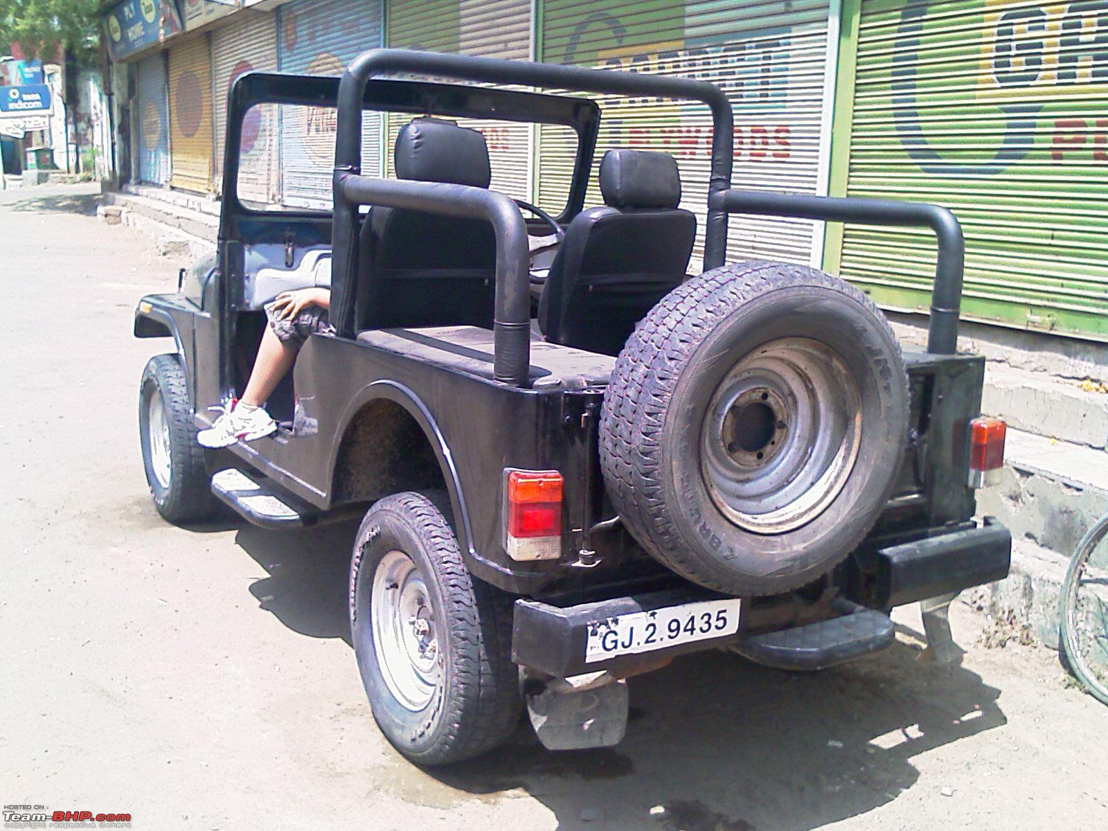

Got the trepadors installed on the HR 7J R15 alloys. I am VERY PLEASED to say that there is no touching/rubbing even at extreme lock. Steering effort seems to have reduced slightly (possibly due to the negative offset) and I am able to park the car into it's rather tight parking spot without any issues.
As you can see I am REALLY happy with how it has turned out...a lot of running around was involved but it was worth it in the end. Now I only have to see how my new tires perform during the upcoming OTRs.
FYI the Alloys were picked up from Shalimar @ CST Kurla. I paid 18000 for the set of five alloys. These are HR (god alone knows if they are authentic or fake) 5-spoke black-brushed metal finish with a 4x4 etched in black on one of the spokes in each wheel. He offered me Rs.2000 for my set of 5 Gypsy OE rims but I plan to fit HT tires on these for daily use and save the Trepadors for the OTRs.

Some pictures for now:
