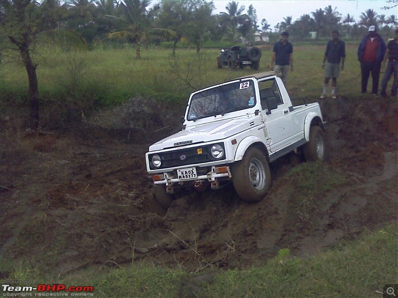

Am updating this thread after a long time. This is to give a sort of an update on how the locker is holding up and there have been 2 terrains which I had not done after the locker install.
The good part:
  • The traction by the lockers justifies it price and getting it installed. At the TG-Halli OTR, previously I had to kind of do it in momentum (the way up) and even in the rocks etc it had to be done in slight momentum in TG-Halli terrain. Also, I can clearly remember tyre spin earlier in that terrain.
  • This time in TG-halli OTR, i was able to 'crawl' (again in relative terms) up the trial and no need for gaining momentum.
  • In slush at Sarjapur OTR: This was the first time I was venturing into whatever slush/muck after the lockers.
    • The traction that lockers gave was again amazing in that terrain. the fact that I was stuck and was even able to move a bit front/back was just due to lockers.
See this set of pictures.
Gypsy on Steroids: Lockers installed and tested now-image_253.jpg
If the right front was not digging in (along with the leaf/suspension) I am sure I could have made out from this situation:
Gypsy on Steroids: Lockers installed and tested now-image_255.jpg
Now the bad part:
  • The stress/torque on the t-case put by the locker is huge. This means that the t-case beadings need to be strengthened. I have broken a beading and is currently a weak link.
All this while the lockers have been giving me +ve traction and my tyres have been letting me down. I have MRF Zigma GP tyres. You can't get more stupid than that man. Just for the lockers sake I may need to out in better tyres.
After all, what will lockers do if the tyres don't hold up?
