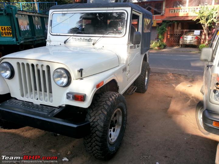

Thar di photos after fitting new differentials and winch plate

Originally Posted by uniquecon6199 View Post
Got the front differential converted after lots of running around
Did you change to the Bolero (57") Track. I have been seriously contemplating this as the originial turning radius is pathetic. I tried to adjust the steering stopper bolts, but the dampers started to touch the caliper bolts. Overall very poor design by Mahindra. But since I didn't want to do any invasive surgery on a new Thar, I ended up puttting spacers to bring the track to about 55 inches. The alloys are very light and spacers heavy but over all the weight on the wheel is only slightly more than OEM still rims with NDMS tires.
hope you changed the brake lines!
ya i did put 57'' bolero diffs ,turning radius now is superb,ans steering is as good as PS.main reason for conversion is 44-9 crown ,waiting for rear diff of bolero with right side orientation once that comes vehicle will get ready.
44/9 crown/pinon ratio can be done on original diffs as well, but 57" track gives you much more stability and fantastic turning radius which is a boon off-road and on -road.
No model of Bolero/Pick up etc with the 53" rear track comes with right side diff orientation. The only vehicle with the right side diff orientation comes from the Army NGCS 550 or the Mahindra Legend. This rear axle is full floating with 53" track and right oriented diff case. What I did in my earlier jeep was to take a regular left offset Bolero axle and swap the tubes. This can be done at a good lathe that repairs lorry axles/differentials.
In a new Thar, I don't have the heart to do a lot of these mods, so I just stuck with spacers since it is reversible easily by just removing the spacers.
i am waiting for my differential to arrive i think it is from army ngcs .will post pics once it arrives.ya tried a lot in aftermarket but could not source a right oriented differential with 53'' track .

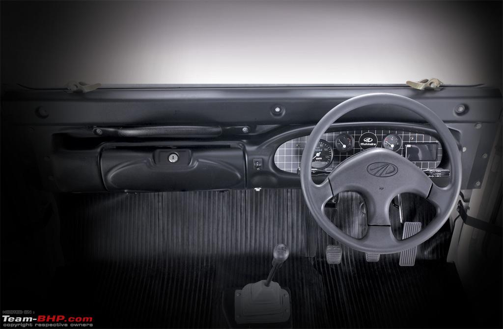

Adding some more pics. Please not that I am not showing off my vehicle, but Thar DI 4x4 is a rare animal and just adding pics for the benefit of people who live in BSIV cities who do not have access to info on Thar DI 4x4.
Please clarify my one doubt.
Is it the correct position of steering? I mean with front tires in straight position?
When any vehicle’s front wheels are straight position, the steering should be like this.

@(Alok): Think its in tyres straight position. I know this because I've seen Steerings in Mahindra jeeps are never precise.
Attachment 996185
Pic #2 is more correct.
@AWD, the position can be adjusted. You could have it any way you want it, but most people it is easier if the steering wheel is aligned to point forward- a sub-conscious awareness of alignment of the steering wheel with the direction of the vehicle.

The second picture position is most suitable.
Notice how the view of the instrument cluster is obstructed in the first picture.
Tyres are turned. The normal position is as in the second pic from the brochure/mahindra website. Just noticed that they have poorly photoshopped the floor carpet like it is fully carpeted. See difference with original pic.

2nd pic is correct in the northern hemisphere. In Australia the first pic is correct from the autumnal equinox until the end of the regular NBA season.
Actually, if you drive with your hands placed at the "ten minutes after ten" position, you will find that the spokes per pic #1 get in the way and the wheel is top heavy. I have the same steering wheel in my Invader and I keep it ala pic #2. I also get the buttons on my shirt/jacket sleeves caught in the infernal horn button gap. I have killed 43 pedestrians because of this. The police want me to alter my clothes but I tell them I am a free man in India and I refuse to go buttonless. A man has to stand up and be counted in this world.
