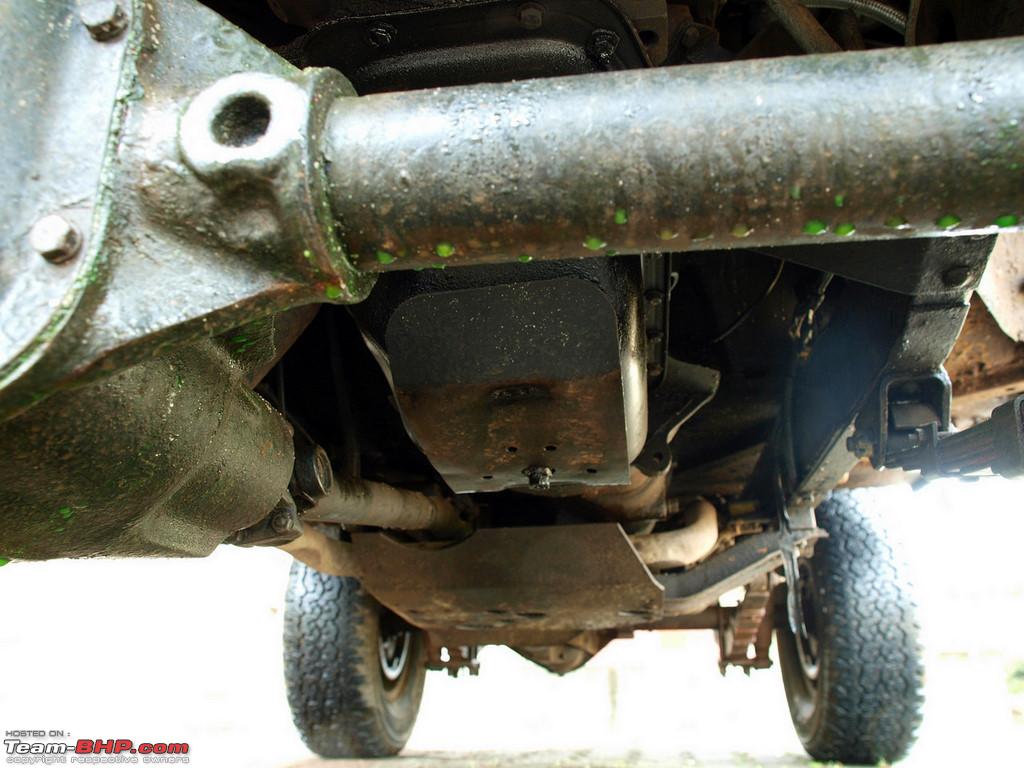

Also see the skid plates added by the previous owner.

BTW, from the pics, it seems it's time for your wheel alignment to be done.
