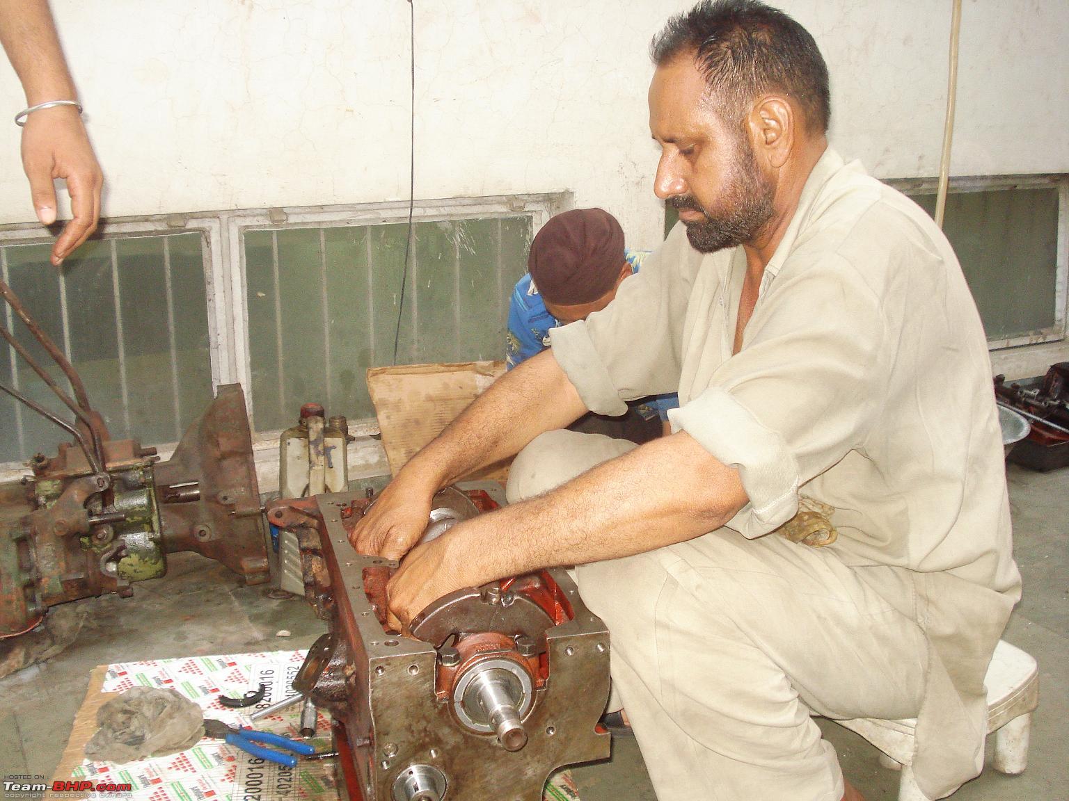

This update has been long due. I was not able to write it up partly due to bad health plus I also got occupied with some other things. So here is a brief account of what all has been done during this period. The mechanicals have been almost completed. The brakes are functional now, thanks to a brand new overhauling kit installed in the original master cylinder, some new brake lines and brake fluid. The gearbox was cleaned up thoroughly inside-out . As there were no major signs of wear and tear or excessive play in the gears, a new packing kit and some anabond sealing agent was all that it required to complete the job. The engine has been assembled back. Just for a reminder it now runs on Standard size pistons. Most of the critical components have been replaced with new quality replacement parts. The Distributor was also in a very bad state and was thoroughly cleaned up. We have replaced the old Point, Condenser and the metal plates on which both of these are mounted. A new Rotor was also bought as it was missing. A brand new set of Spark plugs, plug wires and ignition coil was also bought because of the obvious reason (most of these were missing from the vehicle). Also replaced was the mechanical fuel pump, as kit for repairing the old pump was not readily available. It took Jarnail Singhji about 2 days to work his magic on the motor. He diligently placed and tightened each and every part together to ensure that the job was done perfectly. The engine was started for the first time on Saturday. It was amazing to see and hear the beast breathing life again.
The Chassis frame has also received a coat of paint and is awaiting the final assembly. The work on the body tub and other parts was held up because of Eid celebrations. So it was another excuse for my painter to flee to his home town. He is being eagerly awaited to return and complete the work. I took some pictures during the engine assembly process. Here they are:
