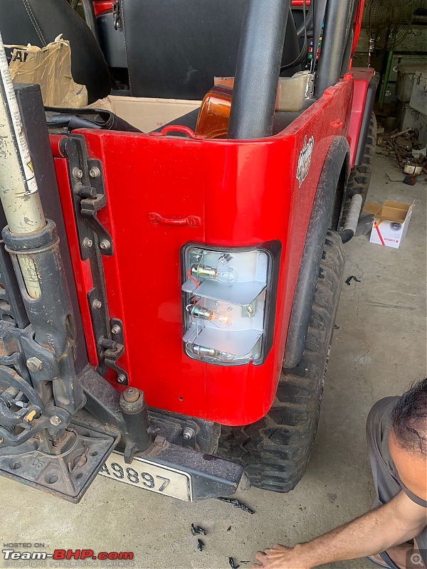

First thing was to change the headlights. The previous owner had changed to a black light with rings as you see in the pic above. That needed to go asap.
Went to Atlas motors at Opera House and picked up all the lights. Rather change everything. And it's not expensive. 1500 for front, rear, side and indicator housings with bulbs. Got box delivered to Allan's garage:
An impulsive buy - 1999 Mahindra Classic; Sold and bought back after 10 years!-lights.jpg
Lights changed:
An impulsive buy - 1999 Mahindra Classic; Sold and bought back after 10 years!-changed-headlight.jpg
An impulsive buy - 1999 Mahindra Classic; Sold and bought back after 10 years!-rear-light.jpg

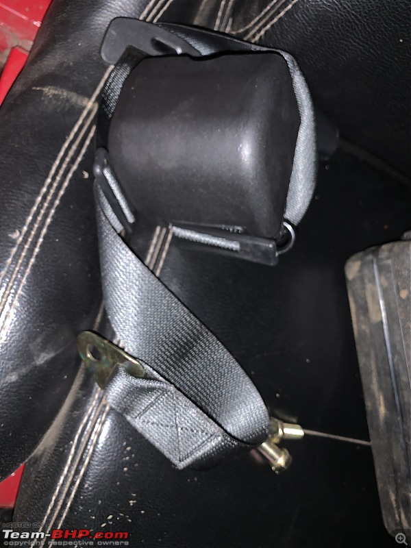

The seat belts were dusty and the locking didn't work. I guess since the cover was missing, it got damaged due to the elements. In an open jeep with my son, this wasn't a chance I would take.
Old:
An impulsive buy - 1999 Mahindra Classic; Sold and bought back after 10 years!-01a-old-belt.jpg
Atlas motors supplied the belts. Rs. 600 for a pair - original:
An impulsive buy - 1999 Mahindra Classic; Sold and bought back after 10 years!-01-seat-belt-brand.jpg
The new belt:
An impulsive buy - 1999 Mahindra Classic; Sold and bought back after 10 years!-02-new-belts.jpg
Fitted:
An impulsive buy - 1999 Mahindra Classic; Sold and bought back after 10 years!-03-new-belt-fit.jpg
An impulsive buy - 1999 Mahindra Classic; Sold and bought back after 10 years!-04-new.jpg
