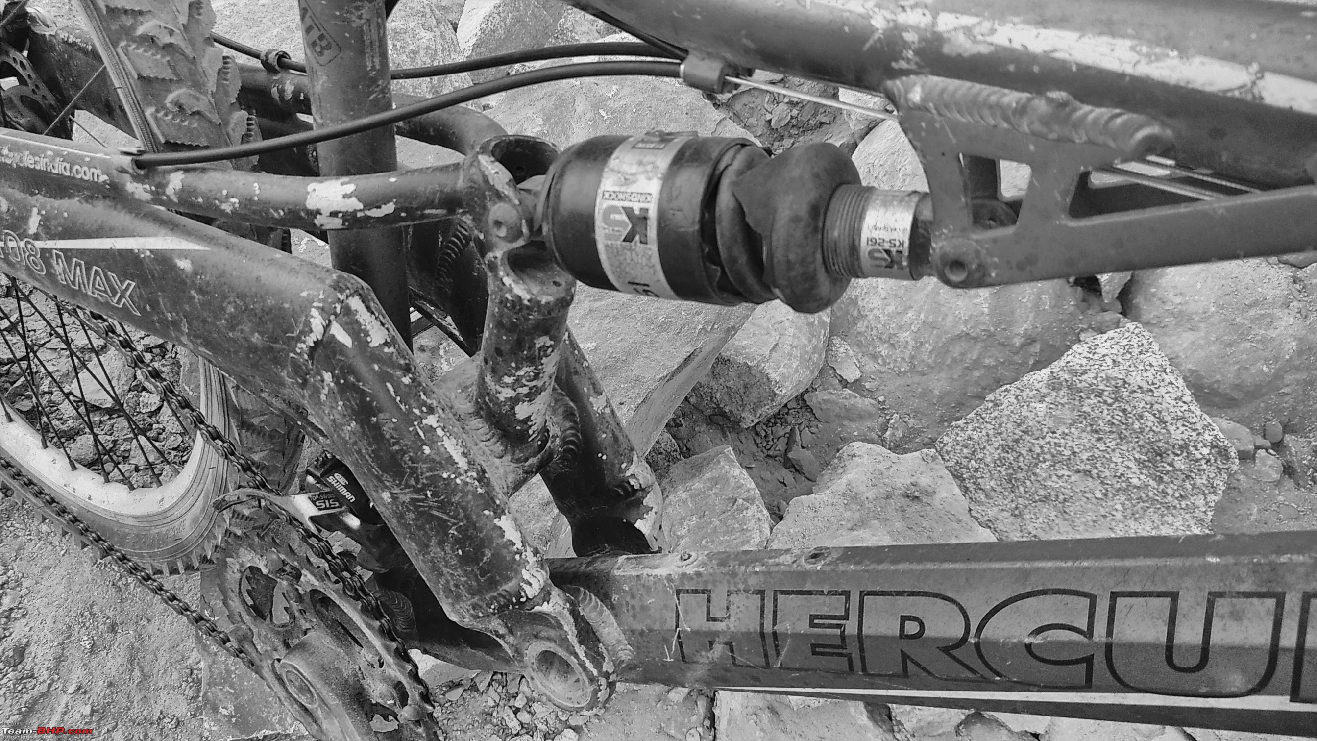

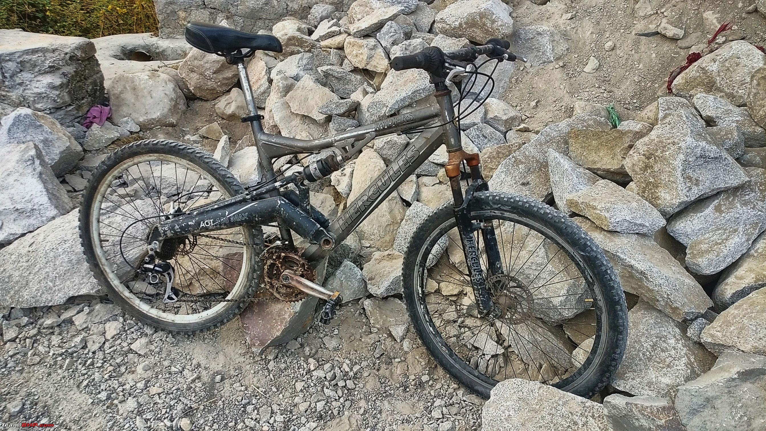

It's a threaded freewheel... I've got one with a much larger 1st gear, even... but 2nd was smaller than on this one, so figured I should wait and see how I end up using it first. we do have some moderately steep gradients on roads here, but not as much as some hill-stations, and I'm not doing trails at this point.

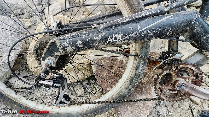

Twister-shifters seem okay for me, I had them on the Firefox prior to fitting the Altus/Acera, and never really had a problem with them. As it turns out, with plastic-clamped alloy levers they weigh within one gram of the run-of-the-mill Shimano integrated shifters. One practical benefit is that the orientation doesn't change between seated/standing positions... just twist 'em, nothing else matters. And as I said, only ONE moving part. Extremely humble and eminently plasticky, but kinda likeable (to me).
Rear brake is a very heavy piece simply marked "MX" and finished in white powdercoat. Will find something lighter in time. Front is apparently the original. Discs themselves are likewise not of the thinner/lighter type, so room for lightening there, too (rear is of smaller diameter than the front, if anyone was wondering...) and then there's that long steel seatpost and rather heavy seat...

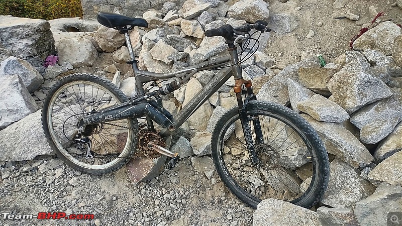

As for suspension, rear shock is a Chinese KS ("Kind Shock"! And it does seem to be showing its kindness to my 50+ year old spine and, eh, seating area... It has a pretty stiff spring and set with a bit of preload, much more taut than the shock on typical desi cycles - so exactly what I want: just something to soften the bigger impacts, not to bounce around and soak up cranking energy.
Fronts loosened up with only some good Würth anti-rust spray (which has a pleasant citrus scent in there btw). They have some fore/aft play but not enough to compromise control, and they don't knock around on full extension/sharp potholes like really cheap ones do. I'm gonna have to open and grease them and see what else they may need.

It all came together surprisingly easy, only snag was that some idiot had forcibly threaded a right-hand pedal into the lefthand crank... took me a long while to get it out, thought at points I might not manage it - but on the positive side, the hack hadn't got it in all the way, so I still had enough of the original threads to hold the proper (left-side!) replacement.
Rides very well considering I've yet to service all the bearings and that the tyres are a pretty aggressive and wide Kenda/Ralson combo. I expect this will be a long-term keeper - deliberately drove it straight through some abrupt/nasty potholes, and it's just stunning to feel none of the bad jarring I've become accustomed to from the other two household bikes.
