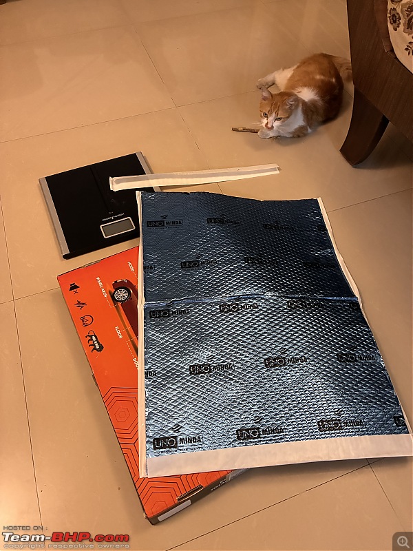

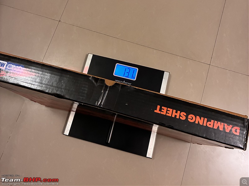

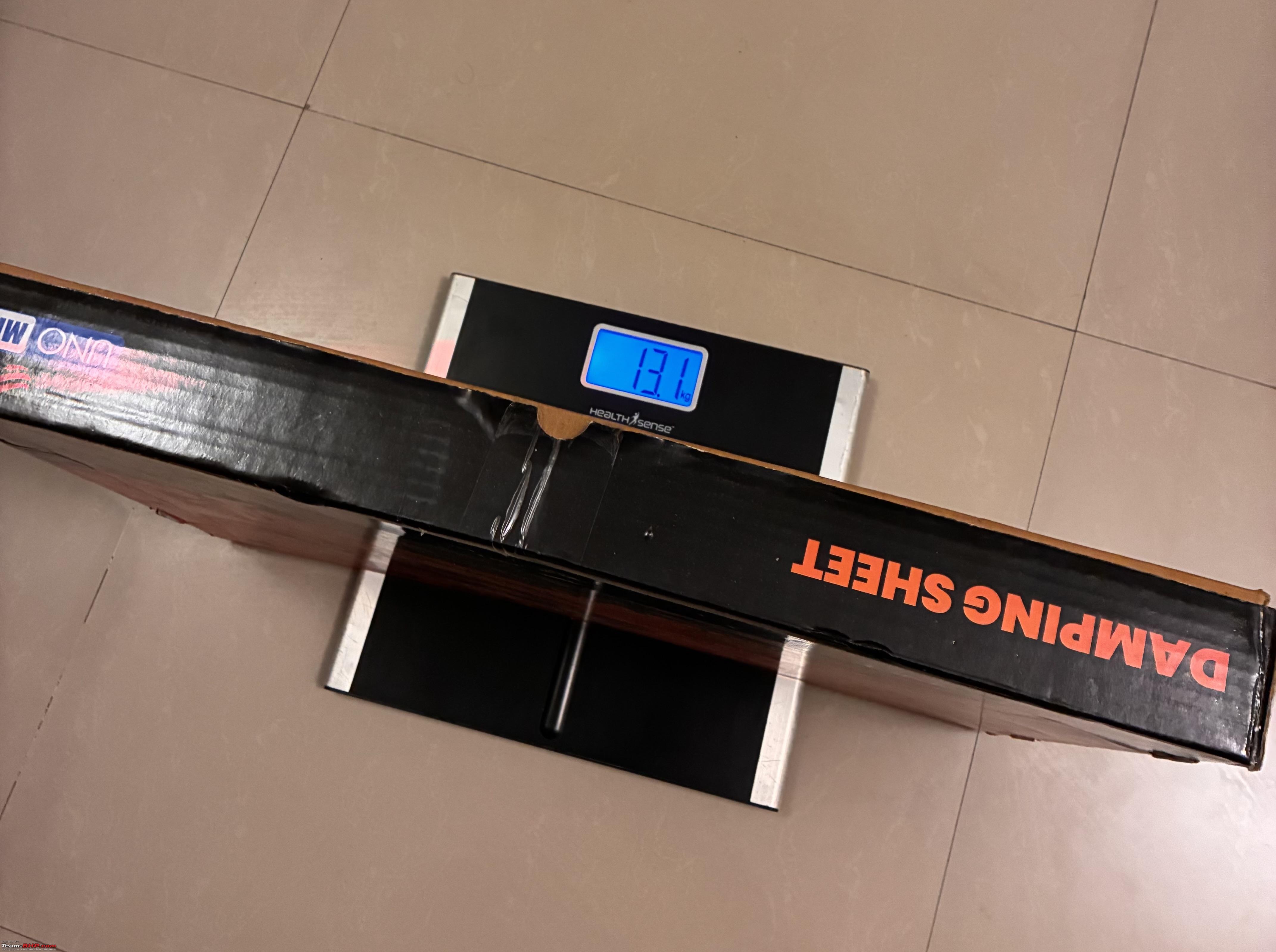

Unboxing the UnoMinda damping sheet box.
So, today I went shopping for these. My DIY project was to install these beneath the SS kitchen sink and see the difference it makes when I drop a spoon in the sink. First I went to few accessories shops who are well known for audio upgrade and dampening work. They showed me the stuff of 2~3 brands but won’t sell them loose. They quoted for the whole job as a package. Some brands had a strong smell of Bitumen (asphalt). Then luckily I found a dealer for Jopasu and UnoMinda; they only sells but do not install, perfect, but they too won’t sell loose sheets so I had to purchased the whole box.
Specifications
* 2.2 mm Butyl compound (completely odourless)
* 10 sheets, each sheet measuring 70 x 50 cms
* Total 42 sq feet.
The Damping Material and Sound Deadener Thread-screenshot-20250412-212307.png
I had a tough time carrying this around
Each sheet has a single fold, unfolded it measures 70 x 50 cms
10 sheets per box. Total 42 sq feet.
I will provide an update as and when I put these beneath my kitchen sink and then on the boot floor of my car
